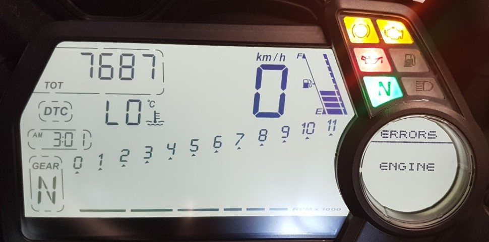

    No other warning just ....[​IMG]
    Took bike out for longer run, error and warning lamp go off after a short time, then re-appear on engine restart.
    Phoned Newcastle dealer today, cant fit me in till next wed just to look at the error code !
    Bike still feels fine ...anyone any ideas ?
    Tempted to buy a MAP sensor and try on both cylinders to see if it clears as seems to be the common fault.

  17. Holy Thread Resurrection Batman .....bumped for future searches in case the similar fault light comes up for others
    2013 1200S Grantourismo 24500 miles
    First time in ownership i have the "ENGINE" warning on the display and the management light on (had the DSS 3 times)....... Looks like the above dash picture but imo feels a little rougher but still pulls well, runs well but maybe a little rich on the over run and going down through the gears fast gives a couple of pops and bangs from the pipe which i havent had before. Run for my daily commute this week so 250 ish miles before i could get it in to be diagnosed
    I doubt its air sensor as still reads the air temp fine so i am guessing a Map sensor ....plug in at Ducati Norwich tomorrow morning to see
  18. Had the same warning on my 13 gt, turned out to be a faulty TPS .
  19. And the winner is ..........front MAP sensor which is now on order at 59 quid plus VAT plus fitting ..... joy
  20. Just to make things interesting while riding home tonight the "Engine Error" light went out .....cue bike running like a heap of shit, wont pull, eventually cuts out completely as i pull into the side of the road. Start up again and idles at 3000 for a few seconds then drops and wont pull away no matter what revs are put in accompanied by irregular pops and bangs
    I eventually recycle the ignition a few times to get the "Error Engine"warning light back on again and it runs smoothly ....wtf!!!
    Waiting on replacement MAP sensor so will need a call to the dealer assuming i make it to work at all depending on how it runs tomorrow
