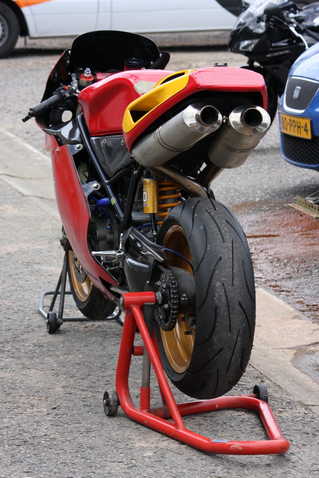

    But first a little bit of the bikes history. I Bought the 996 new back in 1998 when Ducati first announced the 916 was being updated with the introduction of the 996cc lump. Since then i have used it in all weather conditions all year round and done many many track miles split between the uk Belgium and Germany. Many years ago i put sps cams in and it has been faultless over the 18 years of ownership. Obviously she has had minor updates and refreshes along the way.
    Now, back in september i was doing one of many trackdays at Spa Francorchamp.

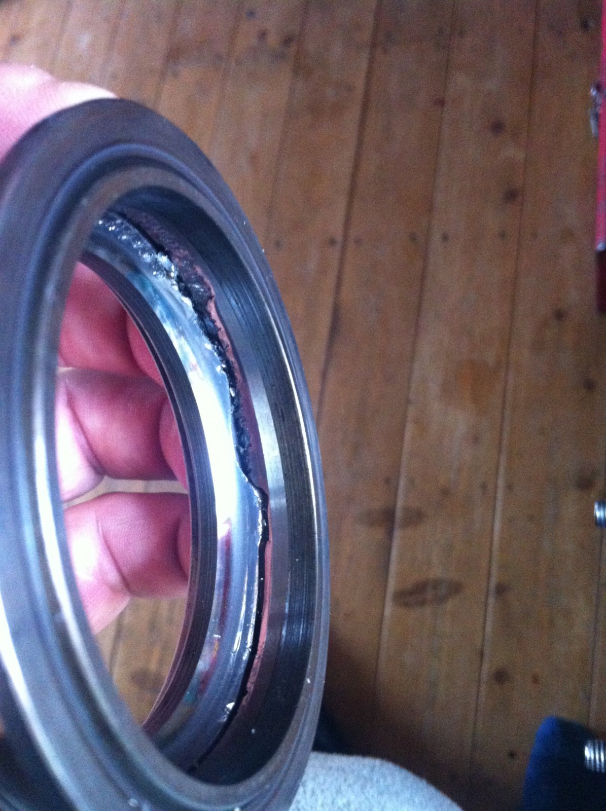

    Towards the end of the day i was running quick into Eau Rouge when all of a sudden there was a significant change in engine note and an ammount of vibration. So clutch in and get the bike to a marshall post. Recovered to the paddock and i was resighned to having to open the engine up over the winter to investigate, hasten to add that within 2 days i had the engine appart and discovered that the left side main bearing had failed. The outer race had effectively split into two halfs. Never have i seen this before but prior to the failure the motor was running sweet and strong.

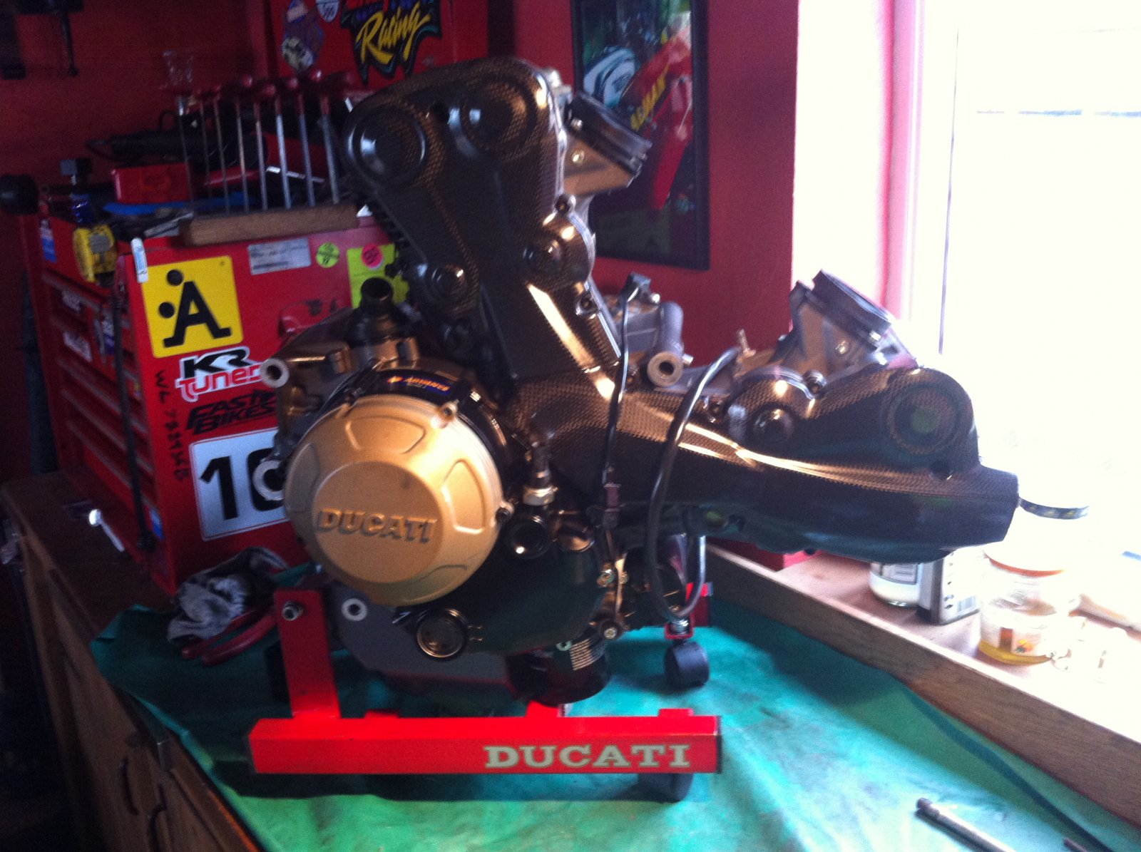

    So for a laugh i decided to go on line and price up the cost of refreshing all that needed doing while the engine is apart with new Ducati sourced parts (yes i know i could get 2nd hand parts or a complete motor, but this was just an exercise). The bottom line i got to without replacing all the other gearbox bearings and a new crankshaft was a mind boggling £7500. Anyway scoured the web for 2nd hand parts and or a used motor complete and then thought why not look to go the route of many before me and put a newer motor in.
    So onto the forums and look for an engine. Then i come up with the thread started by Chizel that he was having to sell his 1098 engine that he had bought with the view to to a conversion at some point. Made contact with him and arranged to there and then buy the motor. Not totally happy about kicking a man while he is down and taking his future project but he needed the money and i needed the engine. Hope the busted foot is doing ok Chizel?
    Living mainly in Germany i arranged to collect the engine when i was next in the uk and bring it back to Germany and get started on the project.

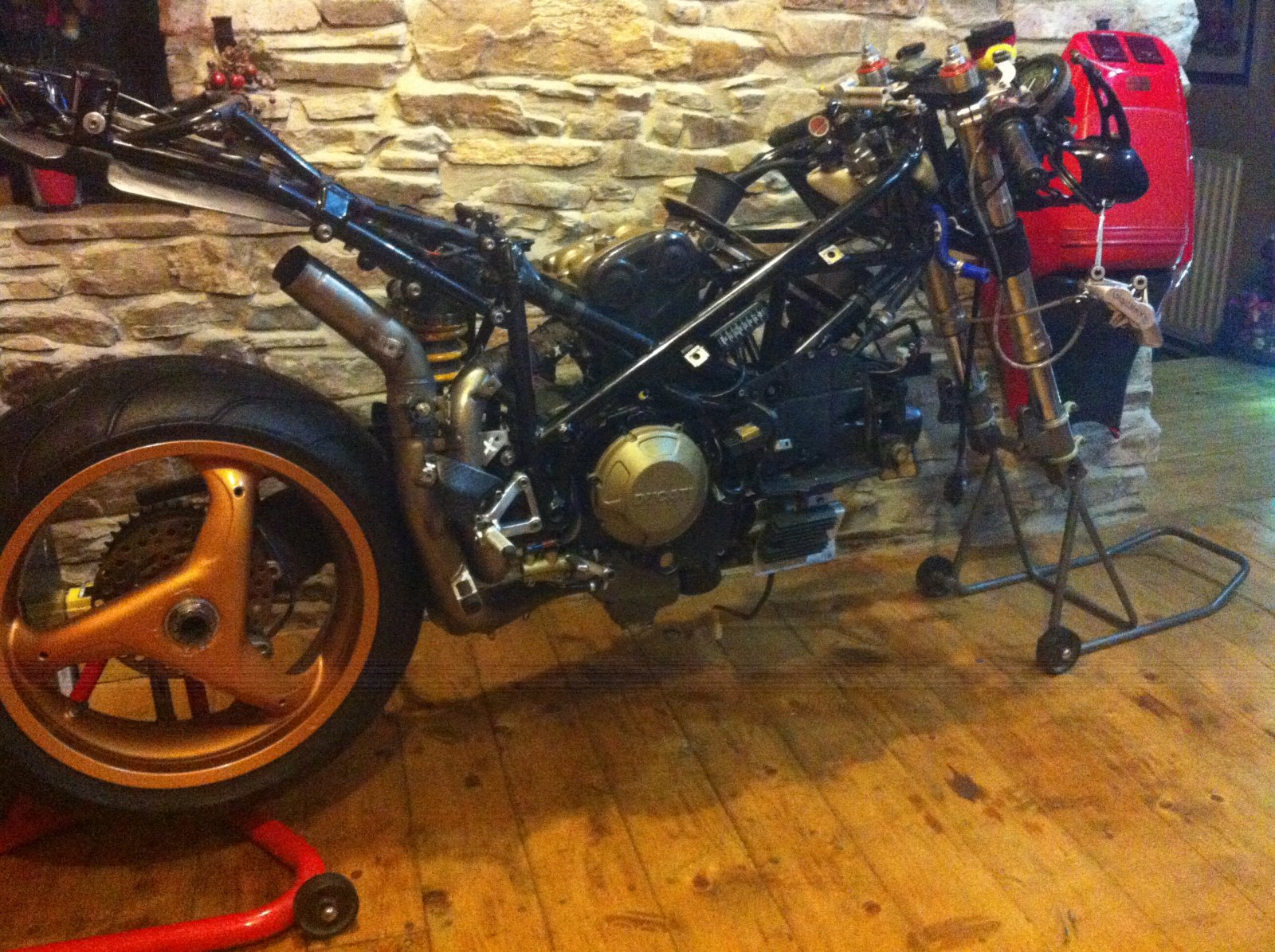

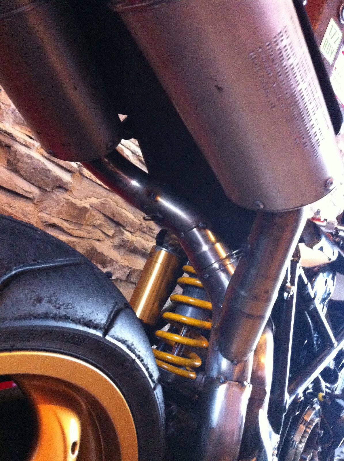

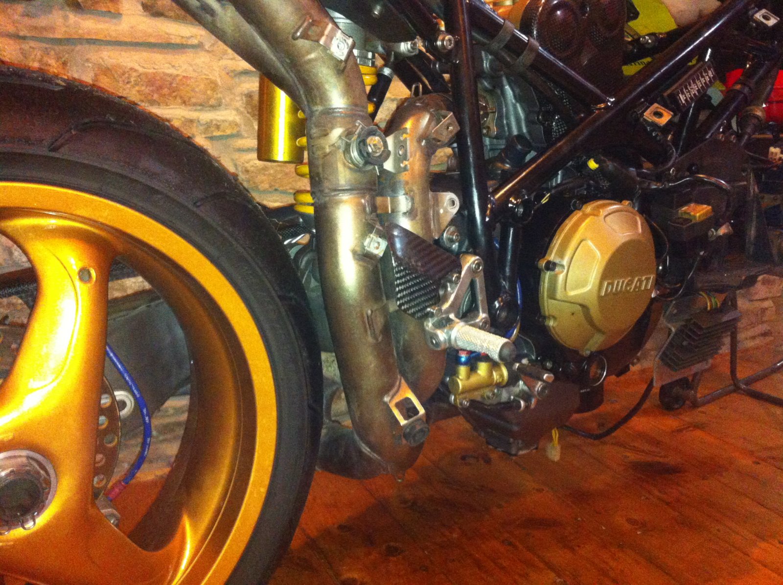

    To date the motor is in and i am now looking to get everything sorted and in place to make a start on the airbox and exhaust system. I have got a 1098 exhaust system that will be cut and shut where needed to do the job. Fortunately i live and work at the nurburgring and have some helpfull friends in good places, so my friendly Ohlins technician is chomping to get busy with his TIG welder on the pipework. So sure he will make a better job than i would with my history of pigeon sh1t welding.

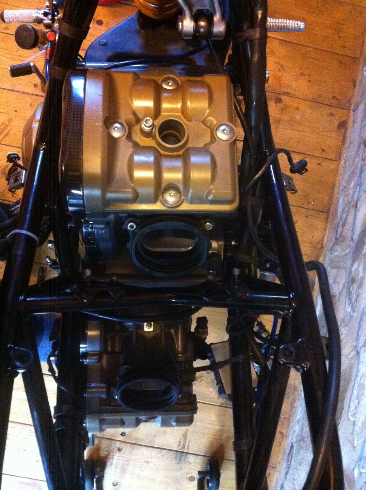

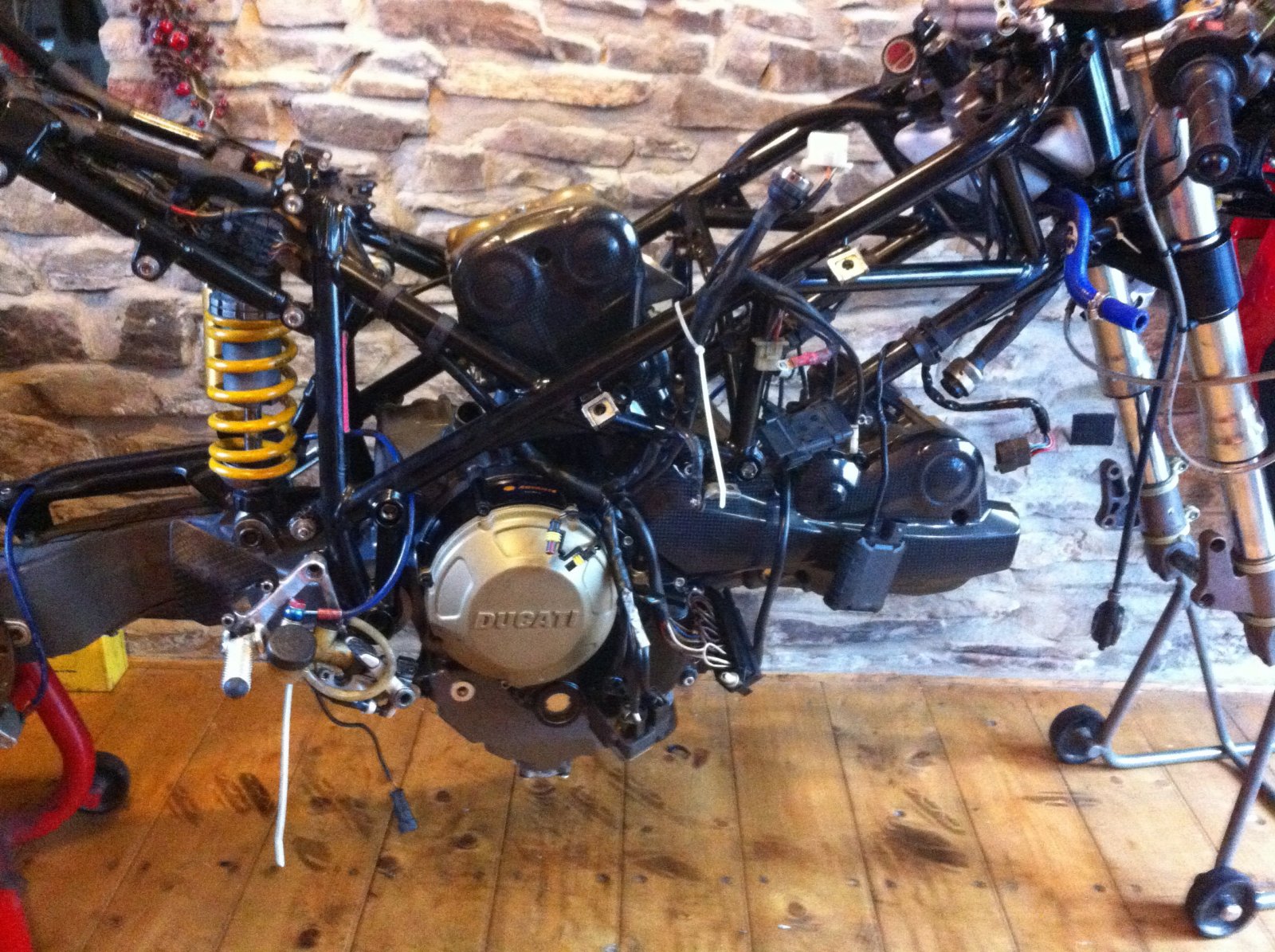

    Hopefully i can post pics to this thread and along the way i may ask for some advice or parts that i still need. If anyone can help with either as i go it would be appreciated.

  4. Thanks guys. Only did a small bit of de-lugging the pipework today. My mate is waiting for a new pedal for his tig to arrive then hopefully get the exhaust sorted.

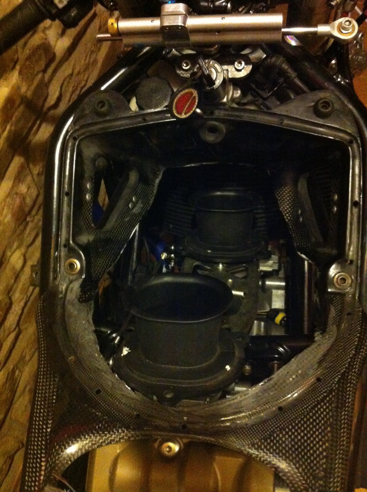

    Also need to get some resin for the airbox, which will be a mix of glass and carbon fibre mat.

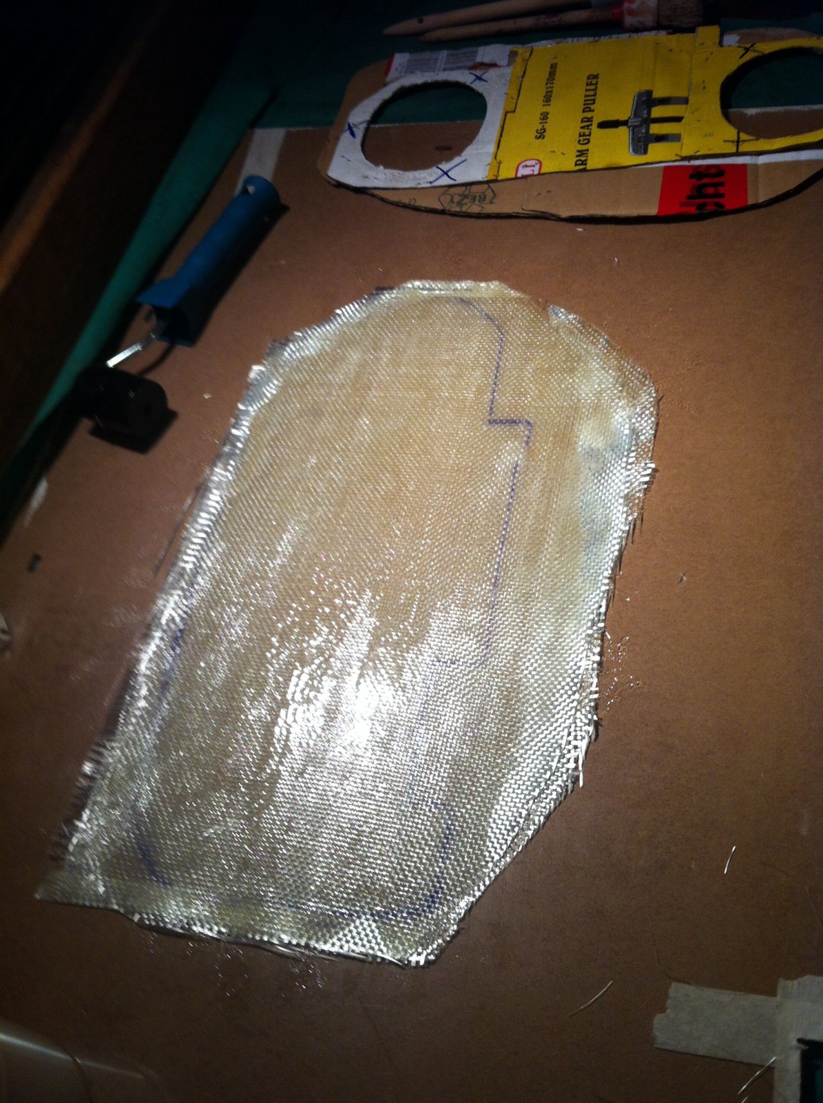

  6. Got busy cutting and shutting the various pieces of pipework i have for the exhaust. All now tack welded waiting to be tig'd. Just need to get some stainless wire for the springs and get the tig'd in place at the same tine. image.jpg Also laid up some glass for the airbox base.

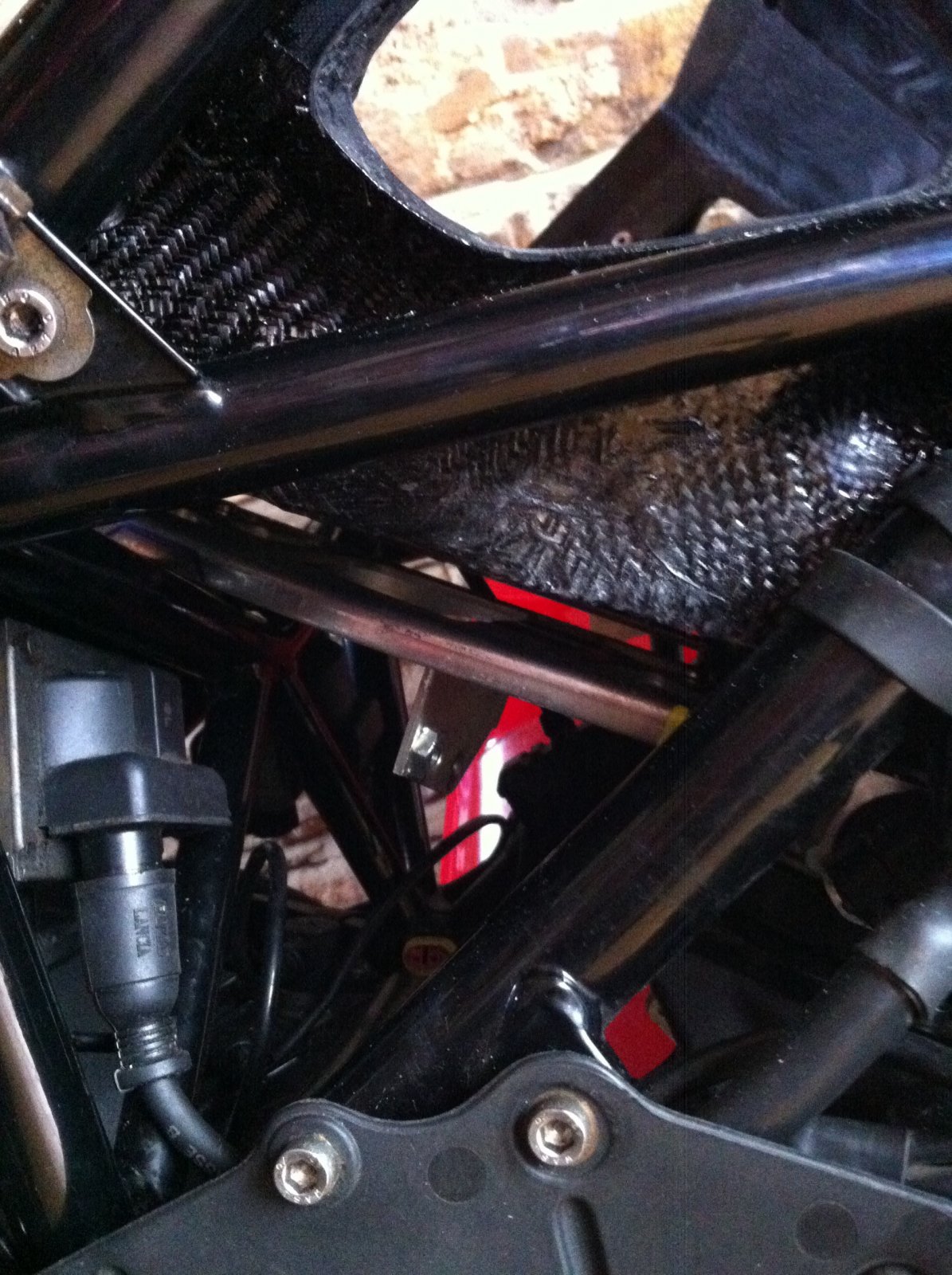

  11. Work on the airbox is progessing slowly. I've never done much work with glass fibre let alone carbon fibre. Blimey it's a messy job, and how much of a struggle it is with carbon. Must be a better way but sort of pleased how it's progressing, fortunately it's no show bike. image.jpg A sneek peek of in progress.

  15. I wish some clever fellow would mold and produce an airbox.
  16. I have a chip from Hypersport Tom in Sweden, also there is a good dyno place that has been recomended out gere if final stuff needs dialling in.
  17. There was Lameshafts one stateside, but he dissapeared i think. Anyway where would the fun be in just buying one. LOL
    • Disagree Disagree x 1
  18. yea or ebay it and recoup a couple of quid. What was the process with the air box? Make a glass mold first then lay the carbon in it?
    played around with fiberglass a bit and your right, it messy as fvk!
  19. yeah -shame that.
  20. Had an old cf box off 996, but new base is sort of hybrid of the cf and gf.
