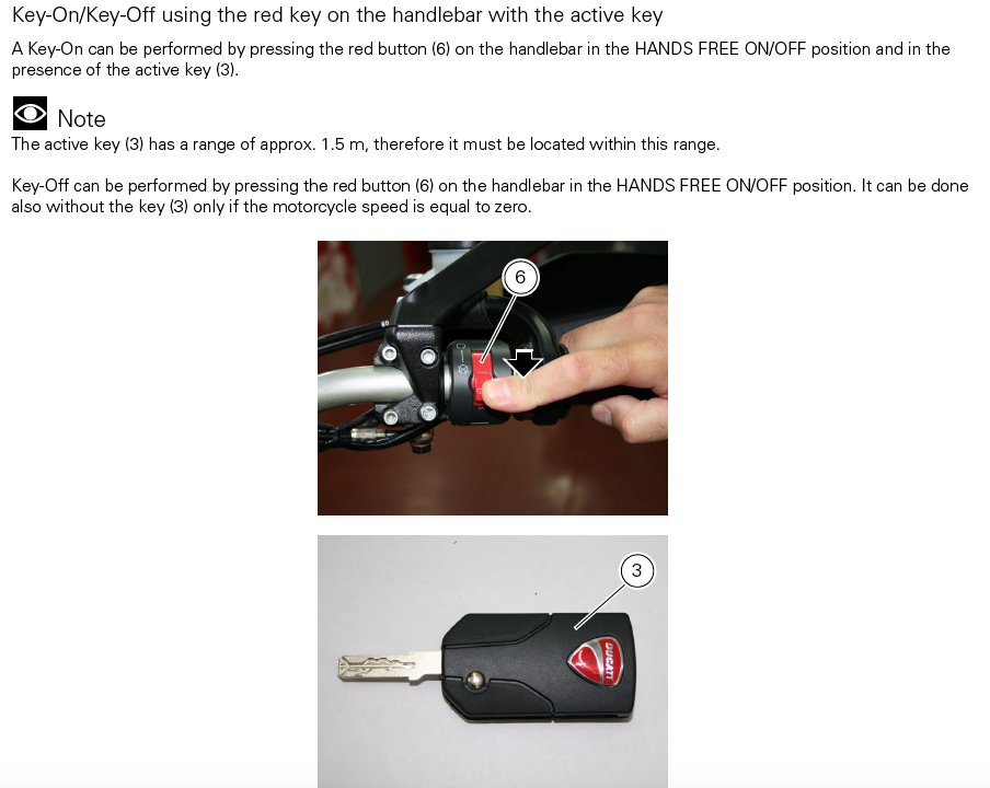

  6. From the workshop manual...
    Mine definitely works at more than a metre
  7. In practice I find that when the black active key fob has a flat battery, trying to use it as a passive key does not work very well at all. The red passive key works a lot better.
