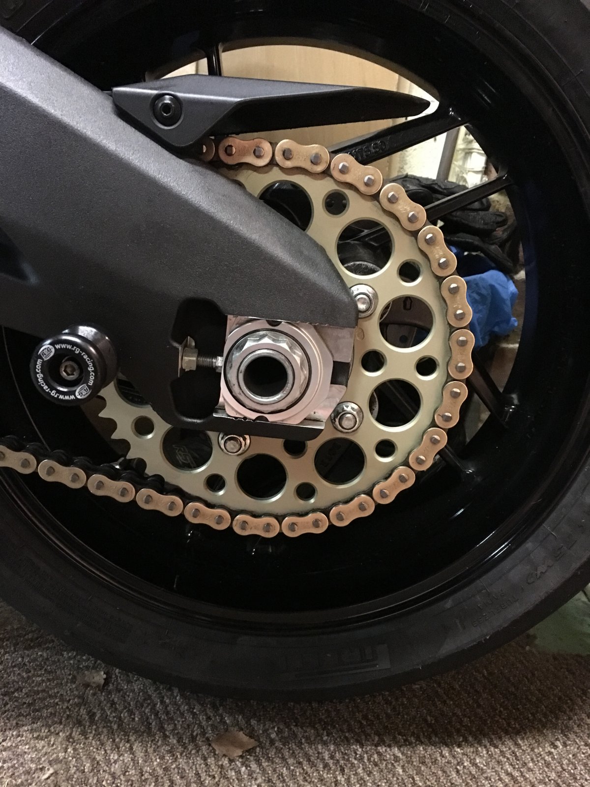

    Need a new chain and sprocket. Thinking of a supersprox rear sprocket. Fancy a gold chain.
    Any advise on what chain and sprocket to buy. Also what's the opinion on rear sprocket teeth?

  9. We use DID or RK chains, SuperSprox are the best of both worlds as you get a hard wearing steel teeth ring with a lightweight aluminium carrier (as said above).
    Renthal alloy sprockets will be ligher than the Supersprox but if you get a lot of abrasive dust/grit and it wears away the top coating they won't last as long.
    Front sprockets are all steel, even Renthal (due to spinning aprox 3 times as far as the rear).
    Imho DID are the best chains you can buy.
