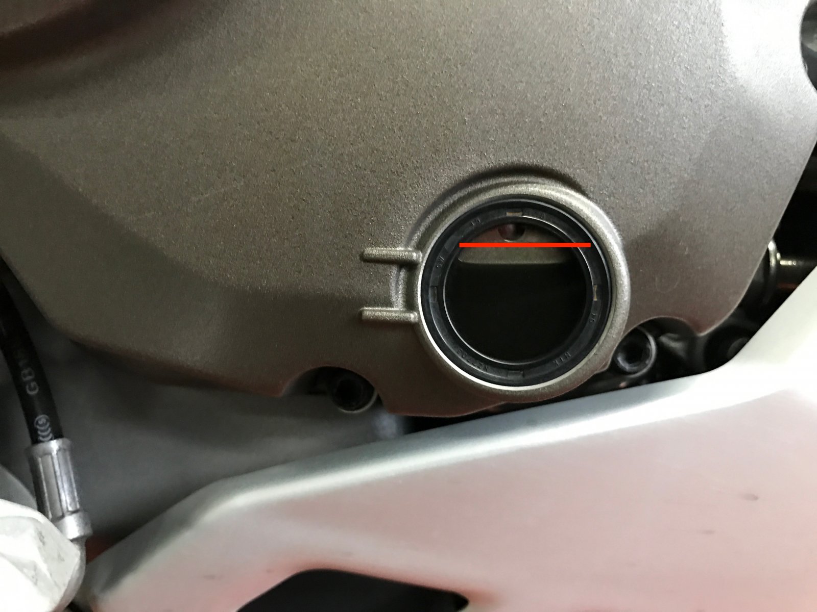

  10. I have passed the annual revision the previous week, and I have loaded the new update, it shows with the most linear acceleration, but it fights more when you release the accelerator in retentions. I have also checked the actual oil consumption by accurately measuring what I empty and have been 250 centiliters, which in 7000 km in all conditions and types of roads I do not seem excessive
