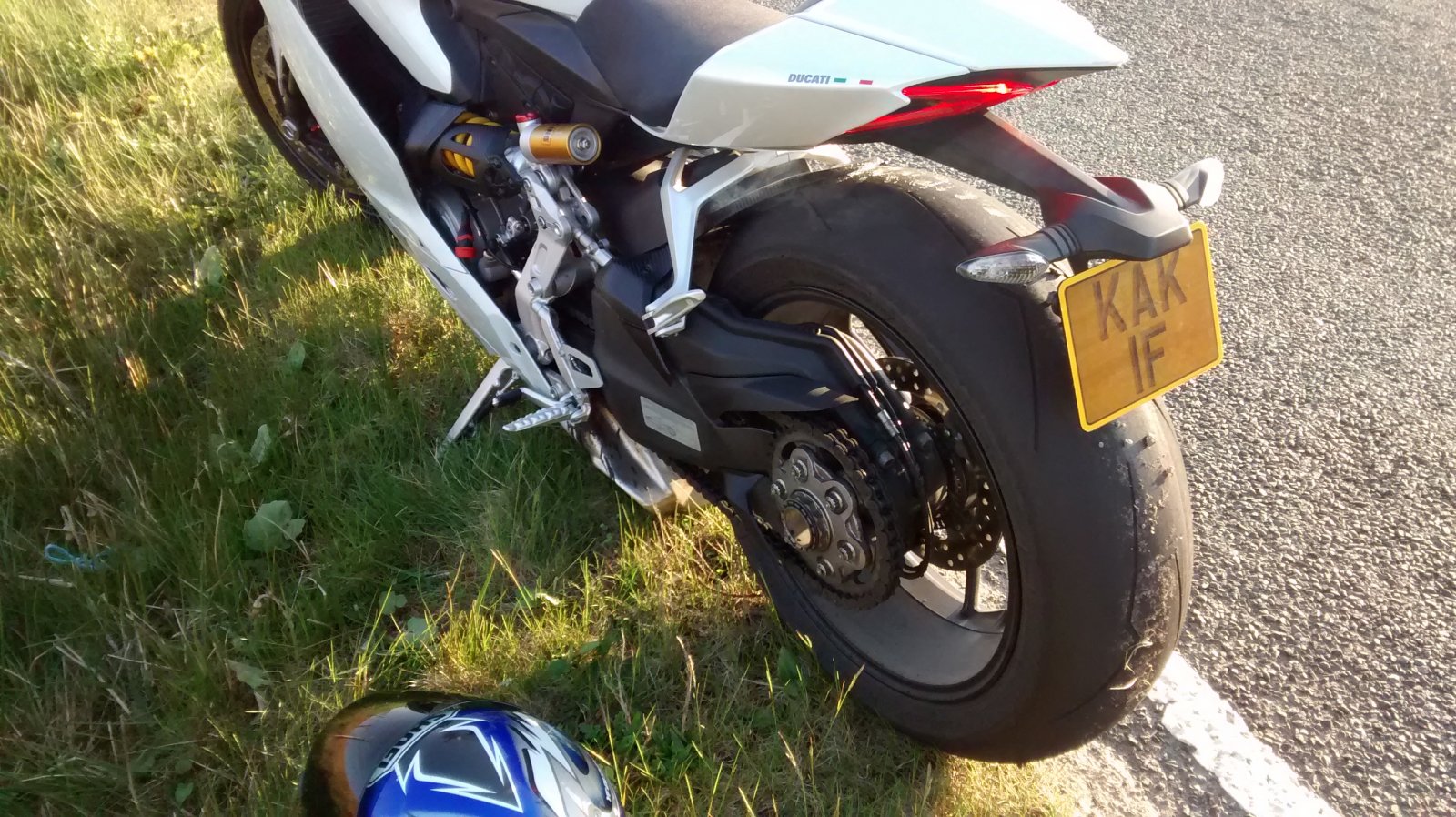

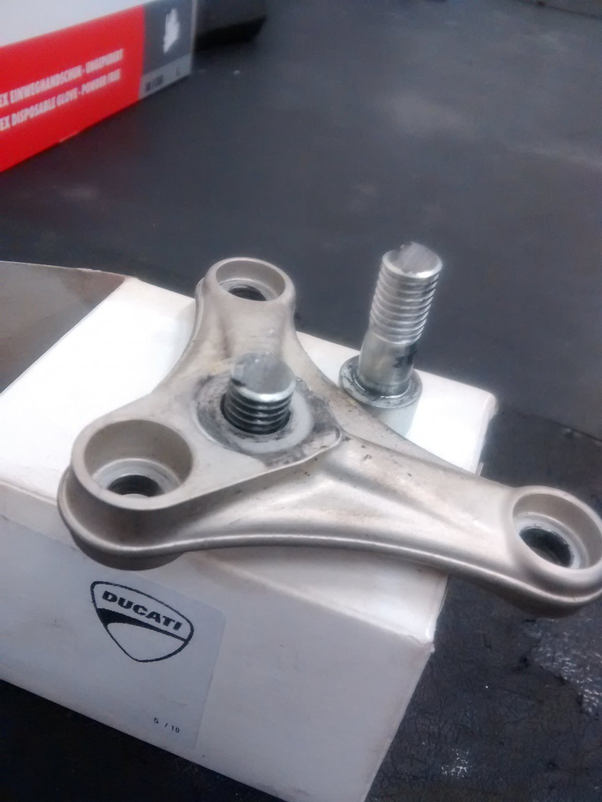

  1. IMG_20160516_193401416.jpg IMG_20160516_201241064.jpg Hi,I'm in LEEDS. New member
    Got myself an 1199 2013 MY in February 2016

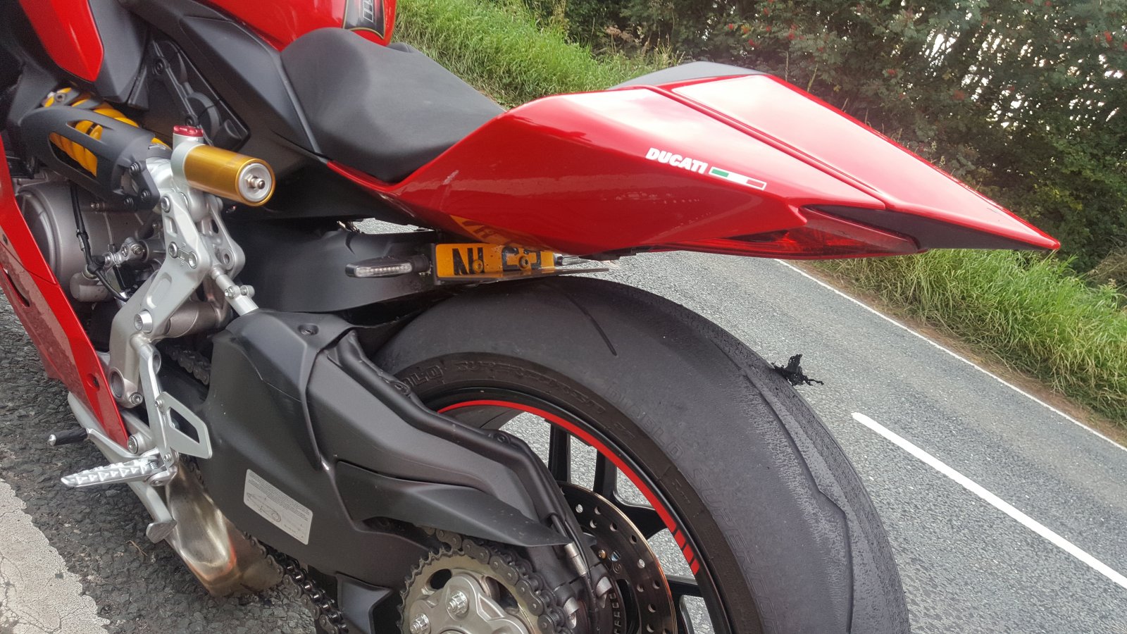

    Story is, a few weeks ago, rear shock front bolt broke! Managed to pull up OK.
    Rear Footrests saved me from biinning the bike as left side landed on swingarm supporting rear end just above rear tyre! FB_IMG_1470288963370.jpg View attachment 73933
    Any one else had or heard of similar problem?
    Ducati are thinking it's been over torqued by previous owner!?Nonsense I say.I reckon the bolt cannot take the impact without an additional bracket,
    Sato Racing make a support bracket that Duke should consider retro fitting under recall.
    I am a BMW MOTORRAD TECHNICIAN btw.This isn't something BMW would have taken lightly.
    Any help getting this raised to a possible Recall/ High Priority Inspection status would be appreciated.
    Regards Ian.

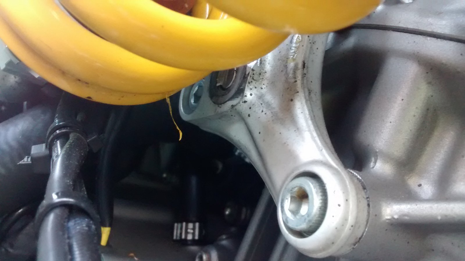

  9. Do you still have the bolt?
    Was there evidence of it bending?
    Did it fail just above the end Of the thread?
    Any pictures of the offending item?

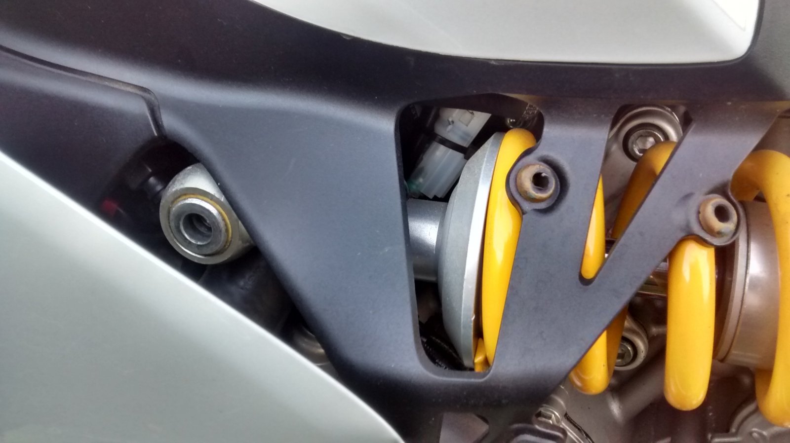

  10. Yes see attached photo,sheared level with bracket.
    Instant drop of suspension, **0mph too!
  11. Ooh that's bad.
    Surprised that the bolt is still straight and not bent where it goes into the bracket.
    Looks like it may be a fatigue failure rather than single overload as there appears to be a smooth section and then a grainy bit where it finally let go.
    I would definitely have words with Ducati about that. Send the pics to Italy.

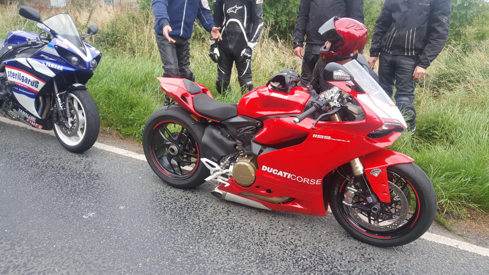

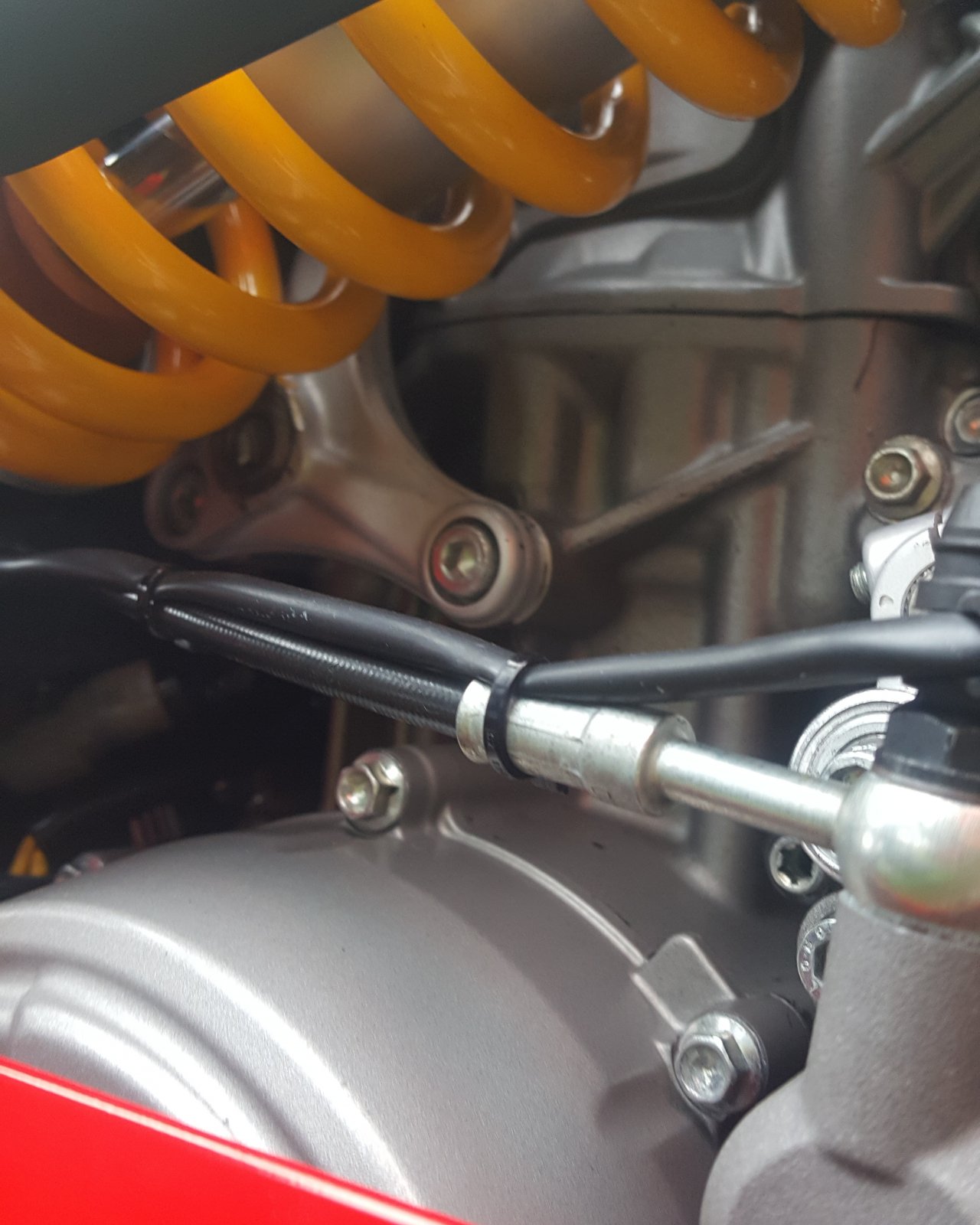

  13. I'm having exactly the same problem, 2013 63 plate 1199, was riding last weds night, suspension just dropped, front shock bolt snapped, looks like this could be a problem on all!! Mines just gone back to dealer today, I await there call
  14. Are both of these bikes 2013 bikes?
  15. Yeah would seem.so, both 2013
  16. Hmm, interesting, doesn't need a lot more 2013 bikes for it to happen before the assumption would start pointing towards a bad batch of metal for bolts or time fatigue
  17. Here's mine, collapsed. When riding, luckily in a straight line!!!
