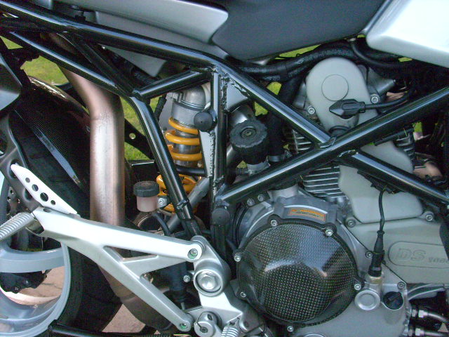

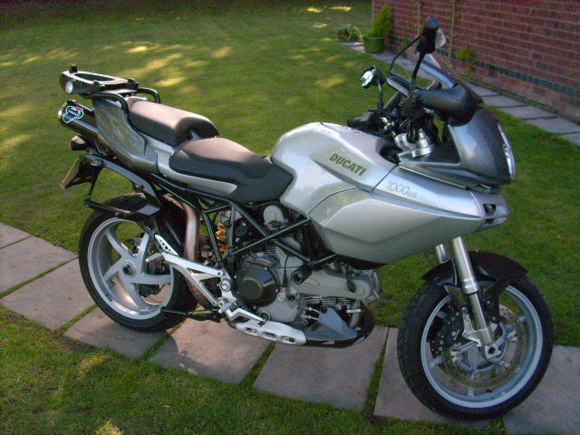

  8. My bike
  9. Adjuster knob centre of picture

  17. There'll be somewhere close to you that'll do the business. I'm a fat kid and I found the spring rate a bit too soft on my 1000DS sometimes, so I can understand it struggling with 2 on board. You've wound up the preload (via the big knob) to maximum, so perhaps you should have a play with the damping before you start shelling out money...
    Download the manual from carlsalter.com , pay attention to page 41, with particular interest in rear suspension compression damping, and turn that adjuster clockwise until the rear end firms up a bit. It's not a perfect solution, but it'll help.
