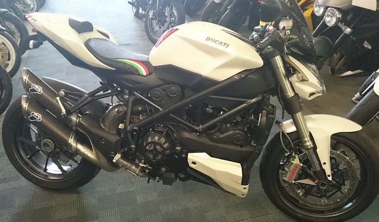

  12. It exists....but im workn overseas so even i wont see it for a few weeks.
