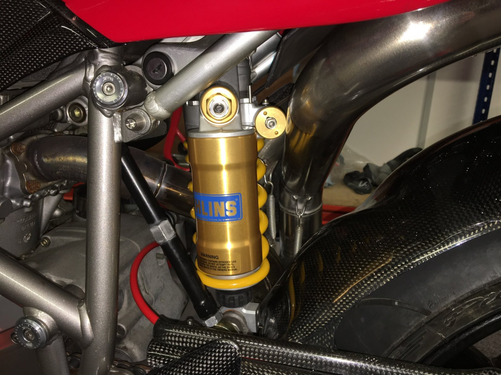

    Fitted this to the bike this evening. All seems ok but the preload resovoir seems to be too close (almost touching) the exhaust. Part of the problem is that I re drilled the exhaust hanger to get the end cans closer to the seat unit at the back. But even if I lowered them a bit, I think that part of the shock would still touch. Thinking that I might have to put a small dent into the pipe...
    Anyone offer some advice before poor @Tobytyke has to waste another evening? :)

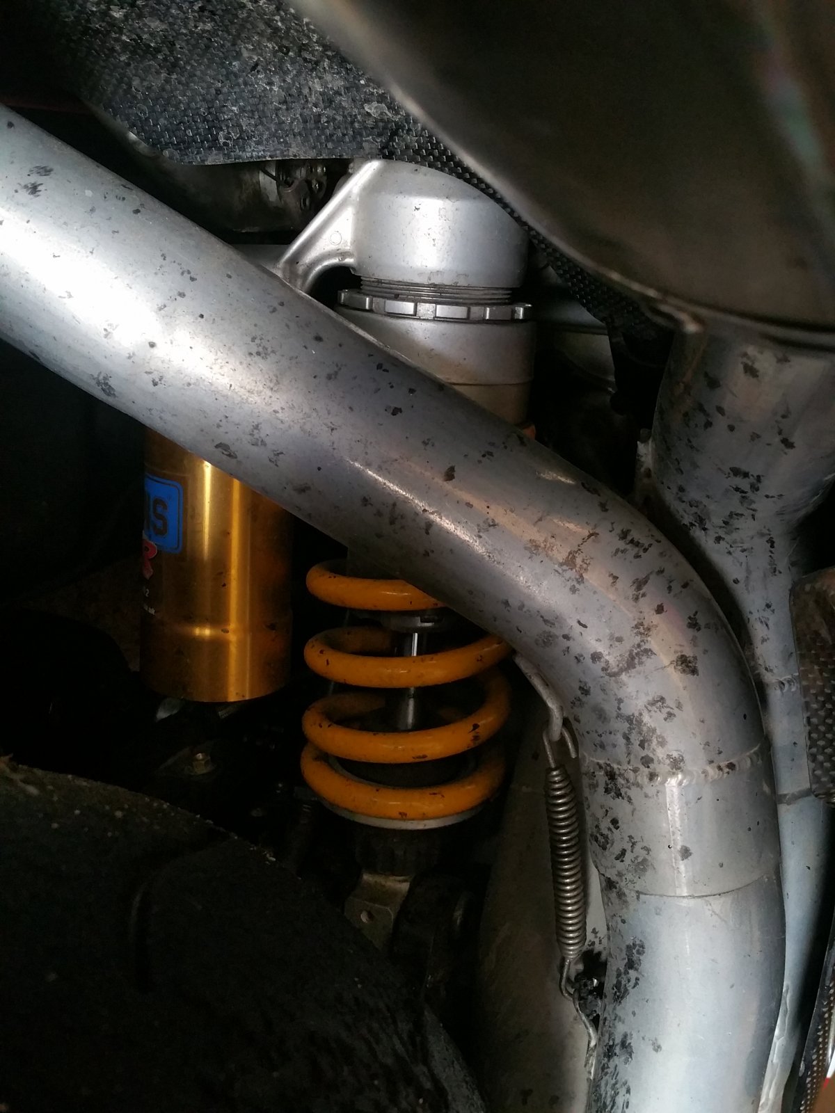

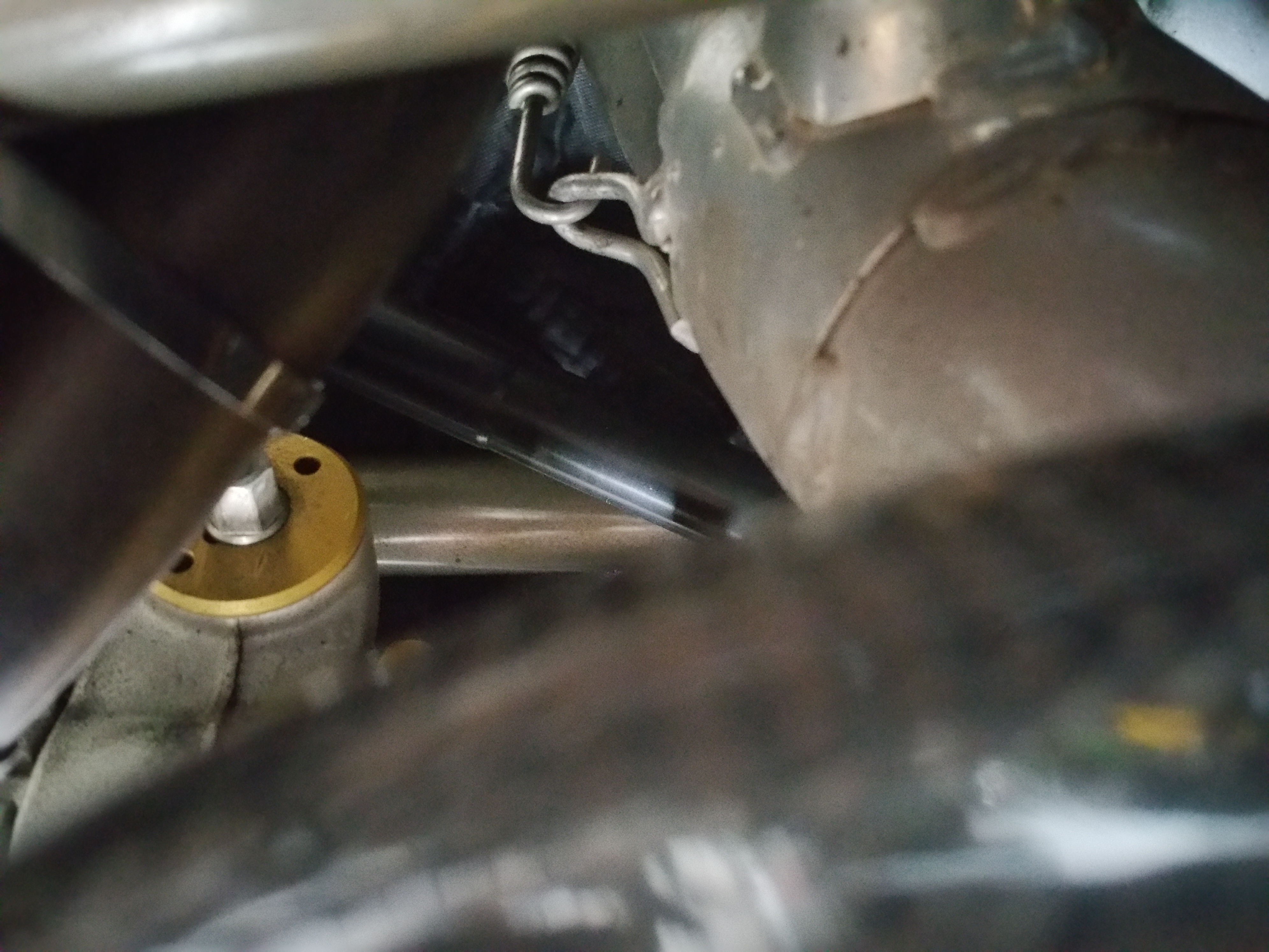

  7. Had a similar issue with the 54mm system on my 853. Solution was to compress the spring to release the remote pre load adjuster and turn it through 180 degrees. I'll try and get a picture tomorrow. Andy

  11. Not particularly brilliant photos but hopefully gives you the idea. Andy

  13. Thanks Andy, so you twisted the preload through 180 degrees so the adjuster is pointing towards the back of the link pipe?
    Cheers
  14. I didn't but that was what was done on advice from Wilf when it went in for a service. Works fine although access is a little fiddly because of my crankcase breather pipe that goes to a tank under the seat. Not sure if they took the shock off and did it on the bench which would make sense. Happy to ask if you need. Andy

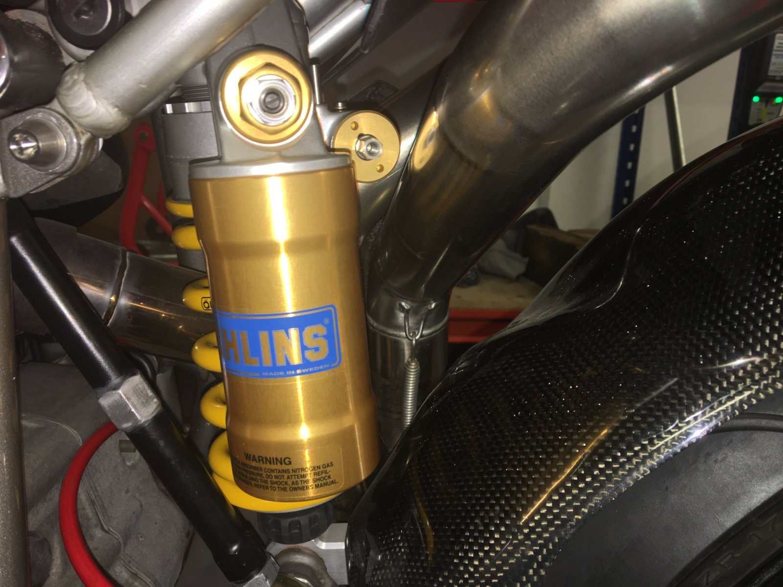

  15. Right then. After altering the height of the end cans, ended up with about 5mm clearance. Went out for a short run and the shock didn't seam to get too hot.
    Might not need to reposition the preload res?
