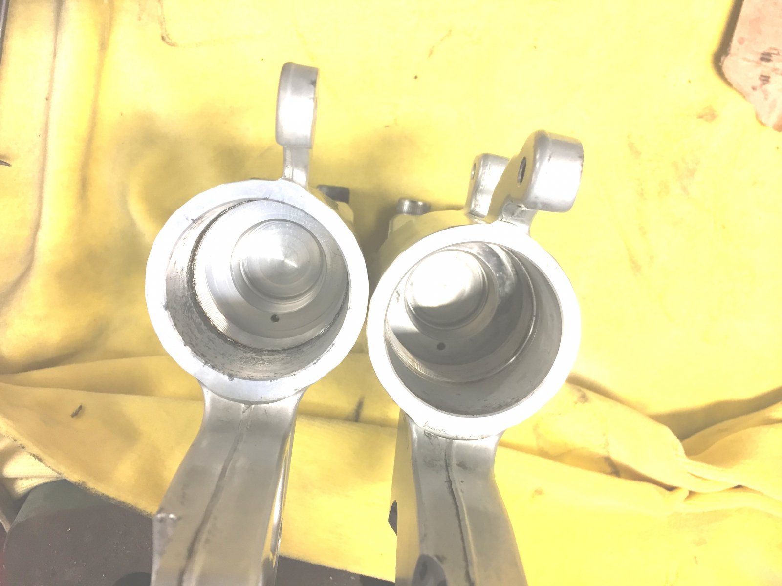

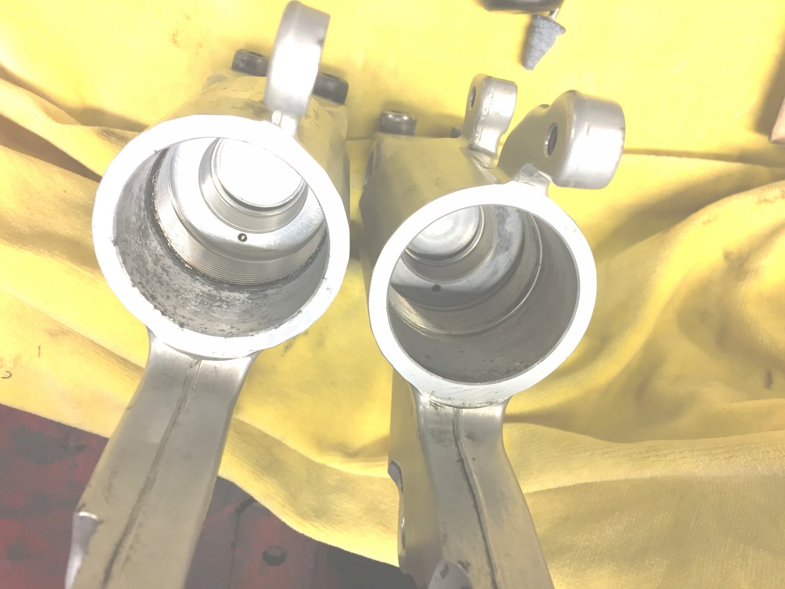

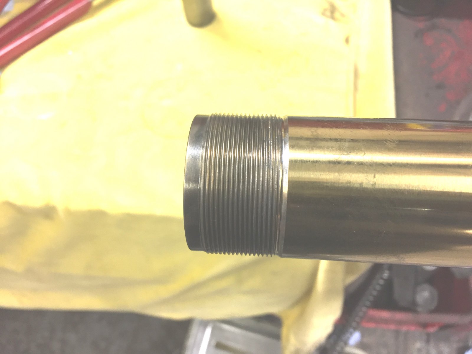

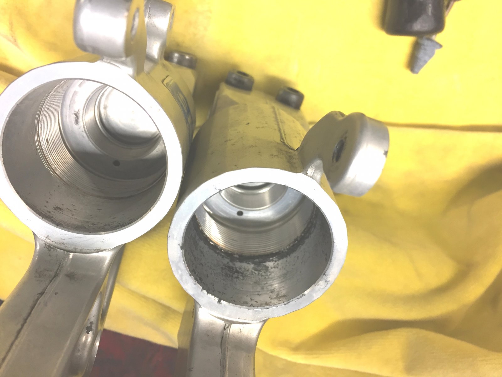

  19. Just to let everyone know, I have just removed the feet from a pair of 2003/2004 999 Ohlins (FG8910) and fitted a pair of feet from a 2001 998S Ohlins (FG8500) . The dimensions of the internals, threads etc are identical. They swapped no problem. Good luck.
  20. Pictures of feet attached.
