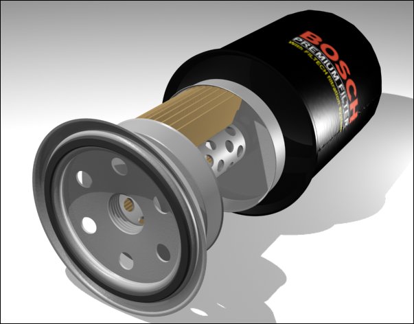

  2. They are a pressed construction so I guess it could spin - never had one do that though. If you have been undoing for 15mins it must be I guess!
    Here's an exploded view of a filter.

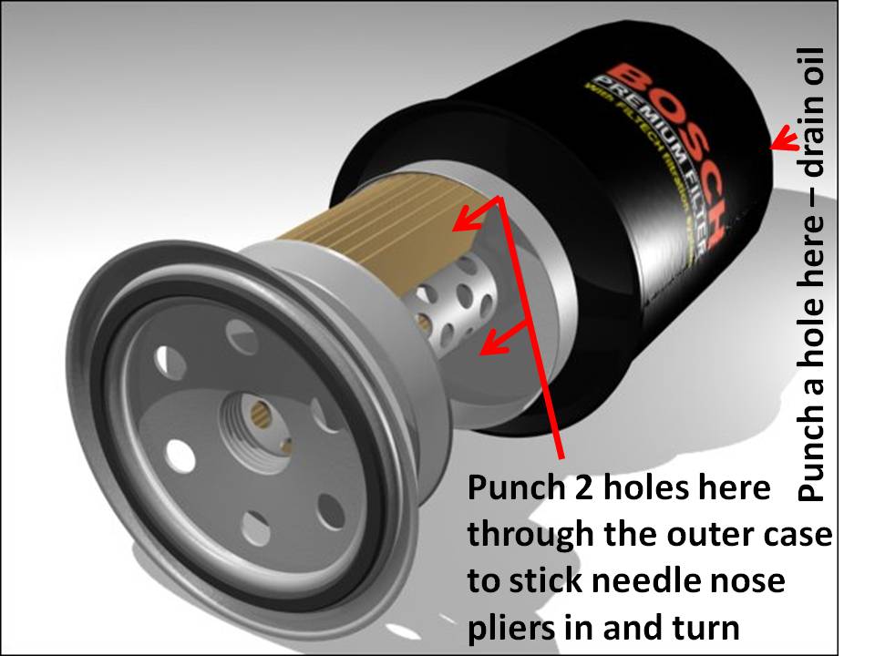

  8. Or puncture through the outer case and through the plate:

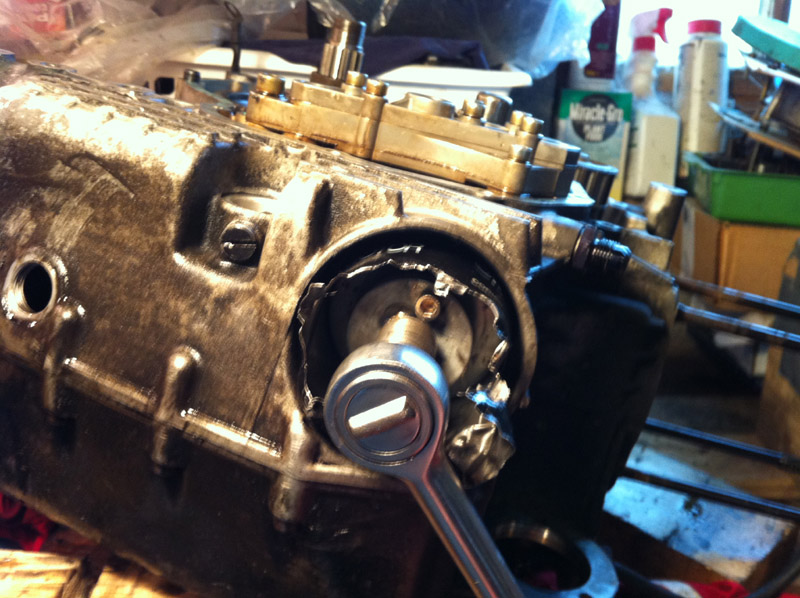

  9. As per Arquebus' post, get into the filter base.
    The filter on my Monster engine was so tight when I first got it that it ripped when I tried the screwdriver through the casing trick.

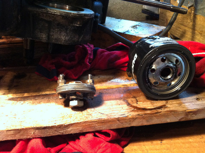

    I ripped the filter apart and made a tool to fit into the base, in the same way as needle pliers might, except it is heavier duty and I can get some leverage on it;
    Made from a few bolts, nuts & washers.

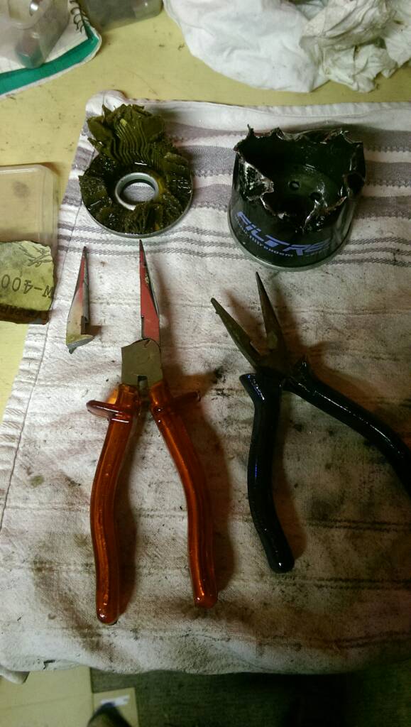

  10. And that kids, is why we don't buy cheap are oil filters and over tighten the!
    Thanks as always guys.
    Ps, need some new pliers!
