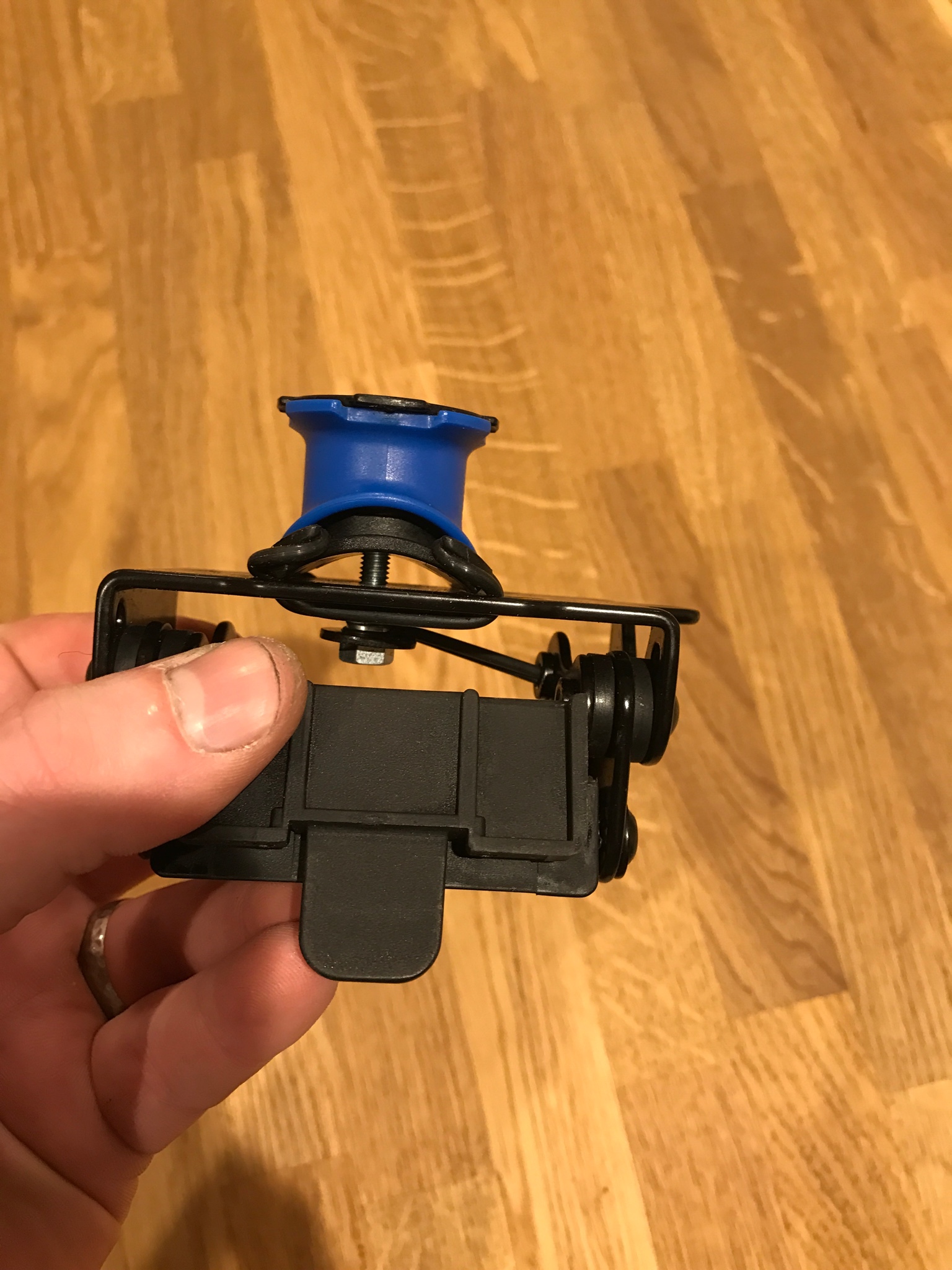

    I purchased the below 'bar' type mount on the assumption I could take it apart and mount it onto my flat GPS back plate. I was right and you can just fit a longer bolt right through the thing. Also got the same mount in the car for ease. Case sits on the phone very nicely and isn't bulky.

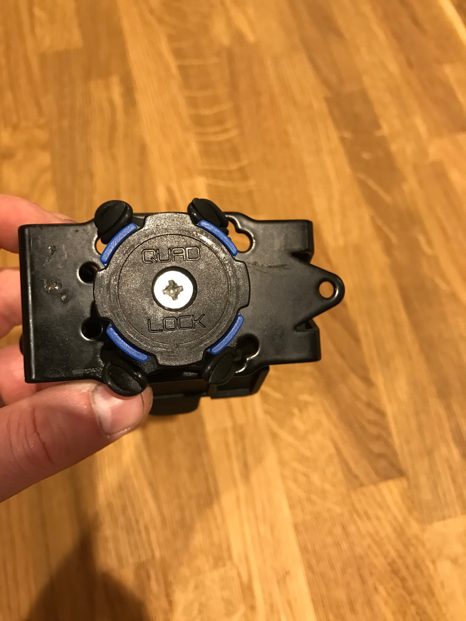

  17. Interesting. Considered the Quadlock many times, but dismissed it on the grounds it'd bulk the phone out too much, and the concave mount was no good for the flat-surfaced Navihalter.
    Any pics of what you've done to get it to fit?
  18. I was very surprised how little bulk the receptacle adds to the back of the phone. It hides the bulk very well.
    Anyway, here's the quad lock. Just replaced the oem bolt with a longer one that negates the concave bit at the back. [​IMG][​IMG]
