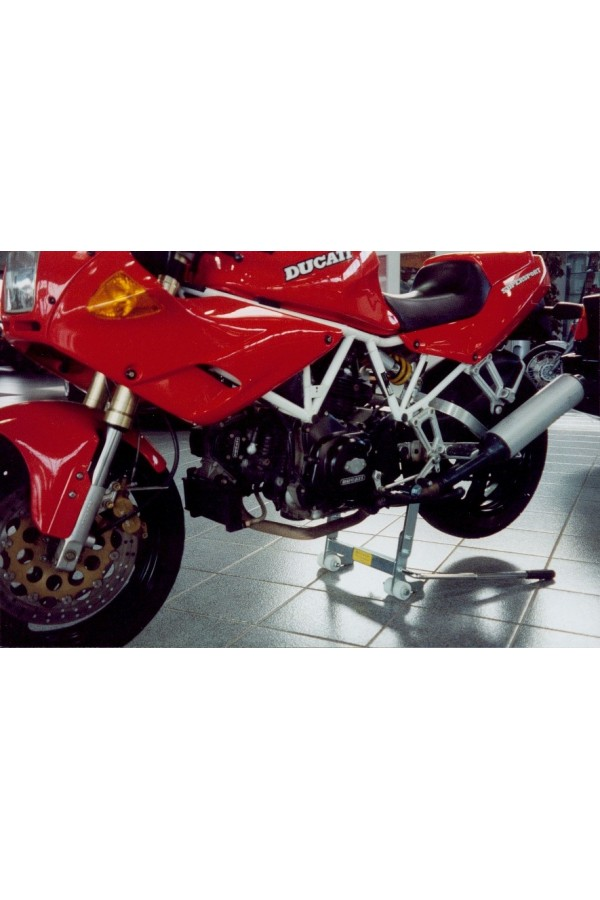

    I was at the National Motorcycle Museum and saw this picture which got me thinking about building a nice narrow bench, and using a support like the one here:
    I wonder if anyone has a lead on a support like the one in the picture, that slots into the swingarm bearing, or the frame mount?

  8. Plus with the abba stand, theres an optional fitting which raises the front instead of the back
  9. does anyone have pictures or video of abba stand in operation on a 900ss?
  10. Can't say I have seen one but if you check out their website and YouTube you'll find a number of videos showing how it works. Also the folk at Abba stands are super helpful.

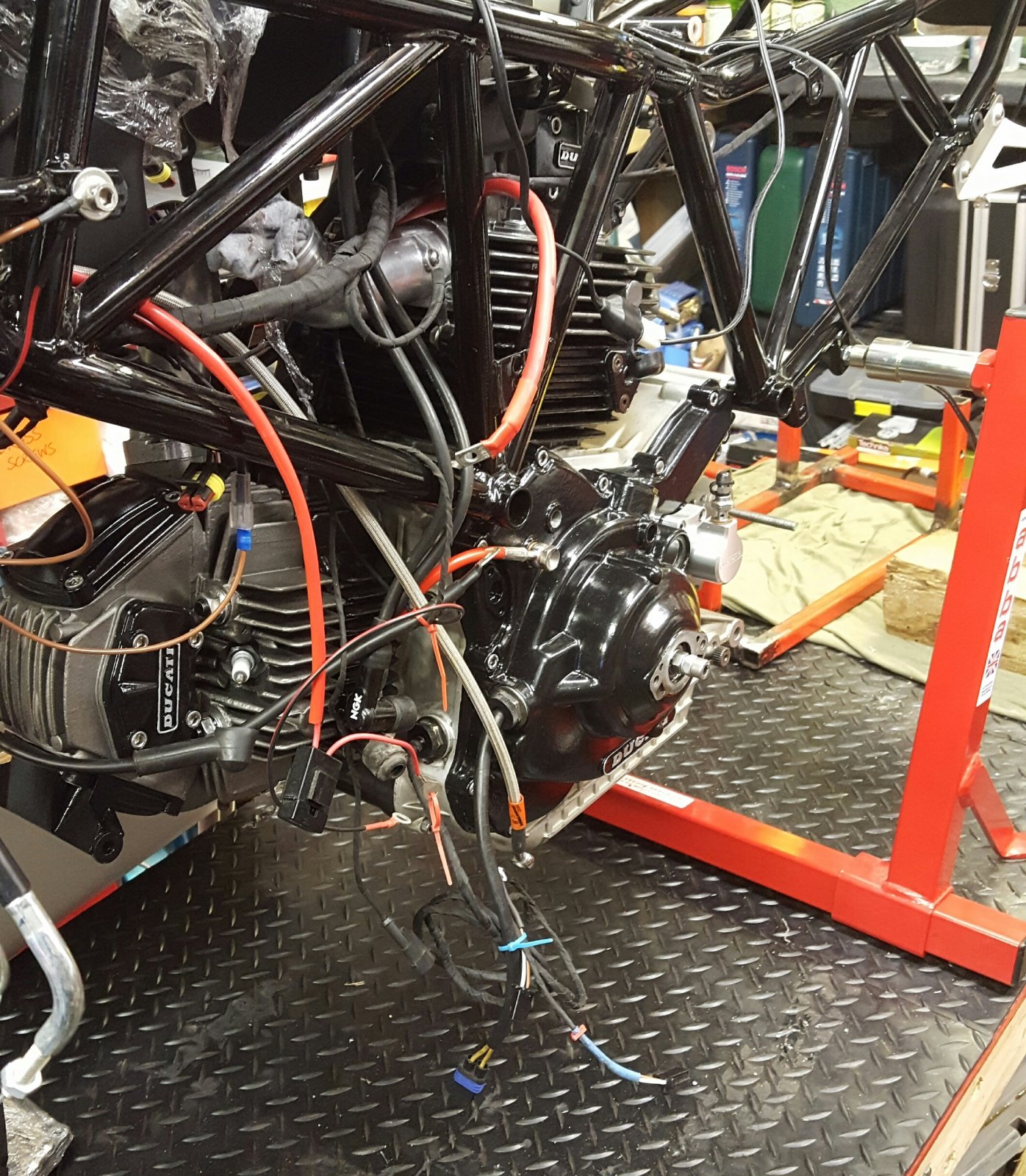

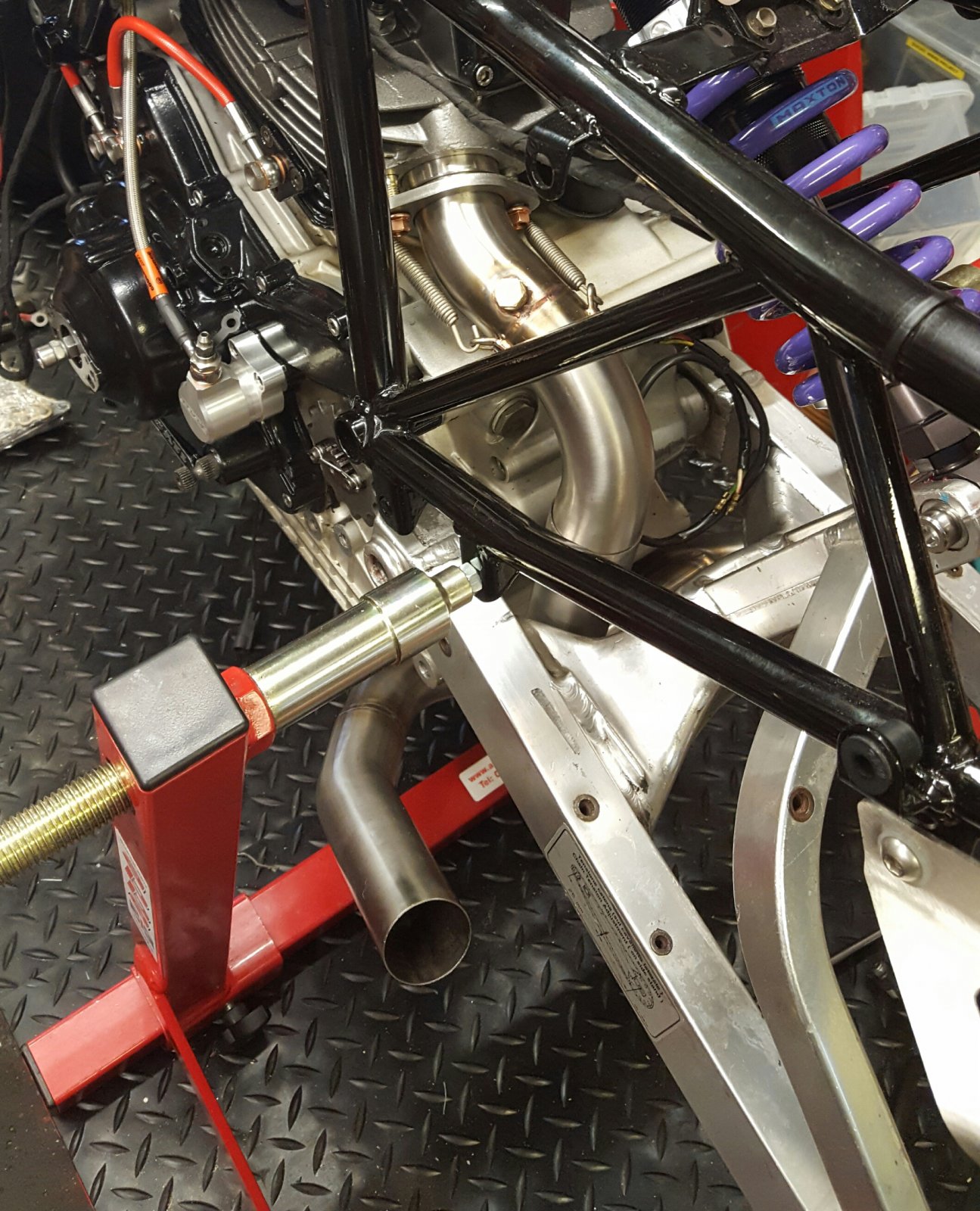

  12. It doesnt lift both on the SS you can do one or the other but need the extra attachment. Check this....my build using Abba stand. You can get attachments to go though footrest hangers as shown. This allowed me to then put on the swingarm and back wheel. Sorry not got better pics. Its so easy to lift too with extendable lever, wouldnt go without it now. 20160718_205510.jpg 20160718_205255.jpg
  13. Downside with abba is you cannot get at swingarm if its in those holes. As above, if putting on a bench (and doing on the cheap because its not often) I'd spin the pegs so they dont fold up (or fit fixed rearsets) and use axle stands and a front paddock stand. Ideally and under the headstock one that can mean you can take the forks out
  14. It's interesting to see how that ABBA "swinging arm removal" kit works, with the mounting onto the pillion footrest points - I got that kit bundled with my stand but have never used it. The standard 900SS mounting kit does use the swinging arm pivot points and it works fine too. Once up on the stand, to lift the front end to remove forks an alternative to jacking is to use ratchet straps from garage ceiling down to frame top tubes at headstock.
  15. Look at my pics, its through the footrest hangers using that kit. I used ratchet straps off roof to lift up rear to get engine in.

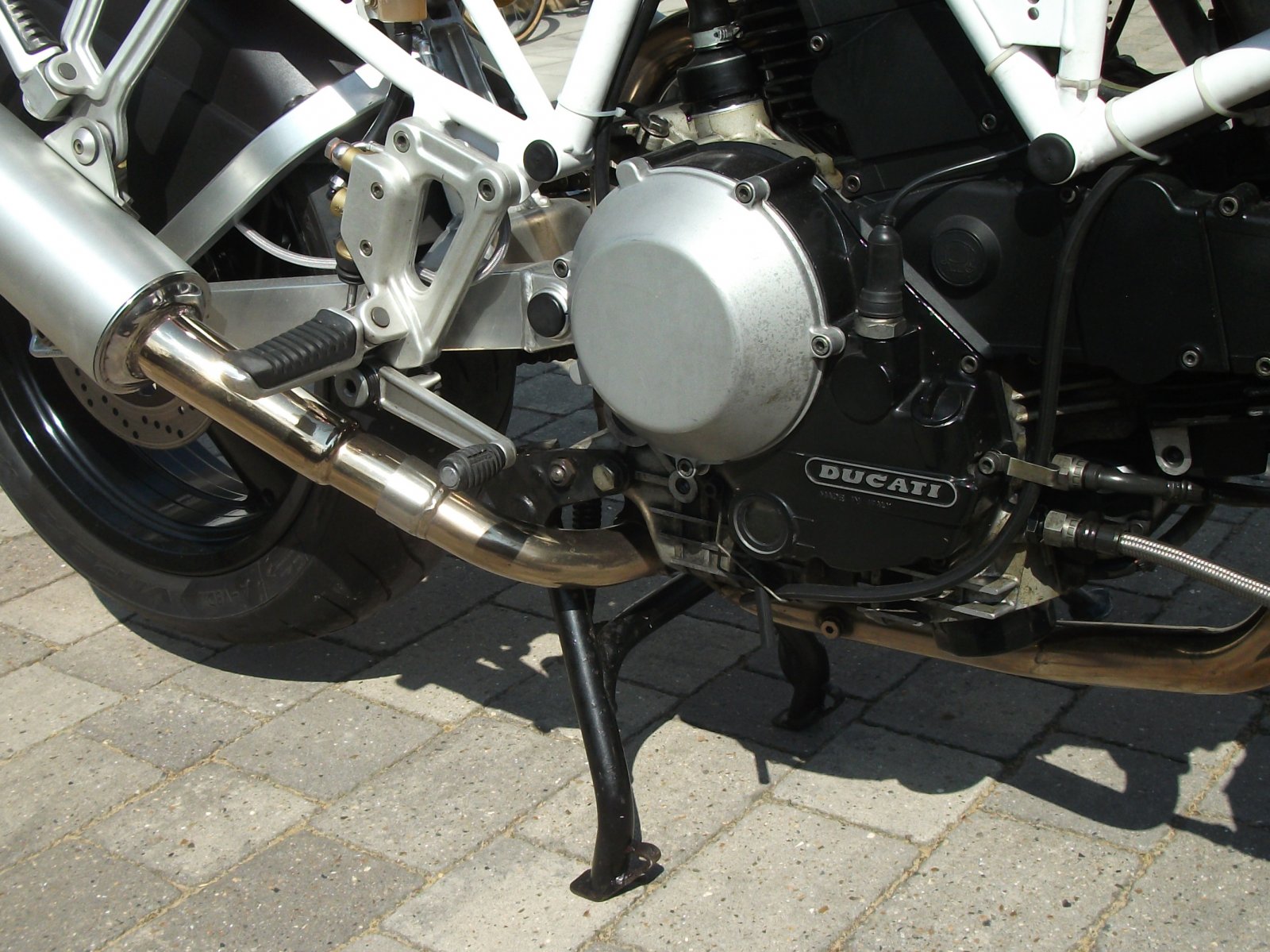

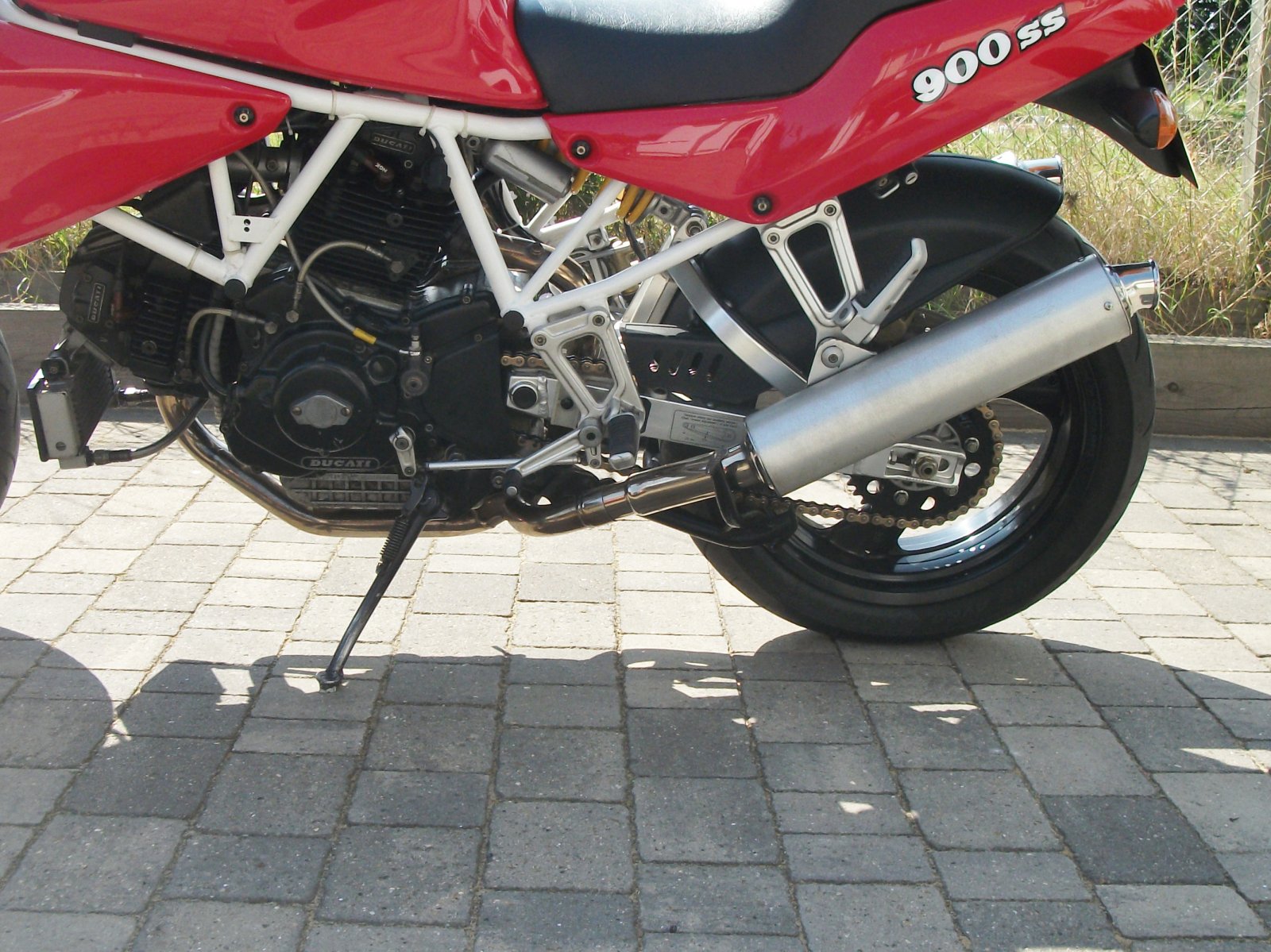

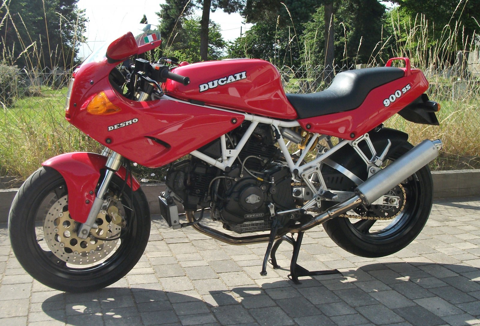

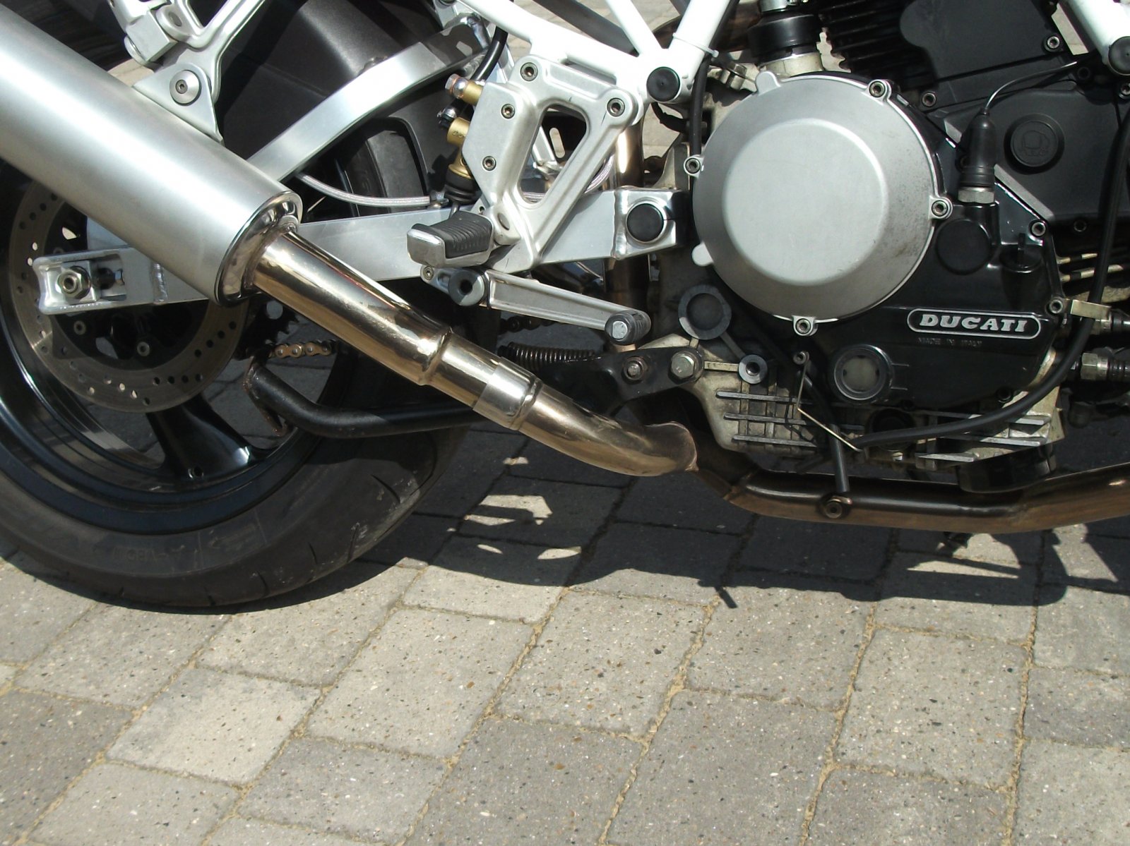

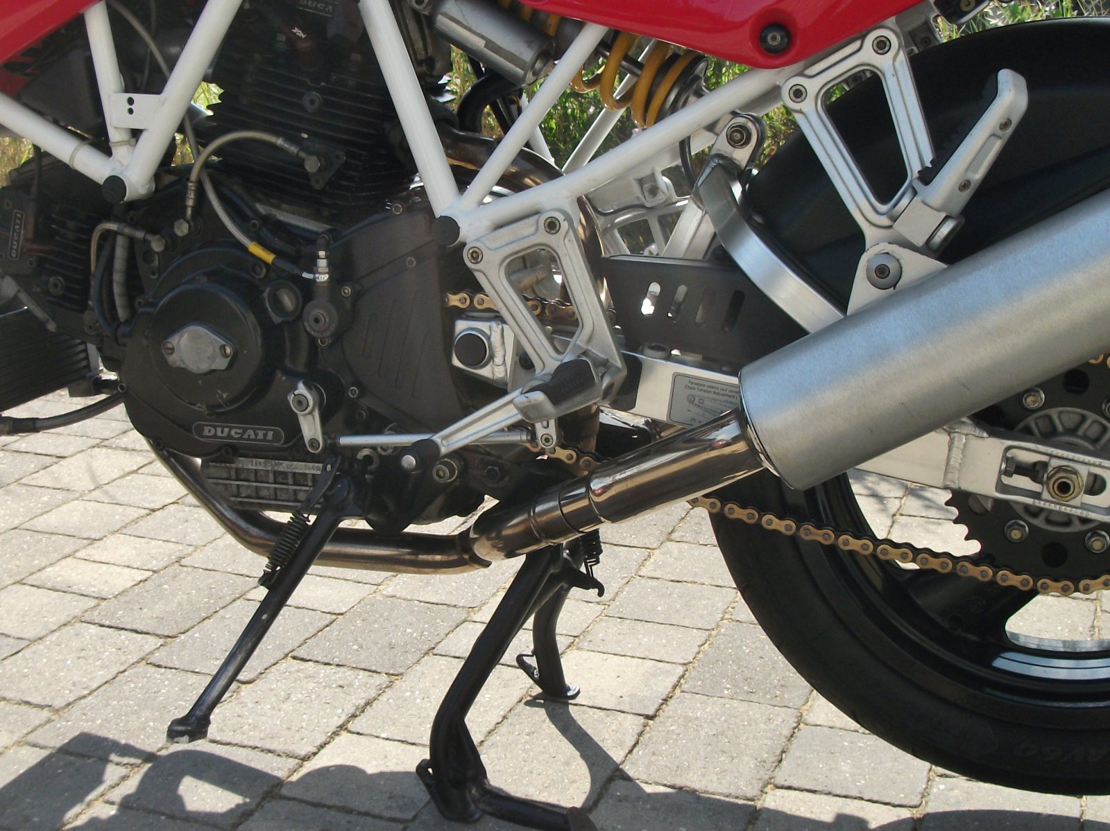

  17. I'm sure this has been done before so I'm not claiming anything new here, but was curious to see how difficult it might be, turns out not at all difficult. (NOTE: Installation is strictly for maintenance)
    £20 ST2 centre stand, bit of faff with spacers etc. as didn't have all requisite bolt sizes, but it works, to remove is easy, R/H side fixing bolt and nut allows removal of stand, L/H fixing plate can stay put (if you like) as the side stand plate fixes on the outside of the center stand fixing plate.
