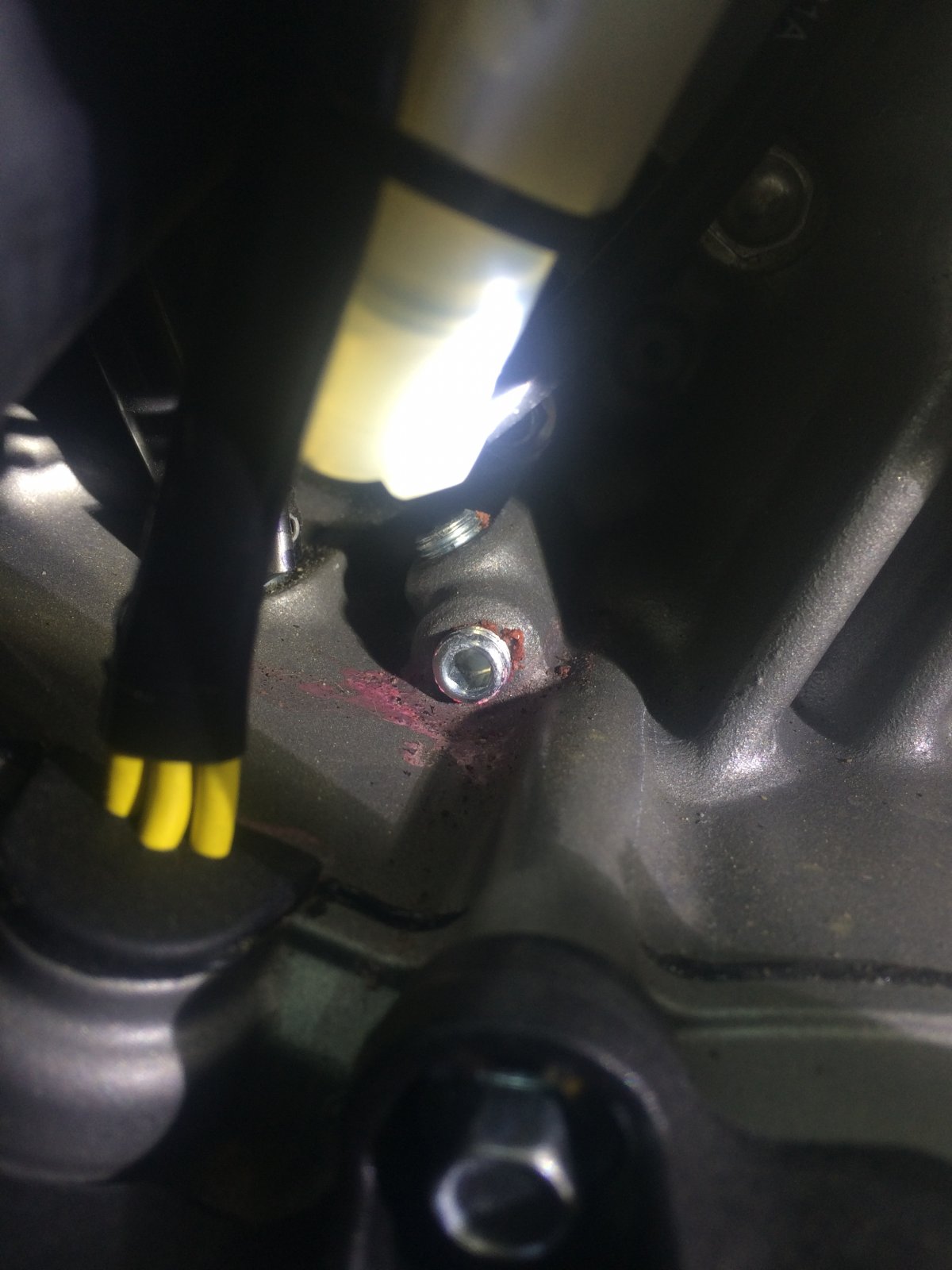

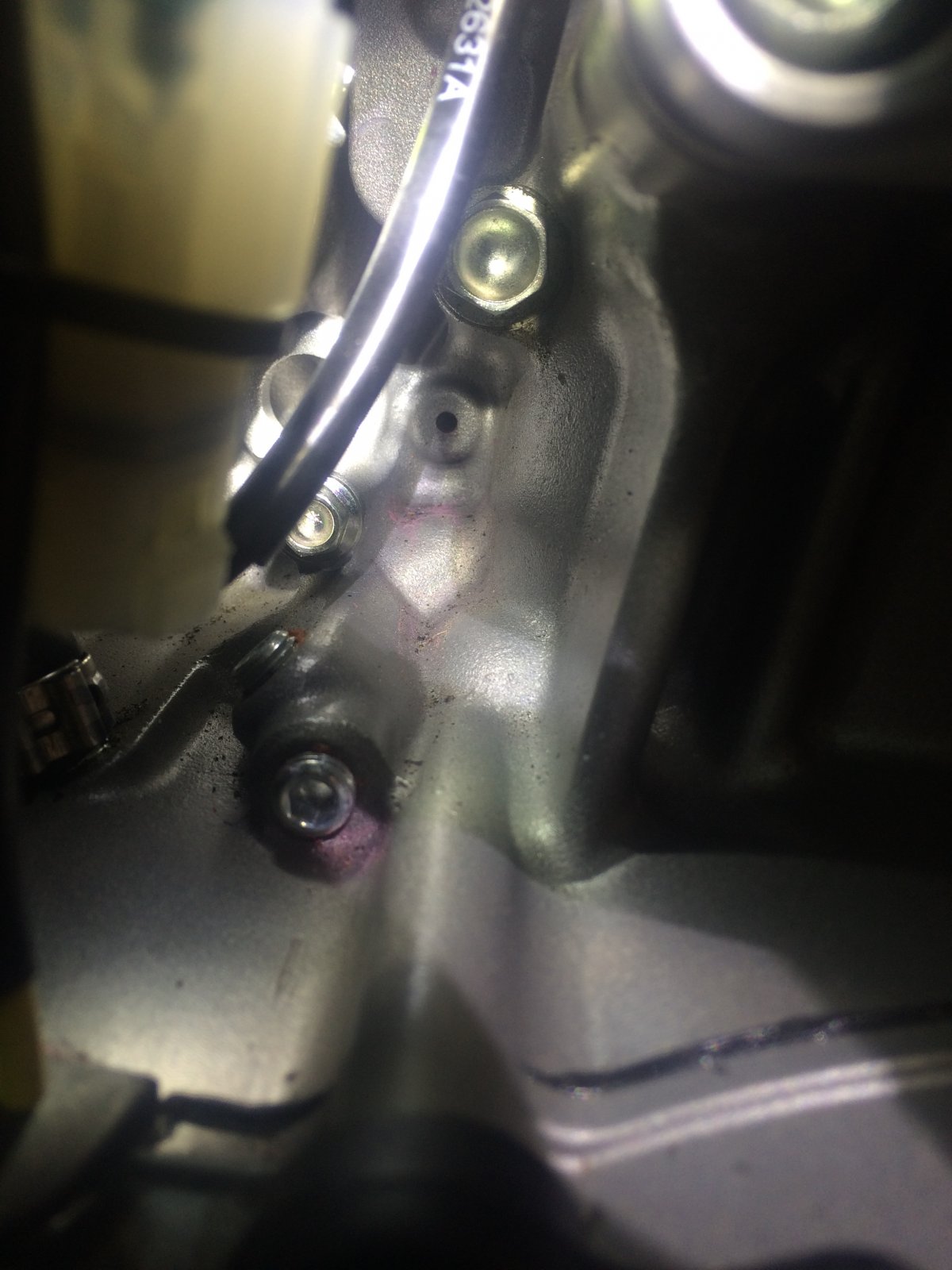

  1. Hello
    Who does know what the whole in the motor block is used for? What does it mean if cooling water is coming out of this hole.
    The engine has 1500km on the odo - 500km on track. Within this 500km I have lost the 1/2 of the cooling water in the cooling water reservoir.
    It's on the left engine side... Between the cylinders.
    Any idea?
    Br Arnold
  2. expect it is water pump failure
  3. Ok thank you for your comment, what makes you thinking so? The engine temperature is always fine according Ducati dda...

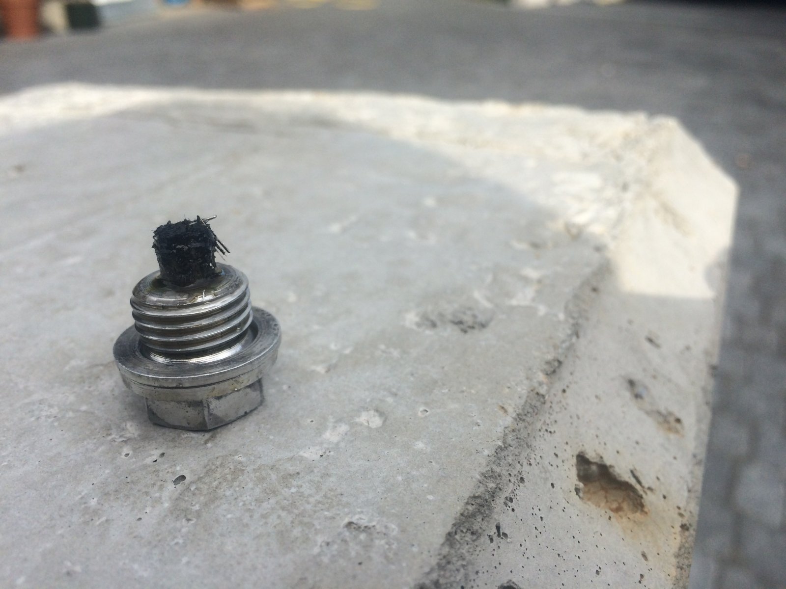

    Getting to the water pump I have to remove the clutch cover, right? :-(... Would that mean that water is going into the engine oil, right? Which would cause serious issue in the engine. I have changed oil yesterday and have a look at the magnet of the drain screw... :-(. I'm not used to such metal fragments from my Japan made motorcycles. After 500km!!!!
  4. normally if the pump has failed it will throw coolant out of the blow hole, coolant won't have got into oil it will be an internal issue on the unit (complete pump only available) and yes its in the back of primary cover, that is normal amount of filings on drain plug
  5. Sorry to bring an old thread back up but I searched and found this one as I have the same issue. The bike has 3700 Miles on it, went out of warranty on the 30th December and the same day I noticed the coolant. It's going in tomorrow to be looked at and the suspicion is the waterpump has failed. As stated above I am told that the hole is used to chuck out water that's leaking to stop it going into the oil.
