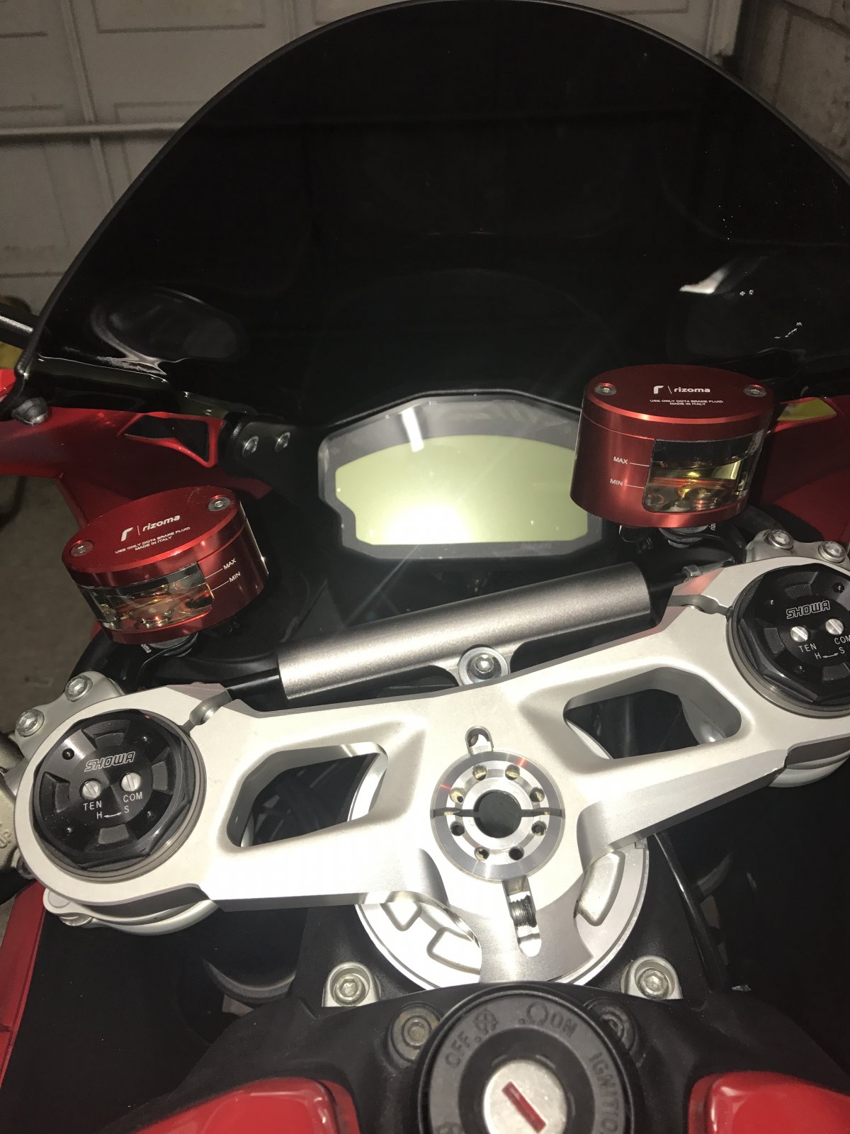

    I just purchased the Rizoma reservoirs for my 899 & was also advised to buy 2x bracket kits (pictured below) which I done.
    The only problem I now have is I have no idea where the bracket attaches to. I know it will likely be somewhere glaringly obvious but any help would be appreciated - Pictures would help massively :)
  7. The brackets fit into the ends of your handlebar tubes. Just remove the OEM blanking plugs and once you insert them, tighten the allen key which causes the collet to expand the rubber collar and grip the inside of the tube.
  8. Thanks mate. I'll get another look tomorrow. I didnt want to open the packaging until I was sure it was the correct brackets.
  9. Thanks Topolino, got there eventually! Worth every penny!
  10. How much if you don't mind?
    Think they look superb!
  11. It worked out around £200. The brackets were £35 each alone! Expensive... but looks the part.
  12. Money well spent chap!
  13. Your welcome. Had fitted them to my 1199 and about to fit them on the 1299. One word of caution. Do NOT use the brake tubing that Rizoma supply with the reservoirs. It's been well documented to leak. Use either OEM brembo stuff or buy some Tygon clear tubing. Also check the pipe unions in the base of each reservoir are a snug fit as they can weep where they pass through the rubber grommet and allow a fine mist of fluid to escape if not seated properly. It's not something you'd notice sadly until there is an airflow. If they are bone dry after the first ride you are good to go. It's not a fault per say with Rizoma it's more that the rubber grommet that you insert the unions through is a very hard compound and the unions must be dead square when you insert them to ensure no leaks. I found out the hard way. Luckily before any fluid reached any paintwork.
