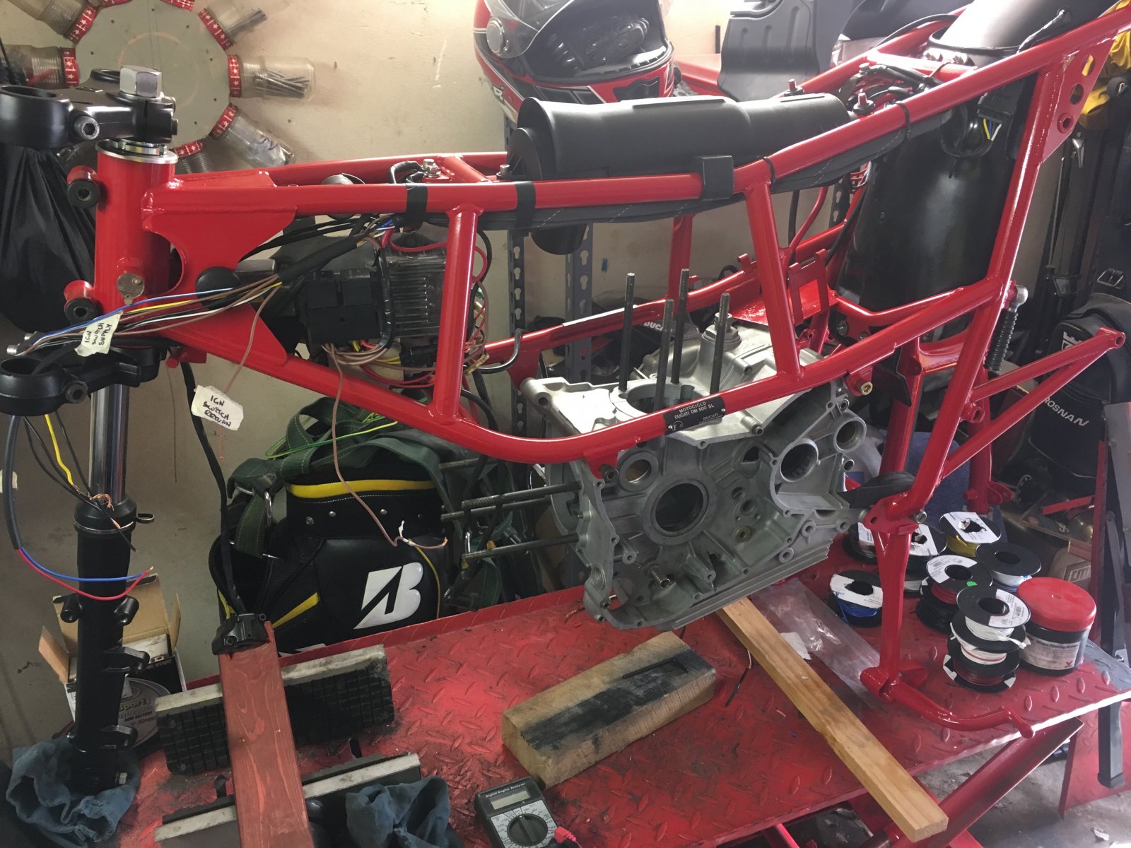

  1. Slowly rebuilding a 500 Pantah front from frame up , trying to replace what I cam with nos pieces .

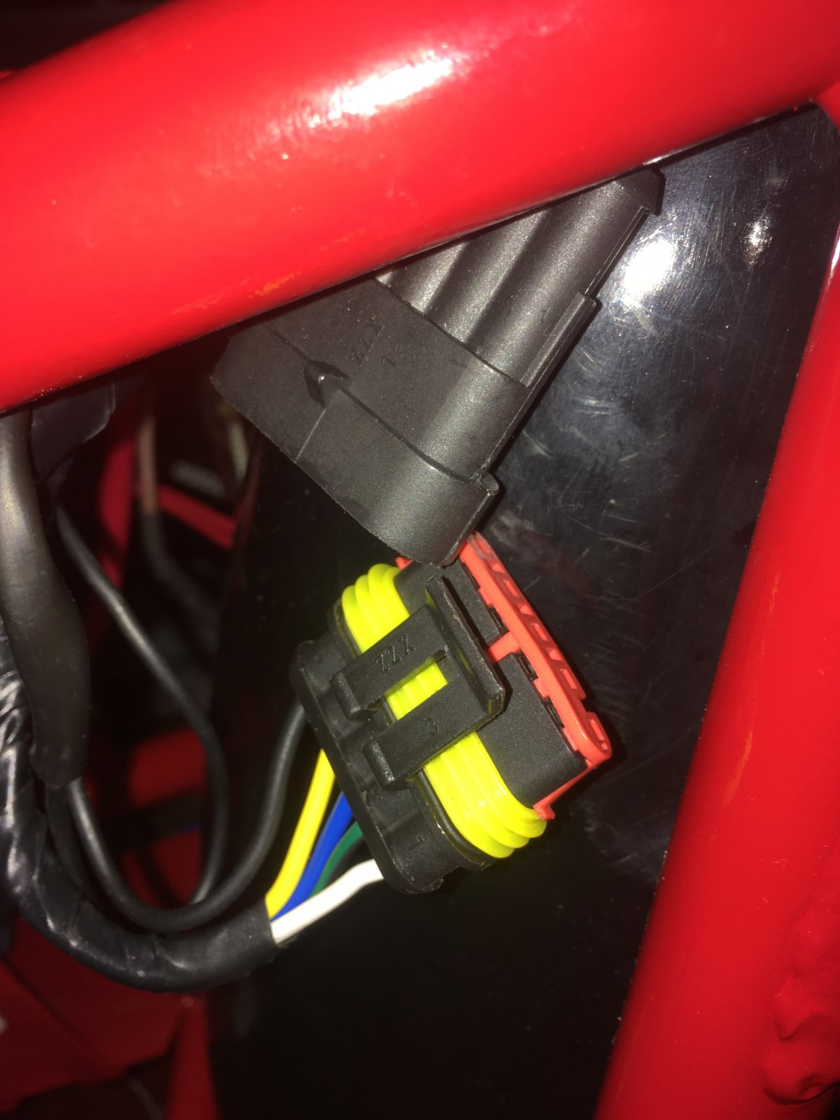

  11. The hard thing for most of it so far was getting 30 years of dirt of everything to start with , as i said above have rewired the whole electrical harness as the one i have has been butchered a lot the rear section was torn and solder mess
    the front section had a relay spliced into it for the coils . So as an electrician and one who has done the auto electrical trade course , decided to see what i could do to improve the original , starting with the way the earthing is done on the bike and going from there . below photo is to the rear lights - earth , brake , parkers , left and right blinkers

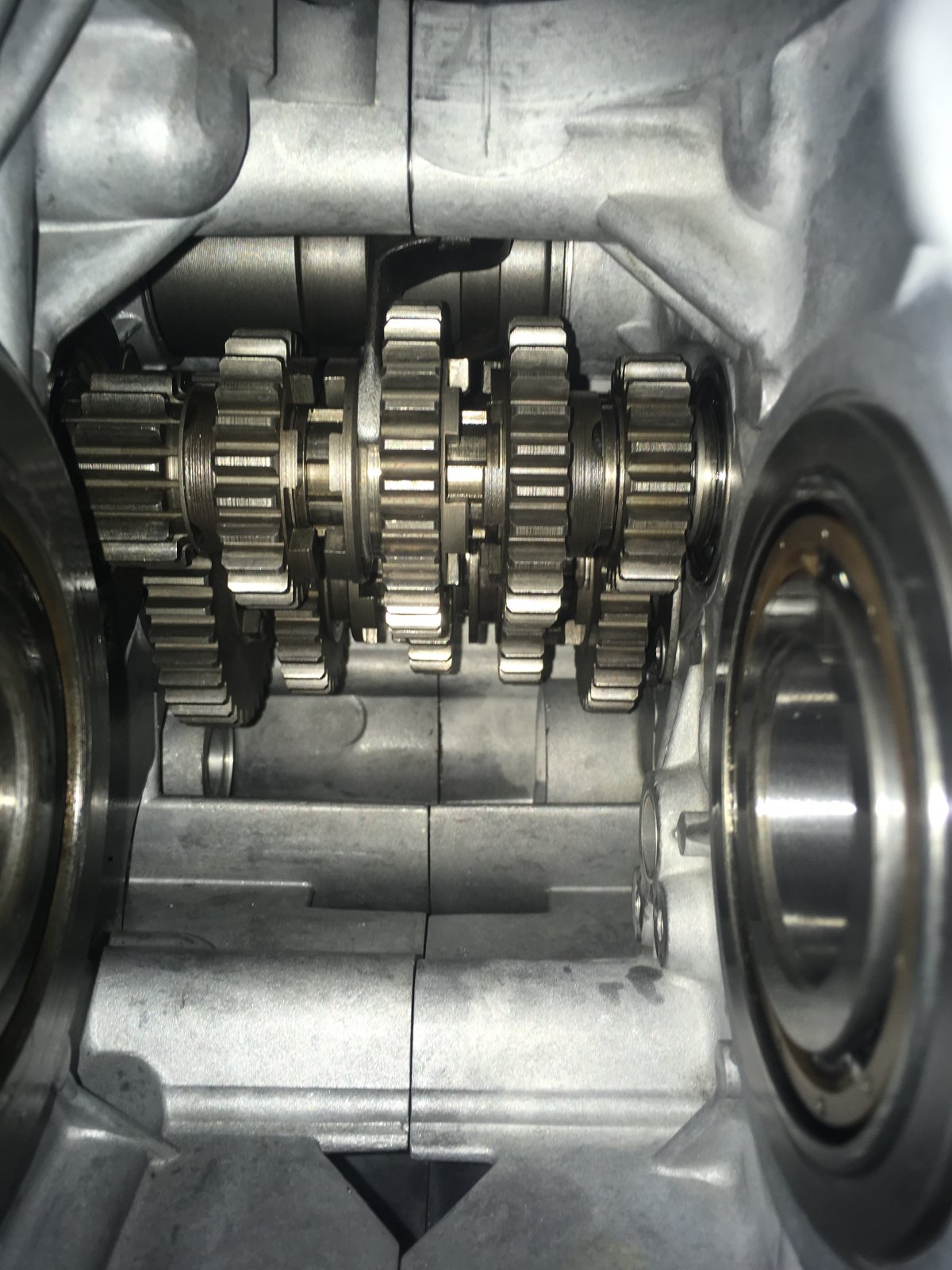

  14. is this like the matrix?
