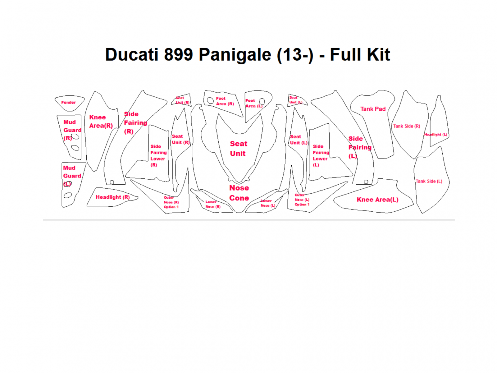

  7. I have an 899 with ventureshield fitted. I have been into detailing for a good number of years and im going to remove the film. My bike is white and i think it really spoils the bike being made up of loads of different parts. My mate has a car wrapping business and i have been chatting to him with regards to doing the bike in large parts, like he does his cars. He prides himself on doing cars in large 1 piece parts. I get that it protects, but they look so much better when you couldnt see it.

  10. Car panels can take large pieces of ventureshield as they don't have all the nooks and crannies that bikes do. Bikes need many small pieces to cover them because of that.

  13. In places it's very hard to define where it starts and where it ends. The front facing part of it hasn't faired as well, the leading edges of the side cowling and nose have all got thin lines of dirt on places.
    I know mine was installed by a specialist by the previous owner, perhaps yours was a DIY job? All I know is that I'm happy to have it replaced in areas that need improving.
  14. My bike was done by a specialist. Like you say the front is not so bad as its harder to see.
    I might just leave the larger forwad facing parts on and remove the smaller parts and coat them in unc-r.
