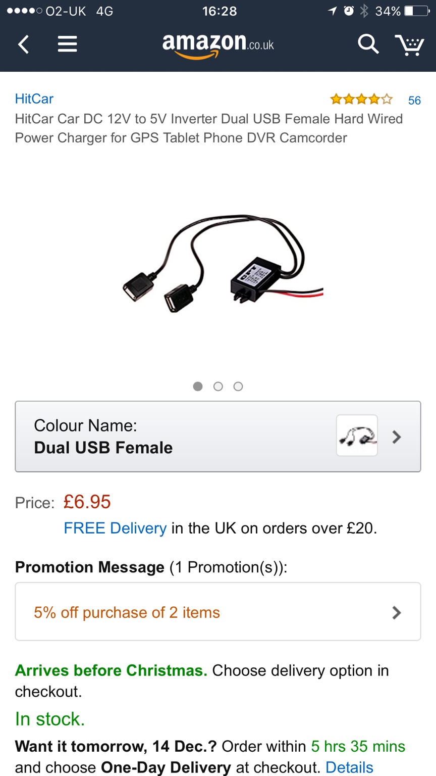

  1. You also need the Ultimate Addons box to step the voltage down to 5v otherwise you will be putting 12v into your iPhone!

    I've used this myself and recommended it to other forum members who have used it. Easy to wire up to the accessory wires Ducati give you. USB too so plug in whatever you like from phones to action cams or proper sat nav chargers.

  8. I ended up buying one of this Sumitomo connector plugs off ebay, and connecting this to my USB outlet (12v to 5v off ebay also for about £5... which I then took across frame via a short lead and mounted on the right side trellis frame). I dont use that often so was a perfect place to take a coiled lead up to the satnav should I need it. All plug and play stuff and easily dis-connected.
