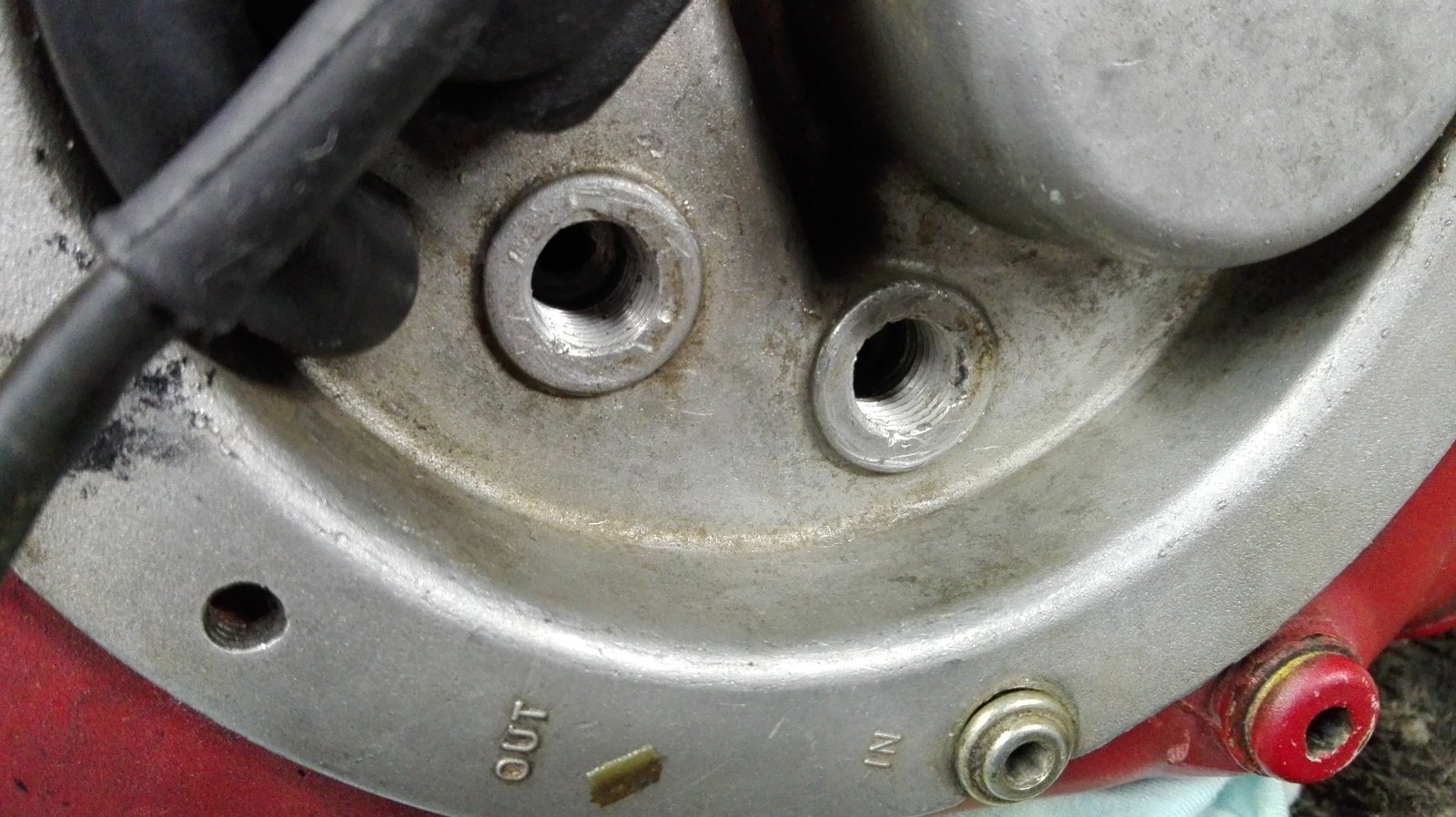

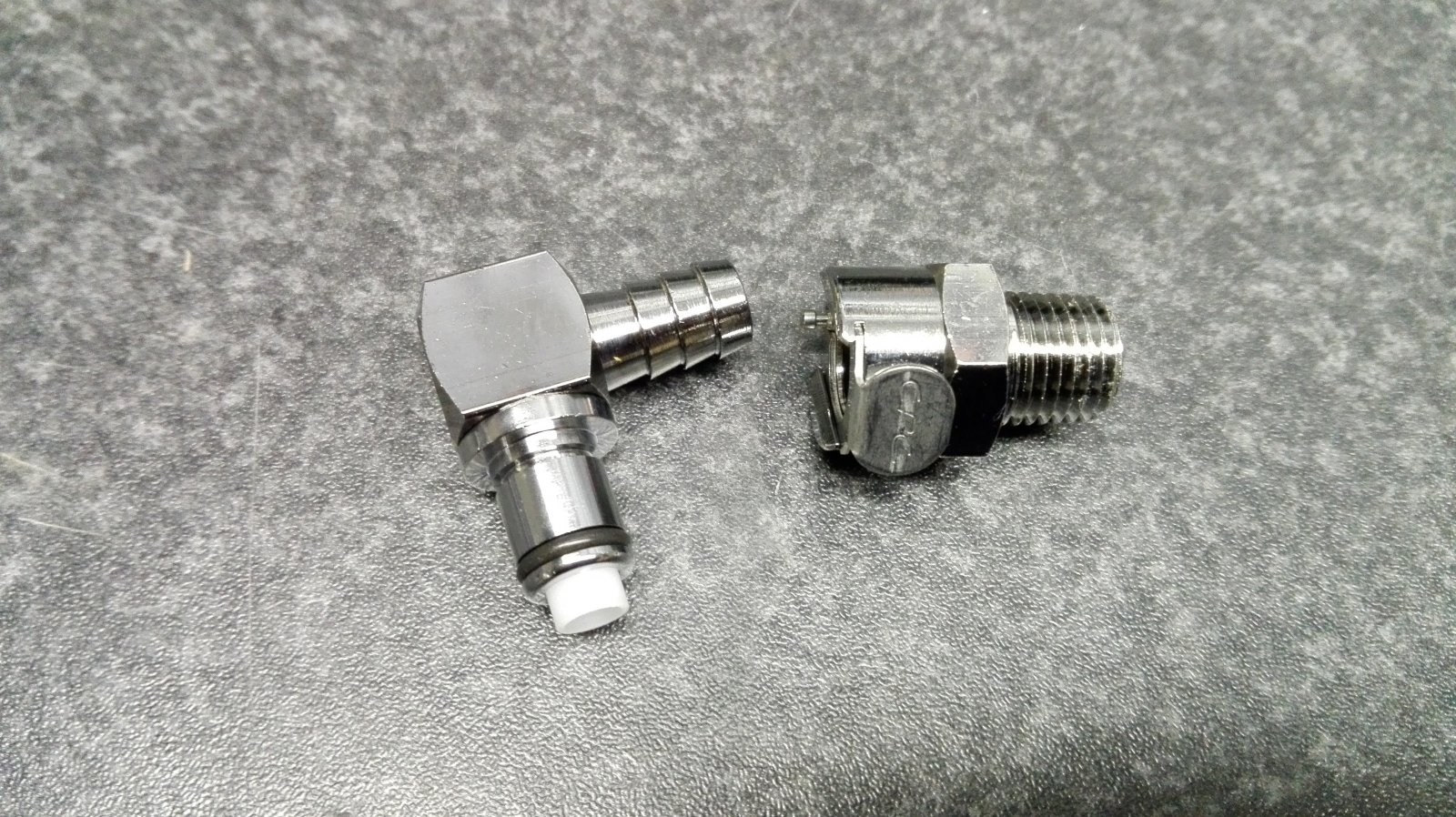

    I've bought two metal quick release fuel connectors.
    My question: do I need to use loctite or something to screw the connector male into the fuel pomp plate?
    They are tapered but I cannot believe it needs nothing to seale it "fuel proof" the thread is lightly damaged because the original plastic shitconnector broke off.
    Does anyone knows the answer?
    Thx
  2. A quick google search leads me to believe PTFE tape is an option. Andy
  3. ..you running it on red-diesel?!?! ;)
  4. I used 'slic-tite' which is a fuel resistant paste but I think it's basically PTFE?
    Whatever it is, it hasn't leaked...
  5. I used blue and it seems to be sealed well.
    Thx guys
