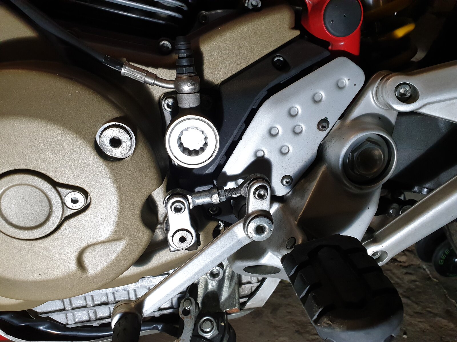

    I've just bought the healtech quickshifter for my 1100. Wheres the best place to bolt the sensor? How did you get on with quickshifter on the hyper? 20190301_194004.jpg

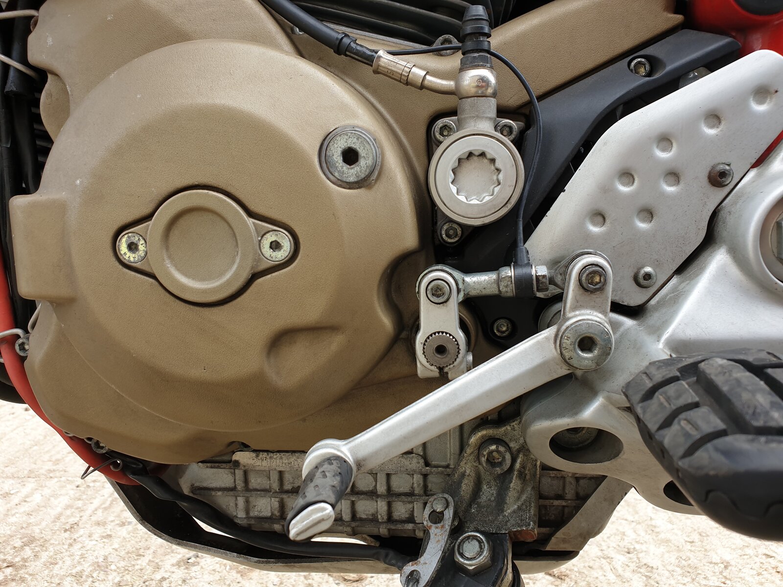

  12. Hi. Itll go right in between that nut on the right and the other part...dunno what to call it. First and foremost Healtech are brilliant if you have any problems....so, from the off (for me) the cut test has never worked but, it doesnt stop it working - id be really interested to see if it works for you. Since ive rebuilt my engine my qs hasnt been working (all the stuff works on it - ie the set up) but, the actual shifter isnt working....i hasten to add that ive not had the time to trouble shoot it...having said that initially it worked first time so im pretty sure you should be able to get it working first time.
    In fact....ive got a free day today so, ill probably get the tank off today and do a bit of checking. PM me if you get any problems and ill do what i can to help get it sorted for you if you have any problems.
  13. Cheers Comfy, appreciate that:upyeah:
    Do you mean on the shift rod? I'll post on here how it goes.
  14. yep...its tight but it does fit. You fitting it today?
  15. Yeah I'm just about to go out now.
  16. Cool...me too...well, about an hour or so...
  17. There's nothing to them. Easy to fit and set up with the app. I carried out the auto setup. I'm going to test it in a couple of hours.
    Reading your thread in the above link, your cut off time was 55ms. The auto set up has set it 90ms on mine. The cut test worked on mine.
  18. Wow - never worked for me.....unless ive got the cylinders round the wrong way (although i dont think you could to be honest....) - so i must have gotten something wrong somewhere....just firing mine back together now...
  19. Connectors with the red square went into the vertical cylinder. I've yet to test it on the road though.
