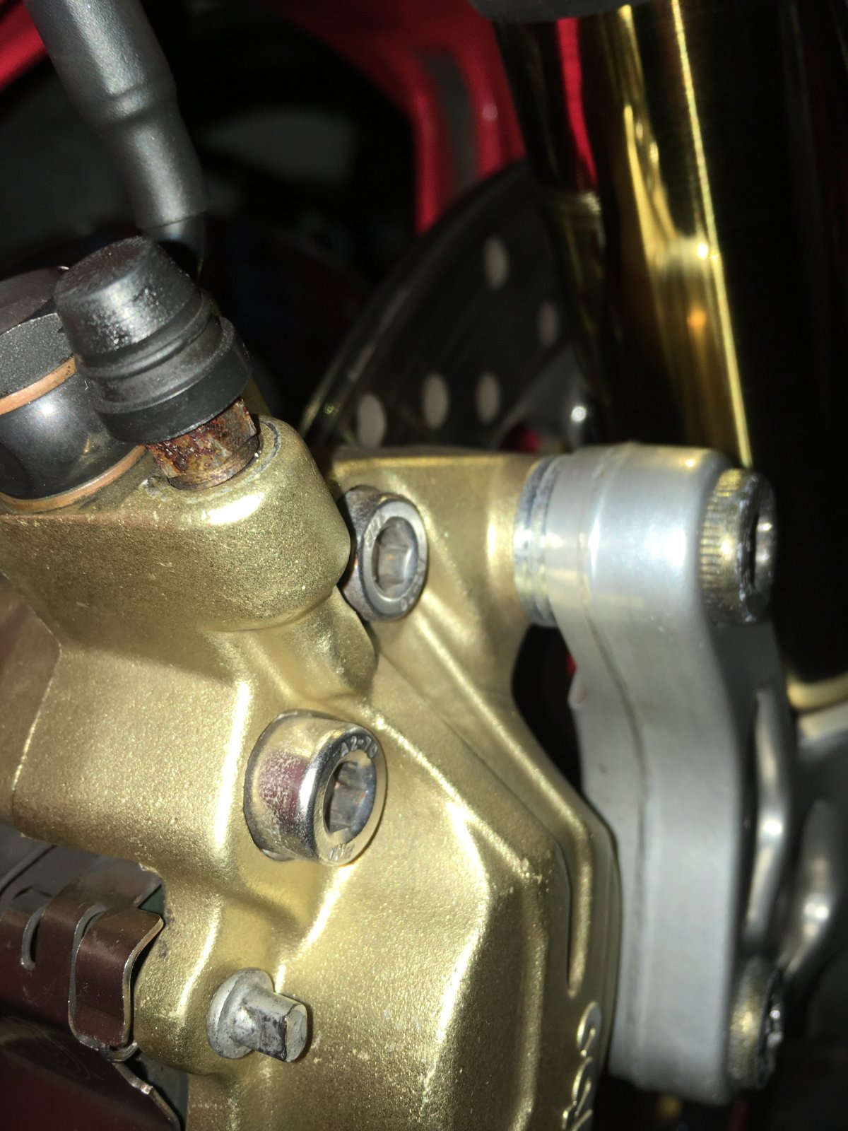

  4. I'm running 10mm offset discs on my front ohlins suspension which run 15mm offset discs , All you have to do is put some washers in between the cailipers and fork leg to make up the 5mm . I'll get a picture up
  6. That wont work with radial calipers (monoblocks) of course.
