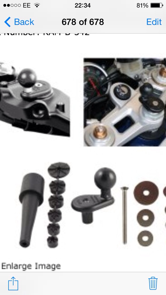

  1. i have used the Ram stem mounts on other bikes but I believe that this may be a problem with the Pani - searching around it seems that some folks have managed to use the Ram B-342 accessory mount with a modification to make it suitable for the type of stem on the Pani, but I am struggling to find any details.
    Has anyone else managed to sort this out and if so it would be great if you could share what you used and the method employed.

  2. I spoke to RAM at a trade show and the answer was a special mod done by an engineer known to them. Essentially, it is a stubby mount with a hex-bolt down the middle that tightens up a nut on a washer with a squashy rubber grommet. the nut/washer/grommet combo pokes through the hole in the head-stock and once tightened up is held in place by the deformation of the rubber grommet ! Simples ! I will be doing something along those lines to my own bike soon, as my current set-up is a bit ugly and crap.

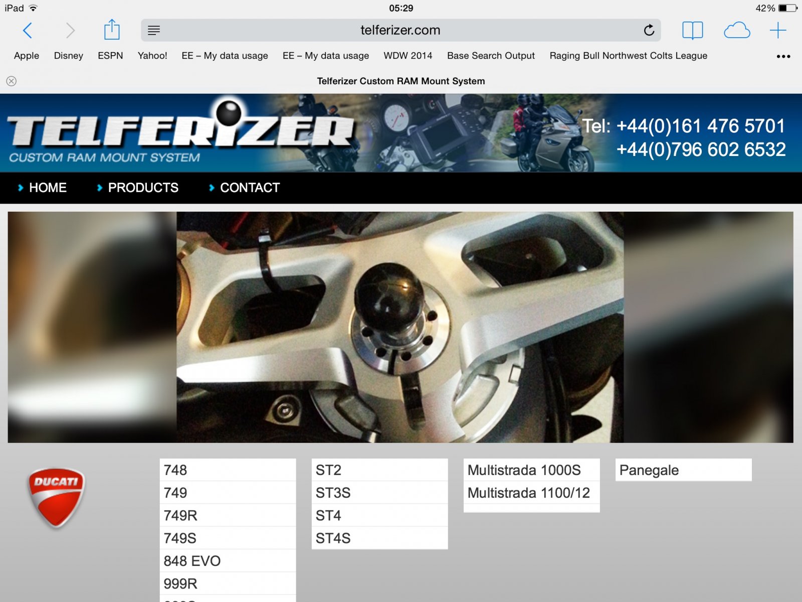

    What you need is a Telefrizer ram mount, I sold one on here a while ago :-
    For Sale - Panigale Telferizer Ram Mount | Ducati Forum
    Buy them from here, a Guy called Bob Telefer runs this outfit, he does security bolts and small waterproof connectors as well.
    The Telferizer Custom Motorcycle RAM mounts for GPS Systems
    Ram arms and other stuff, these people are good and have a wide selection.
    RAM Mount UK
    Just a warning about this mount, the "black ball" on the end is not rubber like a Ram mount, its made from injection moulded nylon and as such its as slippy as fcuk! my ram arm would not hold it without slipping, I ended up buying a Ram ball to go on the end of it to replace the nylon part, so this one fitting ended up costing me about 50 quid !!.........you have been warned!

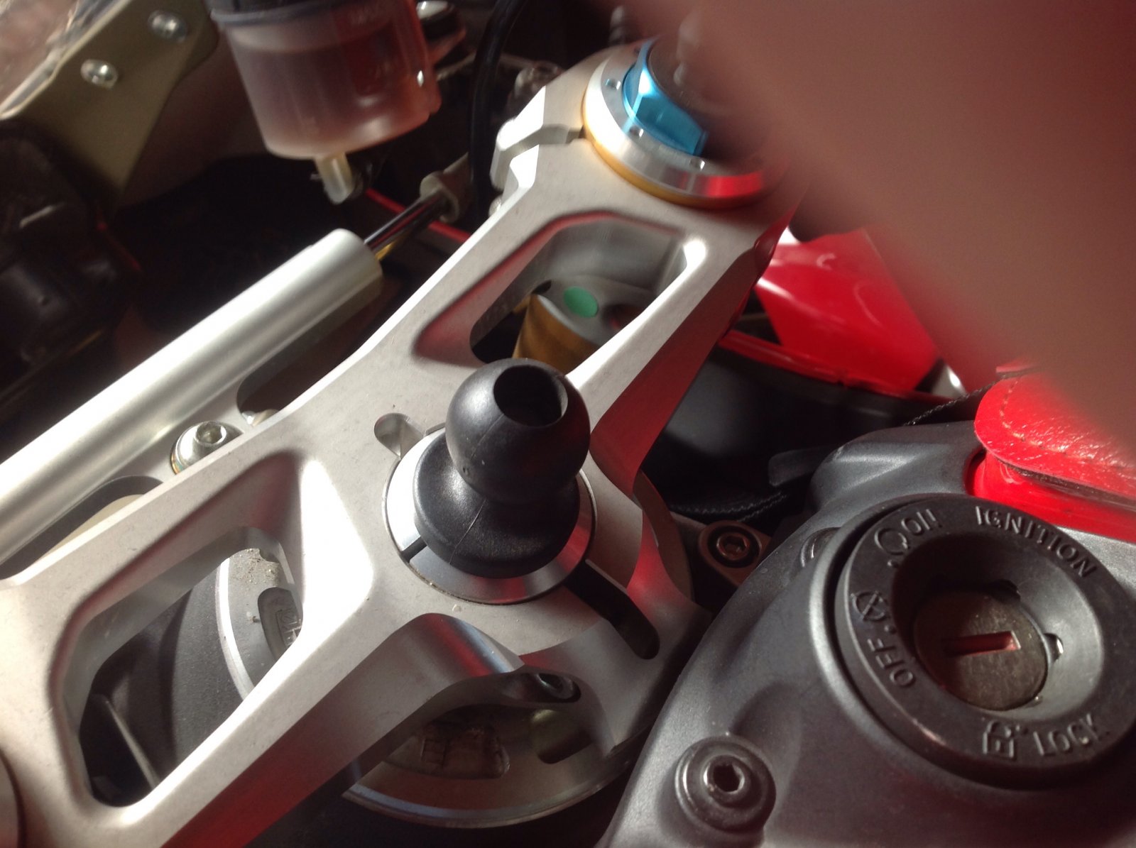

  6. I sorted a Ram mount down the yoke.
    Nice clean place to have it but Pouchers pics look like a good set up too.
    I was told it couldn't be done and wouldn't work.
    The Telferizer mount proves that statement wrong.
    The trick I found was to put a securing nut up from underneath and use a big washer with big rubber washers sandwiched in.
    Works fine as do various other solutions on here.
    The real trick was to use several short extensions from several socket sets and shove them up the steering head from underneath with the captive nut in the socket. You can't get a big one in without major disassembly. A suitable length screw through the middle of the ram mount and some 'Sugru' to cover it over once it's secure and it's job done.

  11. Why don't you just use the Telferizer mount??? its by far the neatest one to fit the top yoke??

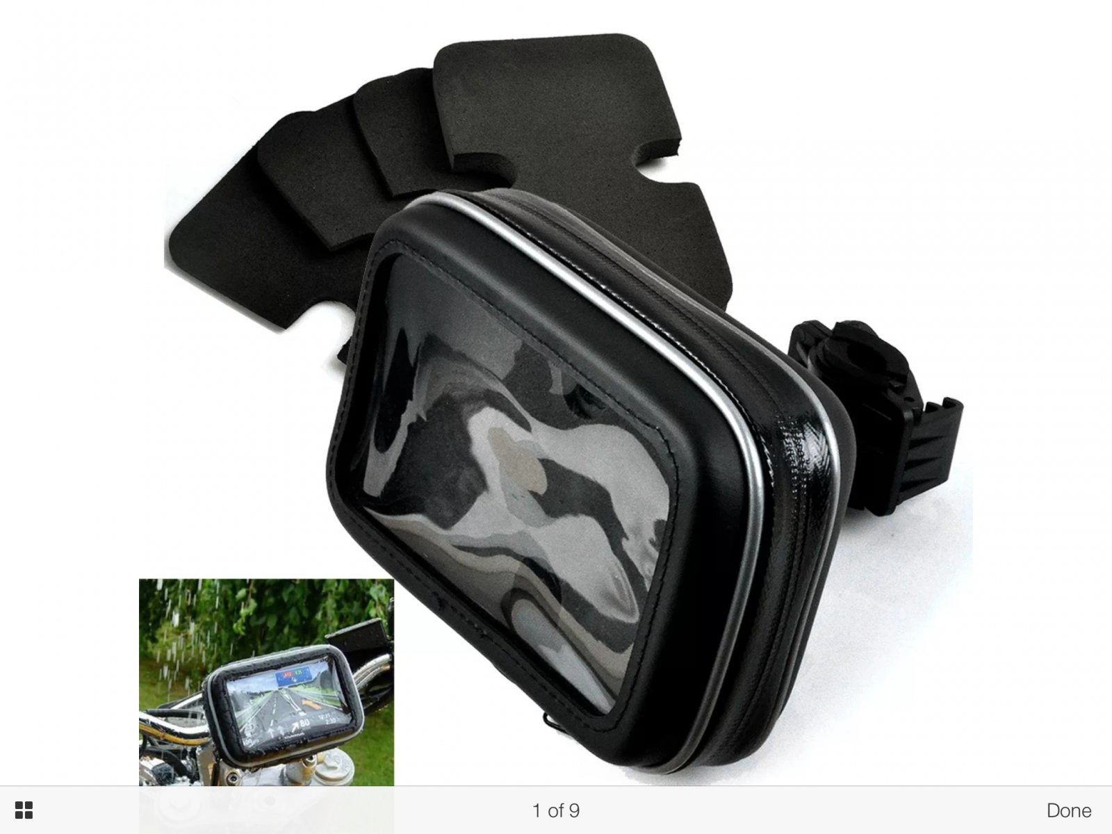

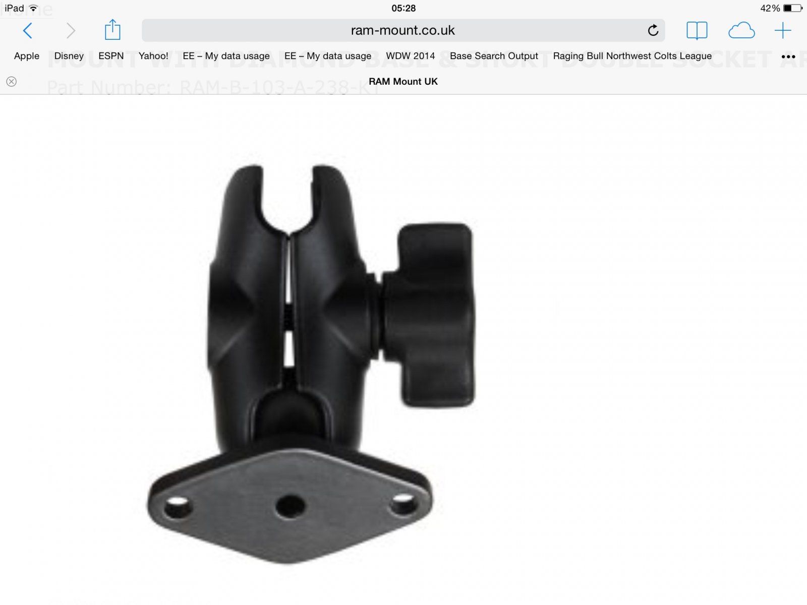

  14. image.jpg image.jpg image.jpg image.jpg Here's what I'm thinking of going for as a set up. I want to use my 5" car TOM TOM XL so it's
    Telferizer yoke mount RAM
    Ram mounts double socket arm and diamond base
    Part no. RAM-B-103-A-238KT
    Sat Nav pouch off ebay
    Cigar lighter socket to plug into optimate lead
    I'm thinking if the Ram ball on the Sat Nav pouch won't fit into the double socket arm then I'll screw the diamond base onto the plastic backing plate in the pouch.
    Anyone done this or got any thoughts ?

  16. I used the short Ram ball connector, I figured it would vibrate less than the long one and you don't need to bring it up higher, it'll get too close to you. I'll post pictures of mine later this morning.

  18. Ram mount, screw through the top, retaining rubber washer, penny washer and nut secured from underneath. Shove 3 or 4 short socket extenders up the steering head with the retaining nut in a socket. Long extension bar won't go in. Or buy the Telferizer.
