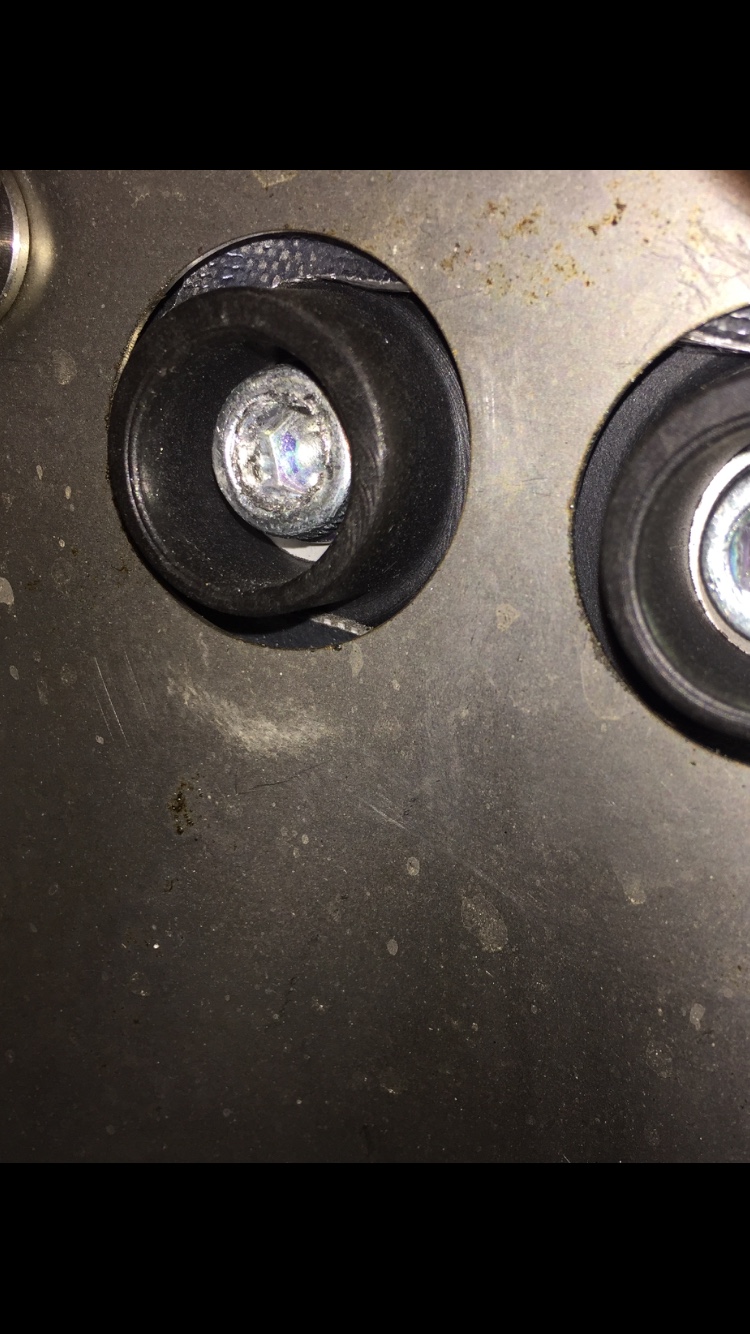

  1. So what I thought was a simple Job has turned into a bit of a nightmare, got 3 of the Allen key bolts out what hold the pegs on and the 3rd was solid , to the point my Allen key slipped and has now slightly rounded the head!! [emoji35]
    It's in the worse place possible and hoping someone has advice how to remove it [​IMG]
  2. Doesn't look too badly rounded. I tend to use a hex bit in a ratchet spanner, then I can hammer the bit in and hold pressure to keep the bit in whilst I get someone else to do the twisting.

  4. Smash a Torx bit in there, or an oversize Imperial one.
  5. O/S Torx always works for me too... it cannot fail :Nailbiting:

  7. hammer a t25 or whatever is slightly bigger in and turn once fully dented in.

  11. I did take the hugger off which helps, I've sprayed it and will let it soak, I'll bring sone torx bits home on Monday and try that, also got a bolt removal set which will grip round the outside of the bolt if I can get it in there!

  17. Success!! Borrowed a T40 torx bit got in nice and tight and ta da!!! [​IMG]
  18. Phew, I said it always works, can keep on saying that now :D
