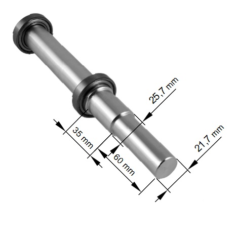

  8. Apologies for not getting back on here last night, pulled an all nighters at work. I measured the pin (genuine Ducati) 21.58mm and 25.66mm.
    I also made one up myself a few months ago and I'd found this
    Mine feels just as stable as my 848 ever did. Hope this helps

    I asked Geetech to make my pin 21.8mm dead so that's why it's not massively stable. I hadn't even thought about stepping it to take the larger of the 2 bores.
    I'm lucky enough to have access to a bank of lathes at work so i'll be able to knock something up with that detail... :sunglasses:

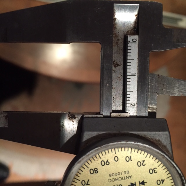

  11. Here is a photo of the size via an old Vernier, before you mill it down. I do have a spare 1 you can buy for £29.99 inc postage, if you want both options.
