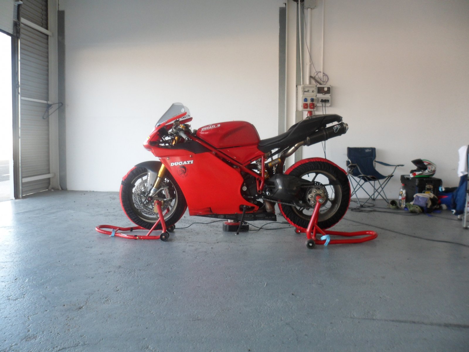

  7. Like this?
  8. I have a Fast By Ferracci mag. swingarm on my 916. It's lengthened by 20mm or so to max out on handling. As a result standard rear huggers don't fit, not as though that bothers me much, also you need to keep it oiled up to prevent corrosion.
  9. Bit of info for you ; From what I can gather, The RS swing arm has a different mounting piont for the shocker and you would need the top rocker to suit. The Febur swing arm is the same length as the RS one (20mm longer than standard - me thinks), but the pivot point for the shocker is the same geometry as the standard and thus the original top rocker can be used. I think Febur did this so that buyers could just bolt it on without going to major expense of top rocker and major suspension set up. ( the info above about the differences of the swing geometry is taken from the 2 mag swing arms I have here - one RS and one Febur) Hope this helps.
