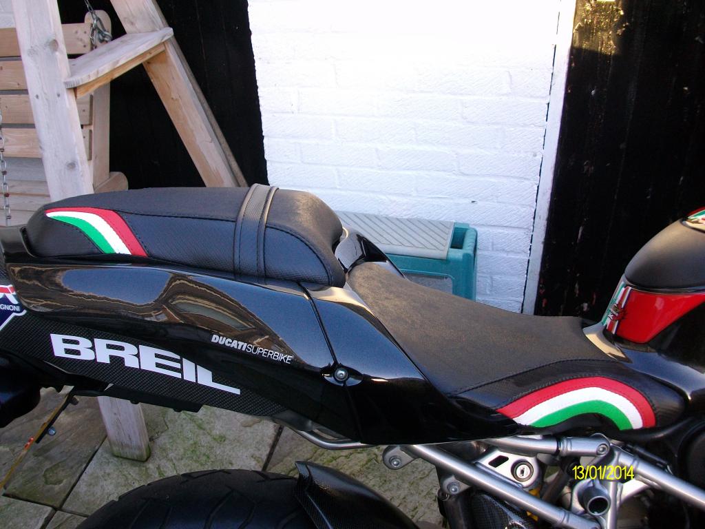

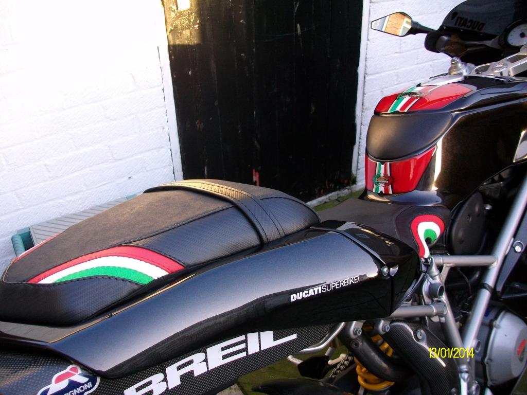

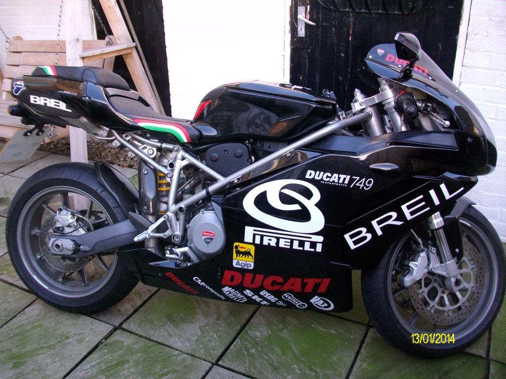

    thanks for your reply, managed to get the seat of no problem!!, easer than I thought, just took of the rear end for easy access, and carefully lifted up the riders seat enough to get a piece of wood between the frame and tank so that you can then gain access to the final bolt the holds the seat to the tank making sure not to over stretch the fuel lines, getting the seat cover on was a little harder!! wish I had used your hairdryer method first?? but your post came after I had fitted the covers.
    I know what you mean about the staples, you have to be careful not to go right thro!! but I think the end result is well worth while.
    im going to try and upload some pics for you to see for yourself. Anyway cheers mate and thanks for your post.
    regards Mark

  7. Hi Mark, Nice job, and nice looking bike as well, thats the second Black 749 i've seen in this section tonight haven't seen one on the road yet.
    Seats do look good, I notice you have changed your mirror/indecators as well also looks good.

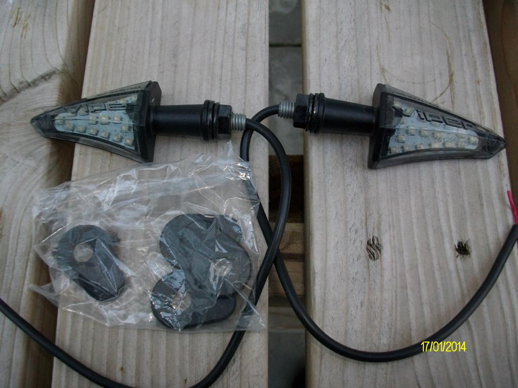

    Hi Deco here is the link you asked for, there based in Holland, but Fred speaks good English if you ring them? or you can order online
    they only took two days to arrive after my payment was received, how fast is that!!!.
    I ordered the stealth aero's in the carbon look and they also chucked in some viper rear LED indicators for the back for free!! but I don't know if that offer is still available, if you only fit the front mirrors you will need resisters for them. hope this is of help.

  15. Hi Mark cheers for the info. Could you post up some photos of both the wing mirrors and the rear LEDs if you can

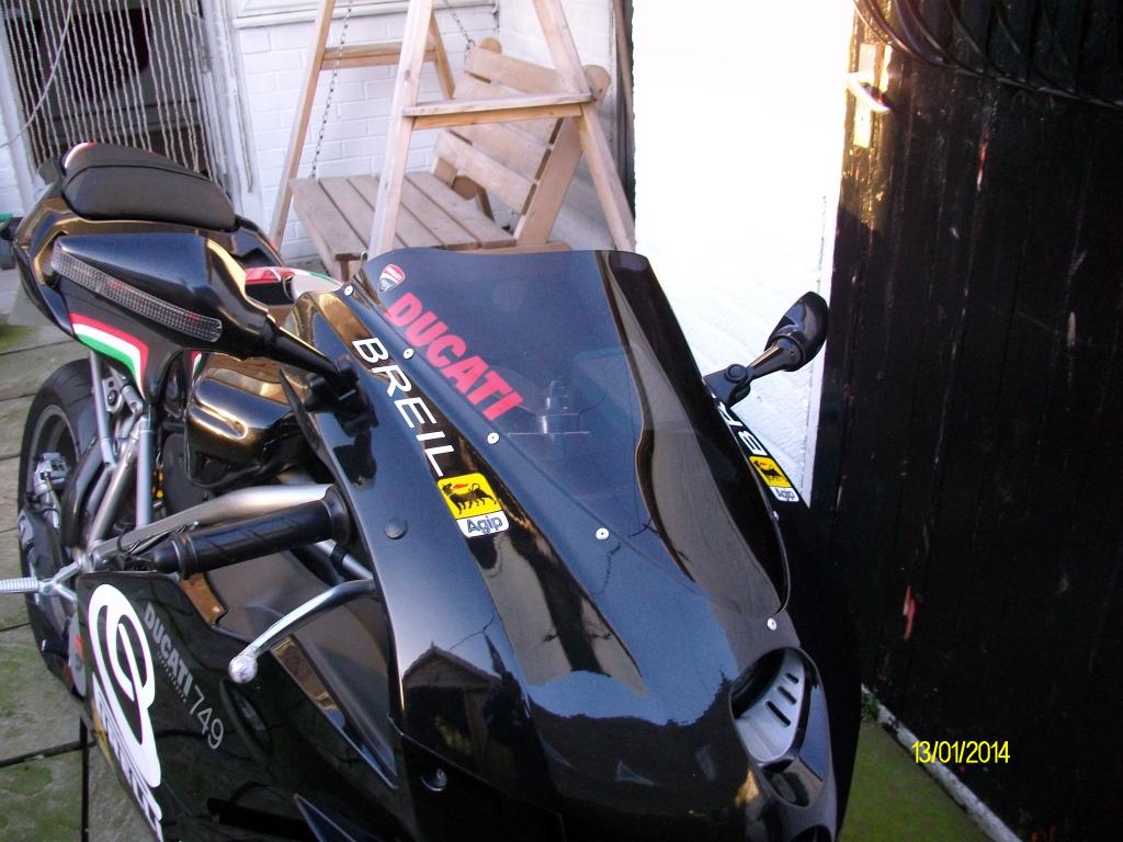

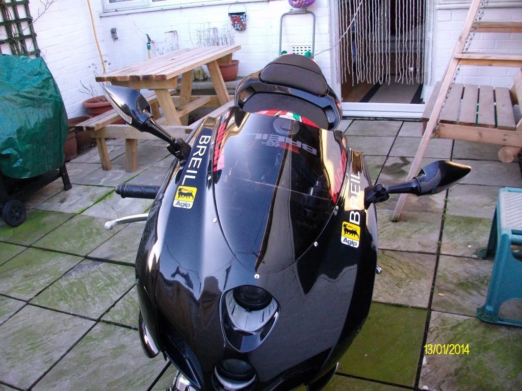

  17. Hi Deco,
    Here are some pics of the mirrors, as you can see I haven't fitted the rear LEDS as yet and have resistors fitted to the front, you will need them if you only fit the front mirrors.
