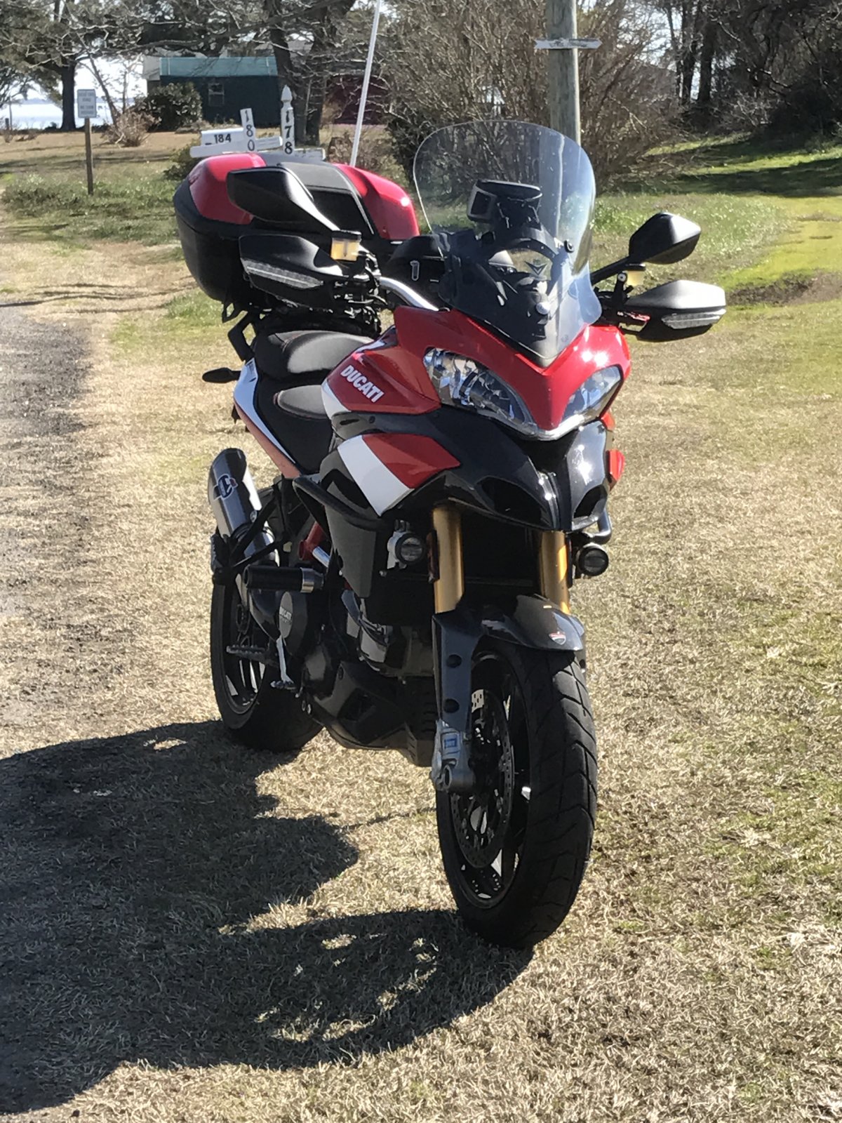

    on another note here is a picture of my 2012 on one of these beautiful 60 degree winter days.
