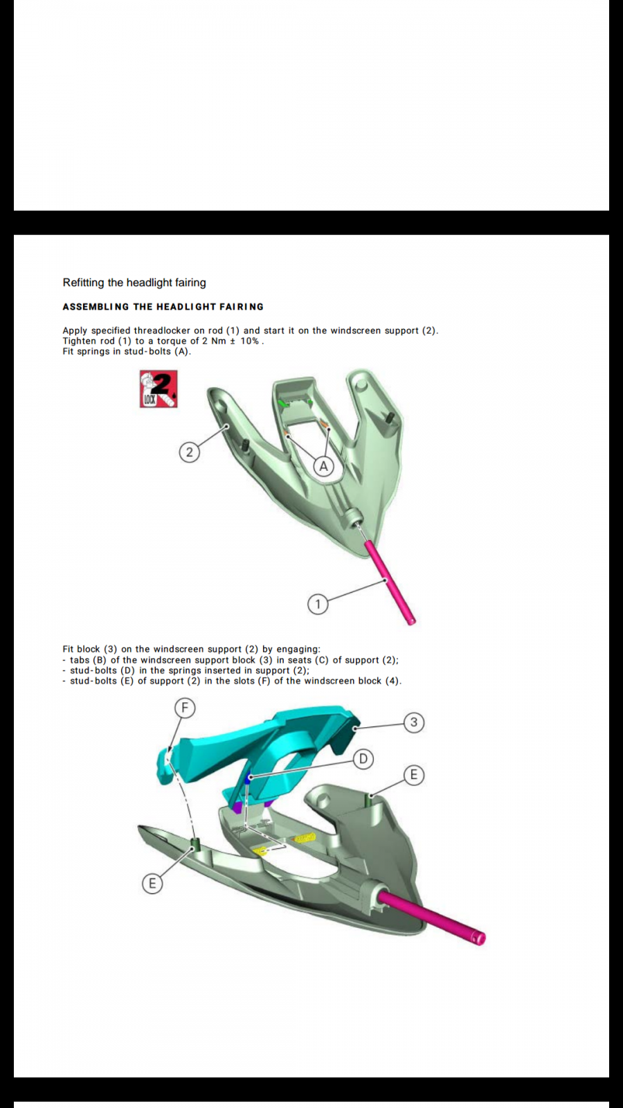

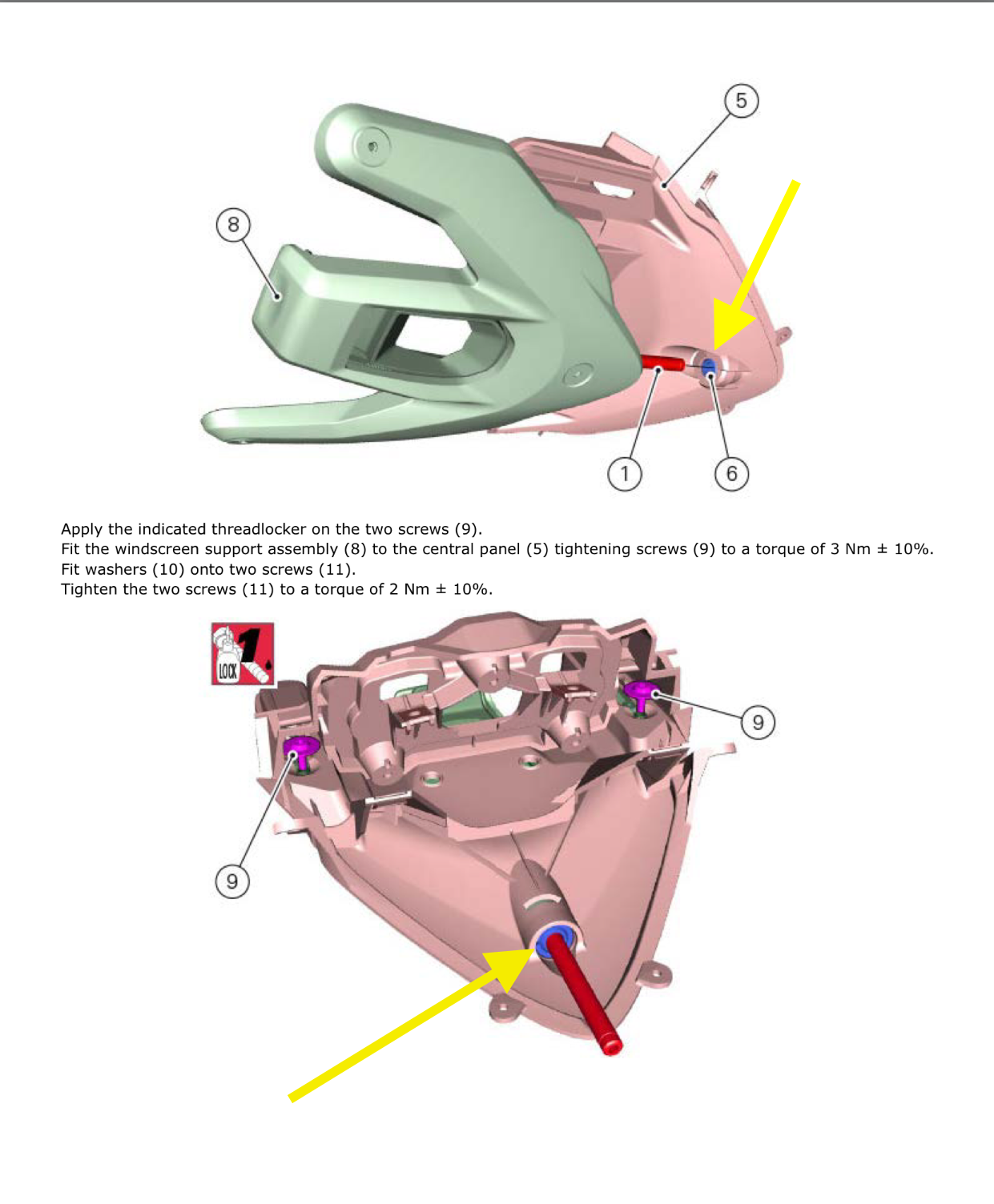

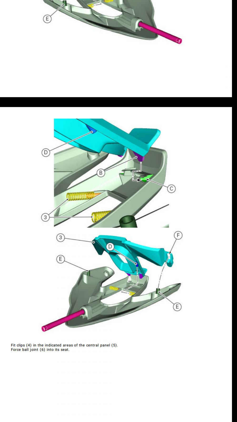

  10. I have the same issue. It started about a week ago and is super distracting. The bottom part of the rod seems like it is not connected to anything. If I remove the headlight fairing, will I be able to see where the bottom part of the rod is supposed to be inserted? I can't tell from any diagrams or videos where the bottom of the rod goes. If anyone has any photos I'd greatly appreciate it. It looks like I'll have to take the tank fairing and gas tank off the bike to remove get to the bolts that hold the headlight fairing on. Sound right or is there another way to apply this superglue trick? Thanks for any help.
  11. I took off the fairings to check out what was causing the rattle. The bottom of the windscreen rod is supposed to be inserted into a "ball joint". There was no ball joint or bushing on my bike. It must have fallen out at some point. Does anyone know if this is a part that can be ordered or if there's a similar part that will do the job? The specific piece I'm talking about is blue in the attached photo.
  12. My bush fell out also. The dealer ordered that part and replaced under warranty. I added silicone when I got home.
