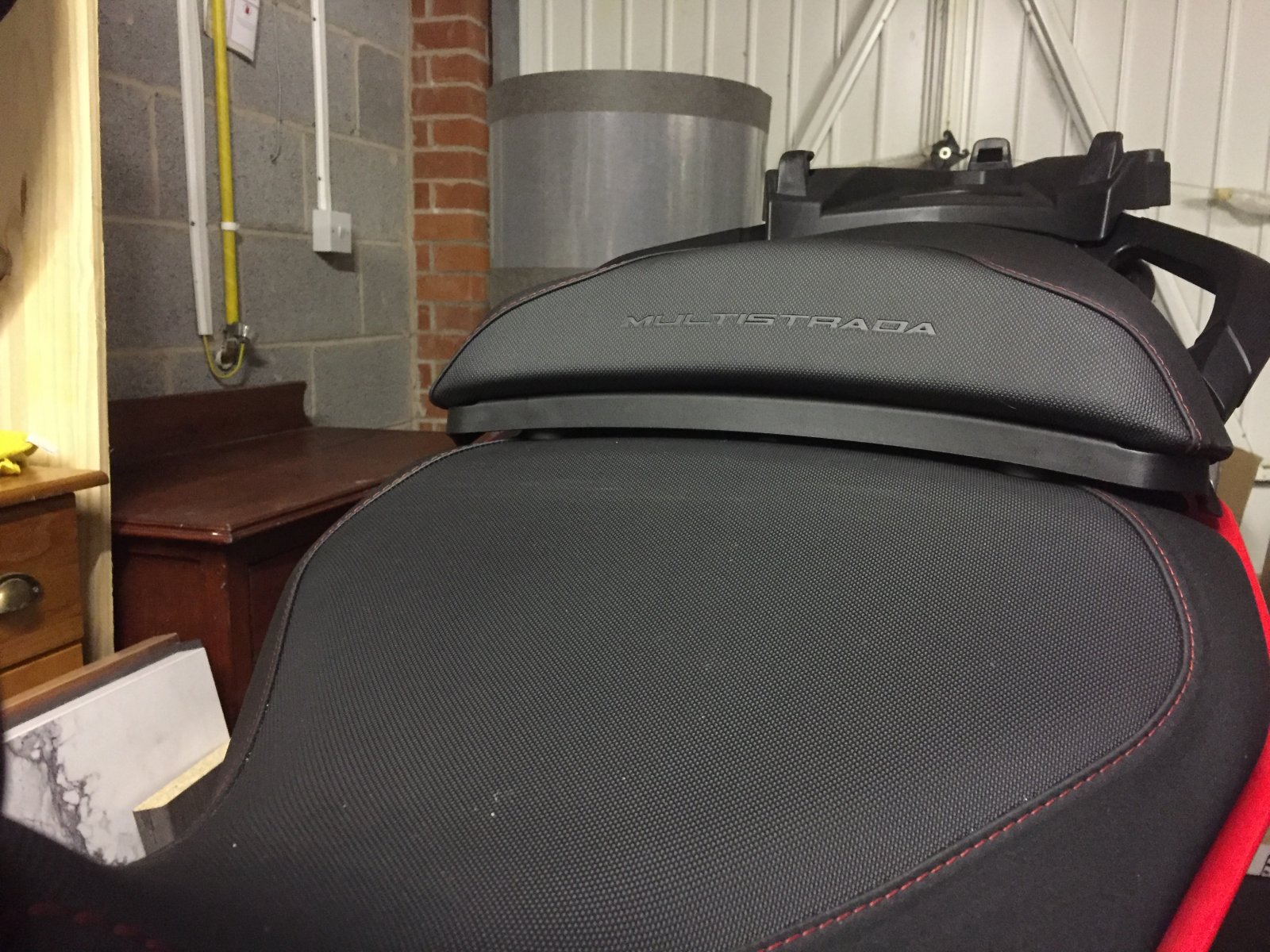

  1. I've taken out the spacers under the seat to reduce the seat height as per the instructions in the manual but now there's a gap between the top of the riders seat and the bottom edge of the pillion seat and the rubber feet on the front of the pillion seat are not resting on the front seat. I see in the manual it references an "elastic support" which I think is the plastic support that goes across the front of the pillion seat, I've fitted that but there's still a gap. Any ideas on if I'm doing something wrong or if there's a part missing would be gratefully received especially as I've ordered the accessory low seat which my even make the gap bigger.

  2. Yes, probably. A photo or two would make it easier to tell what the problem is.

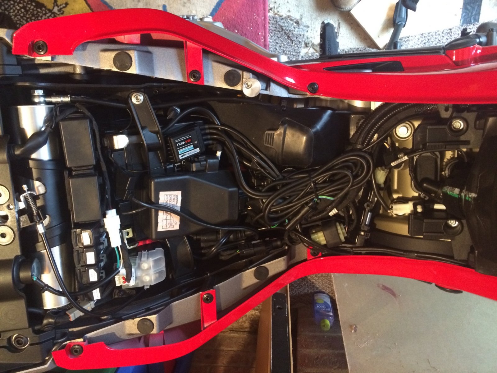

  9. Hi fellas, thanks for your input.

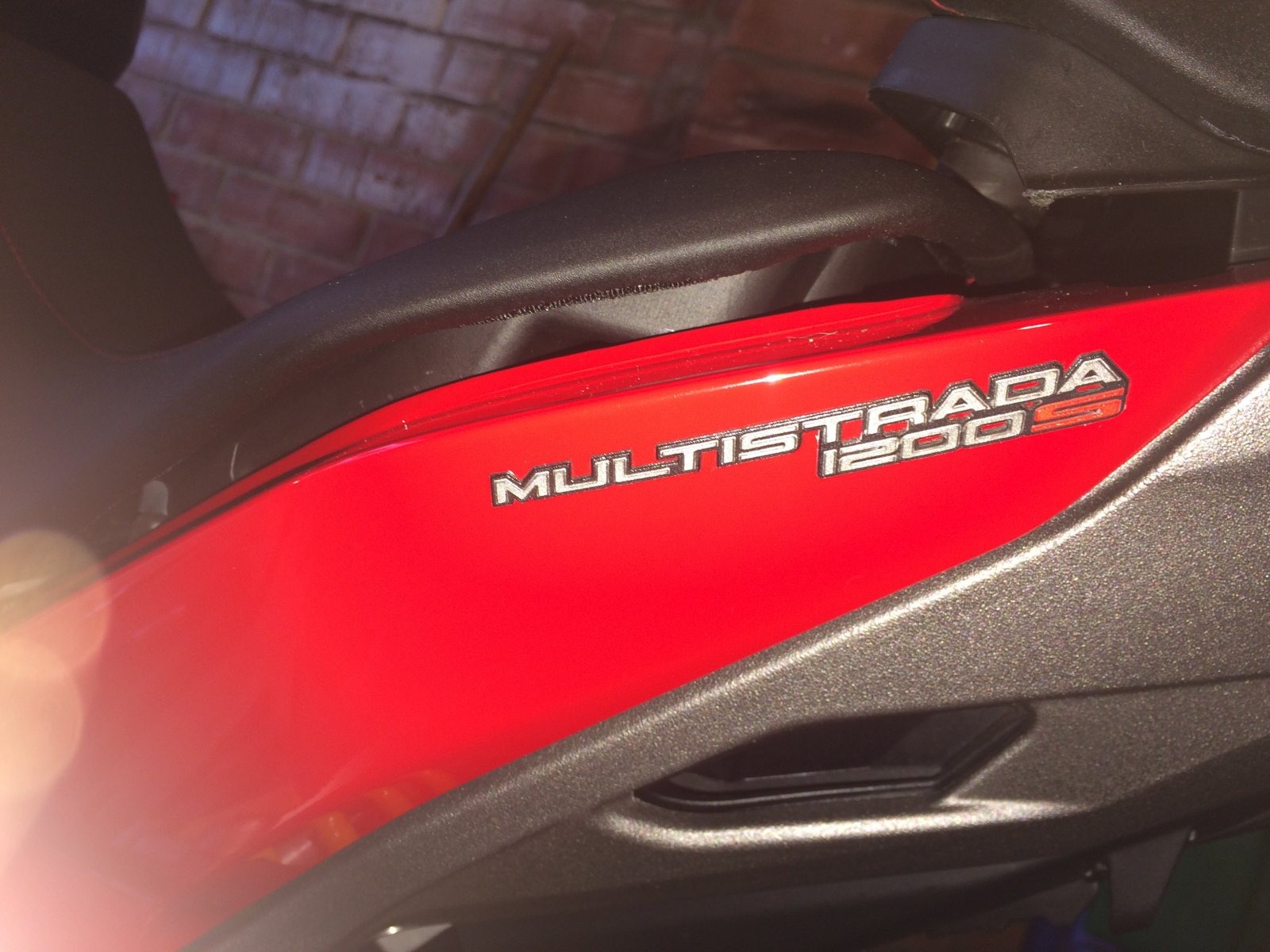

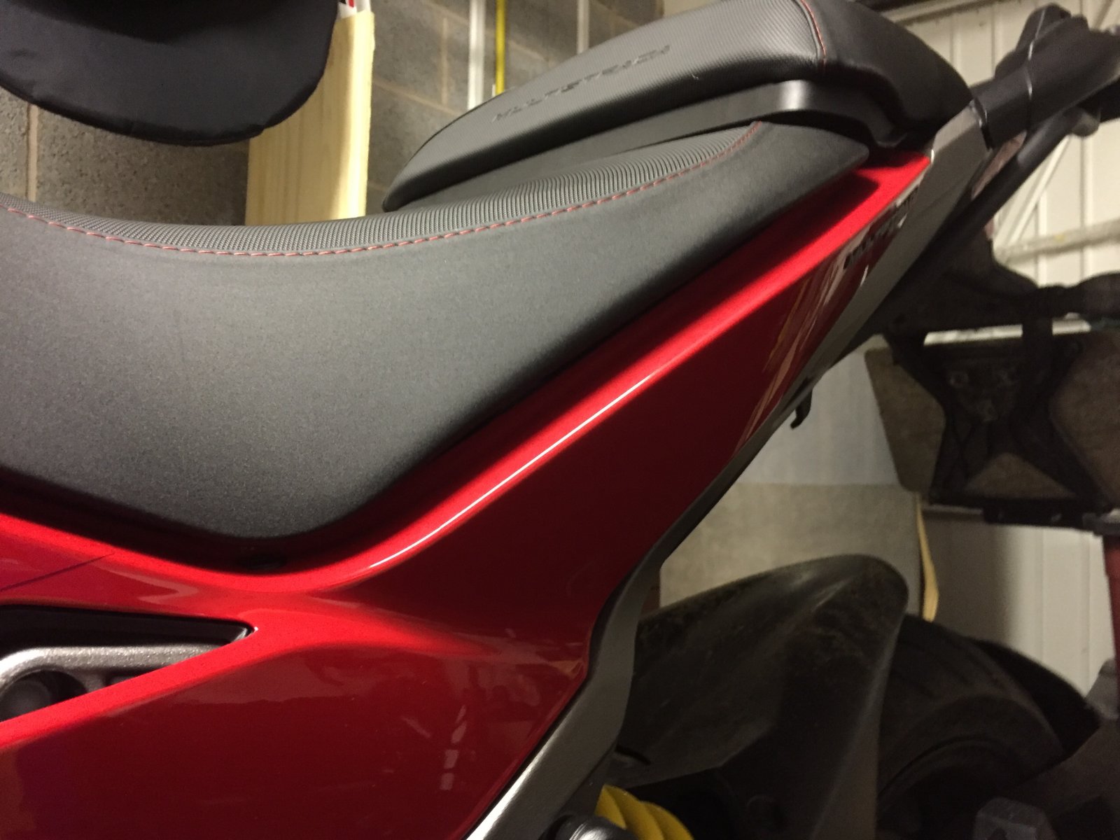

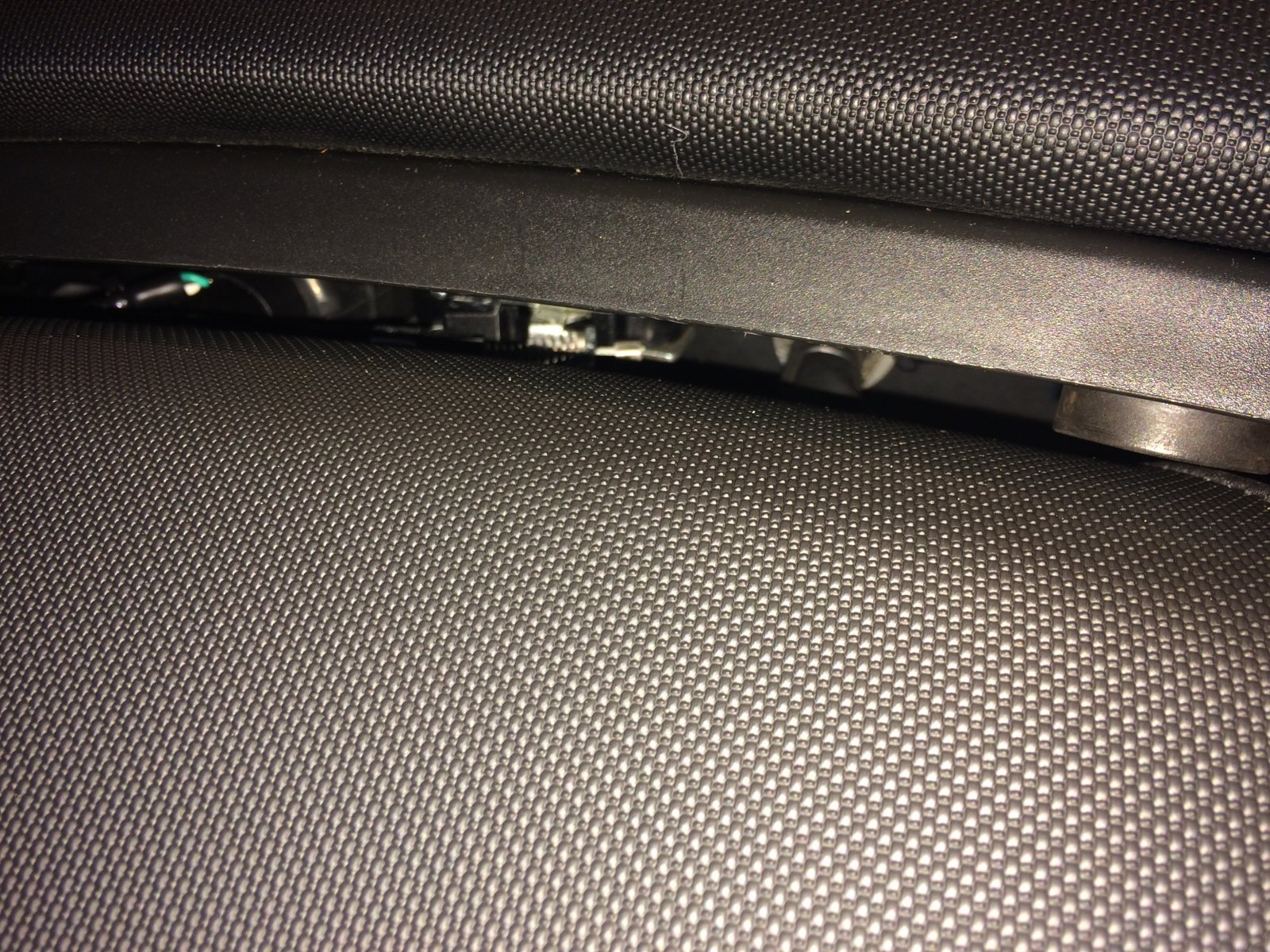

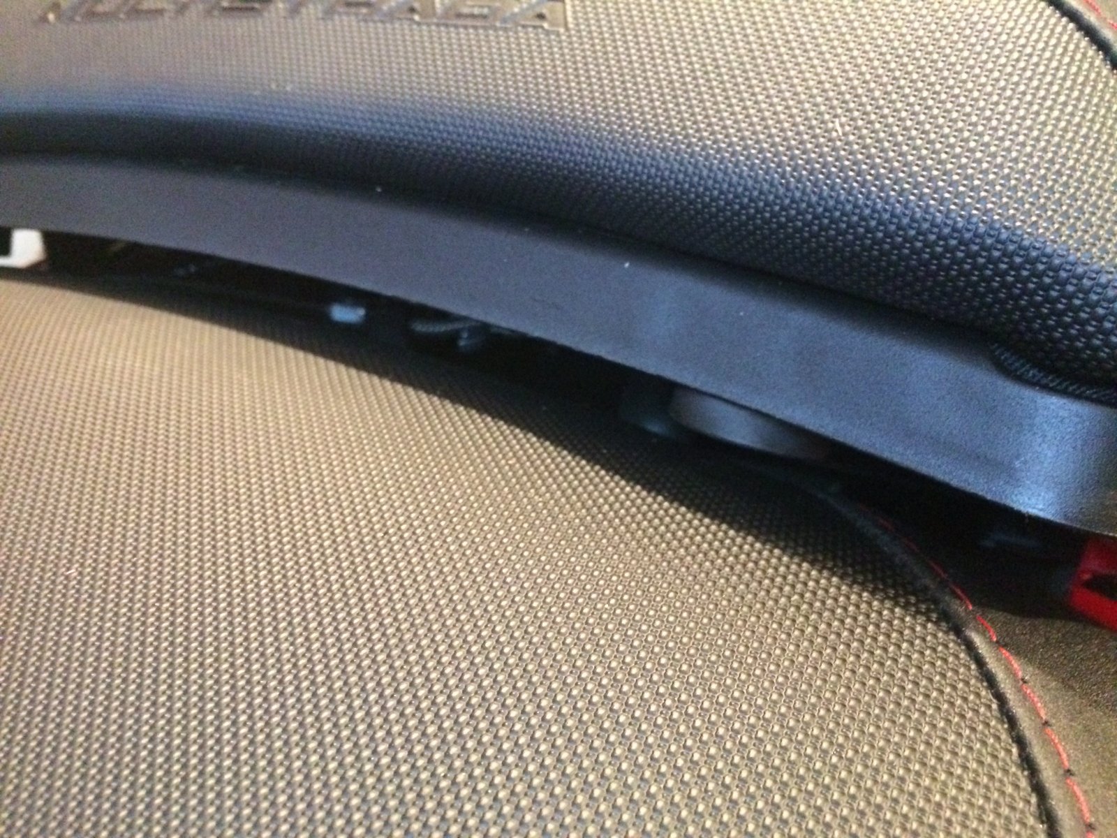

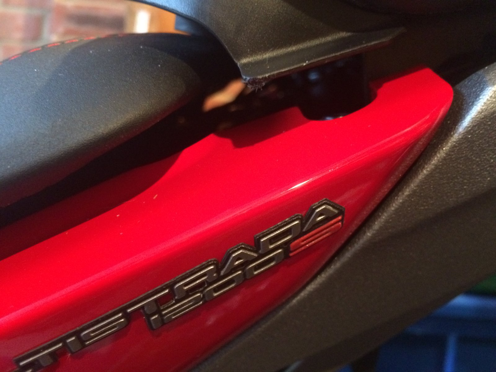

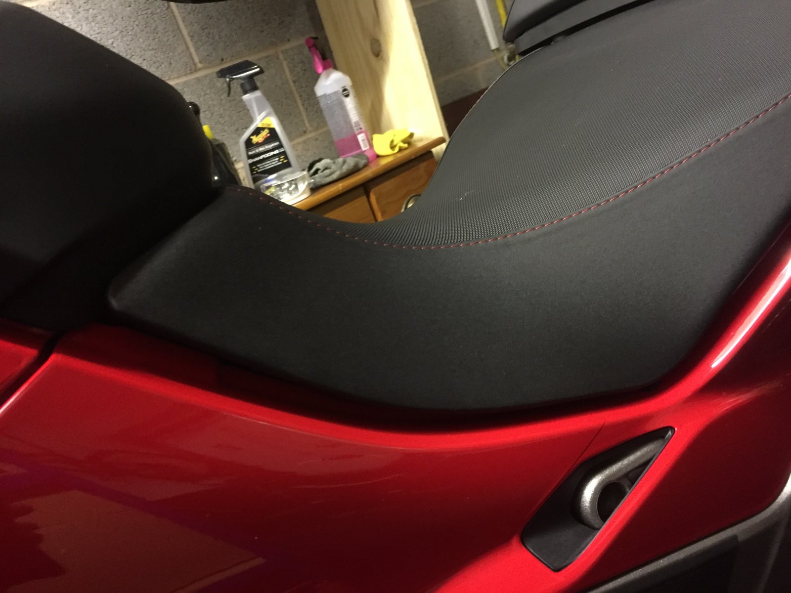

  14. Some more pics if they make sense!

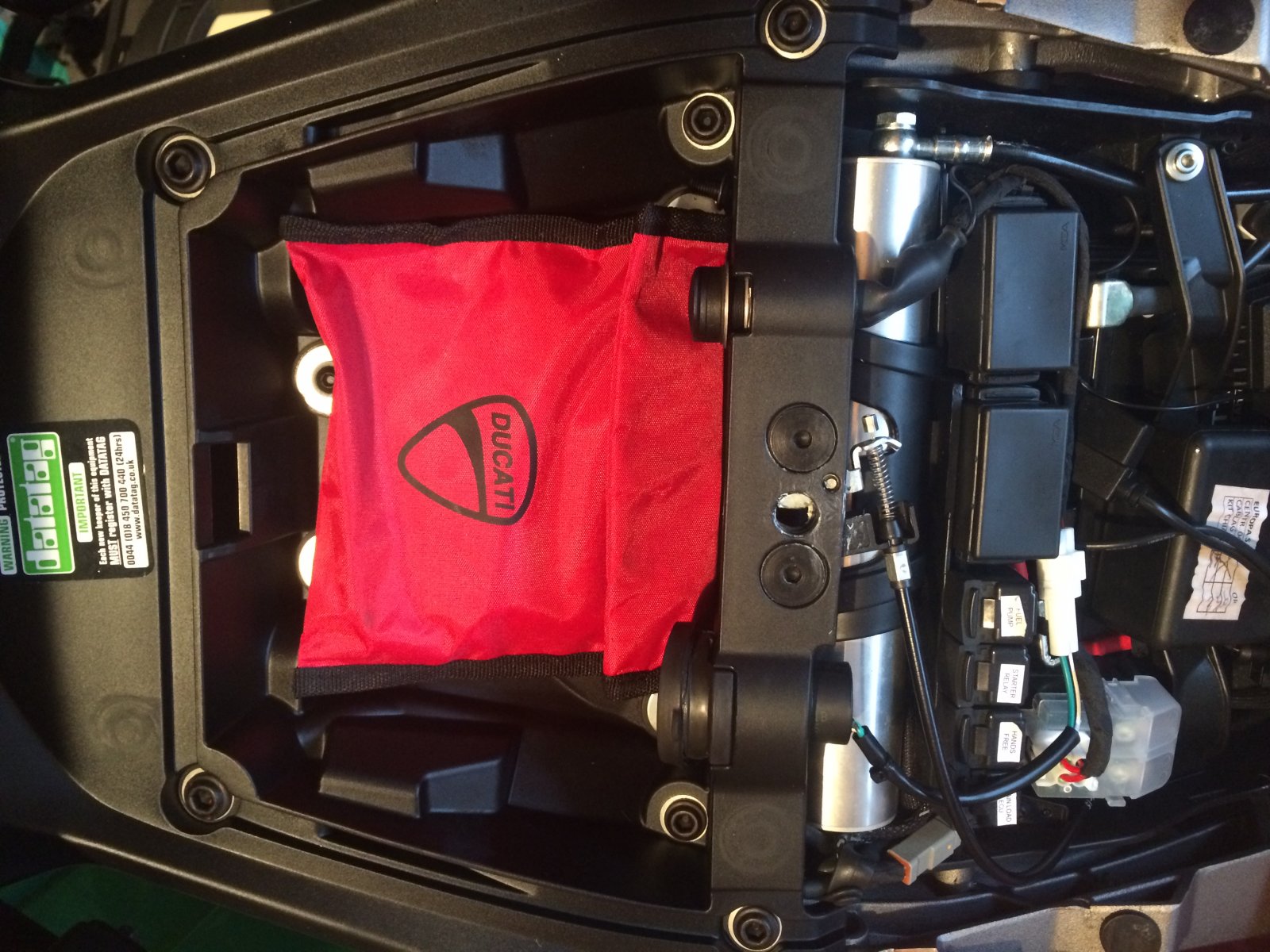

  15. Are you sure that all that extra wiring isn't stopping the front of your seat sitting down correctly.

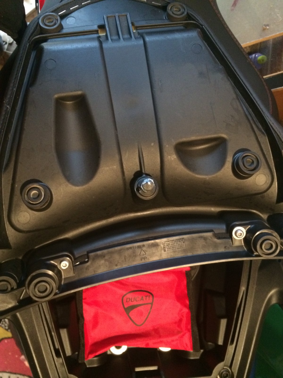

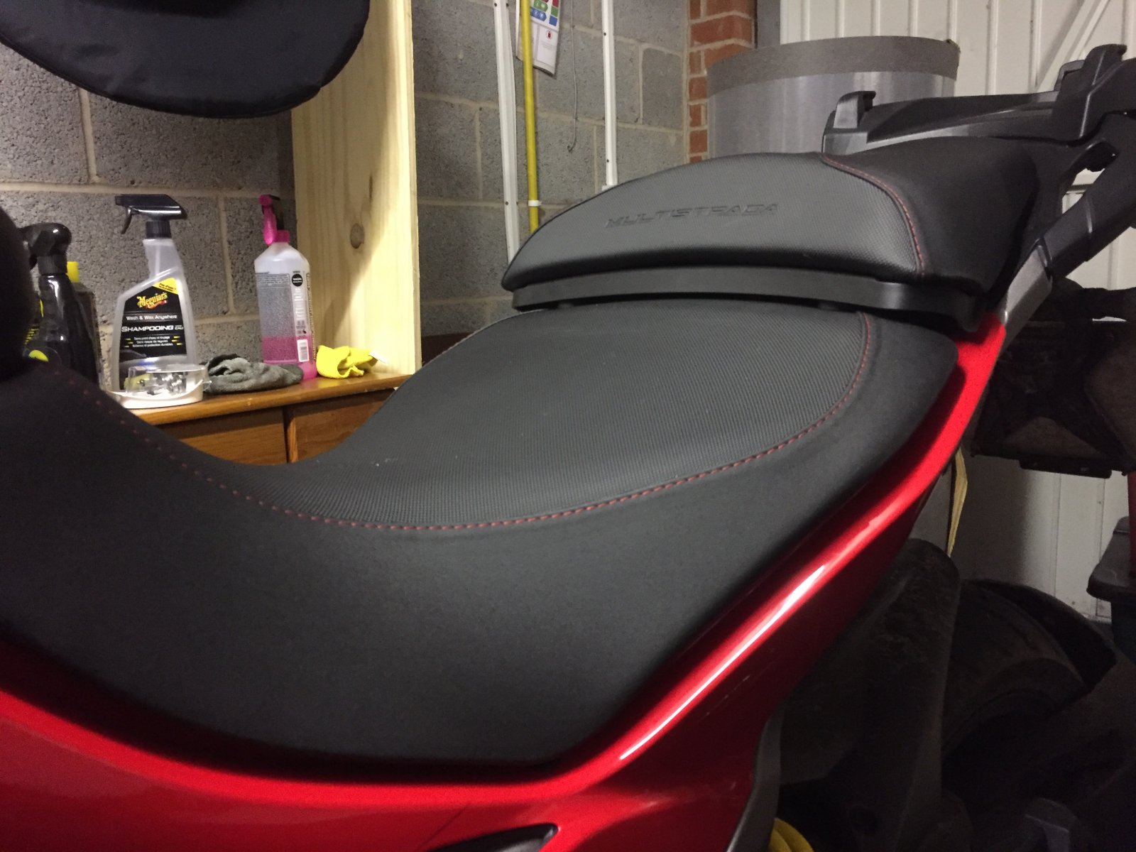

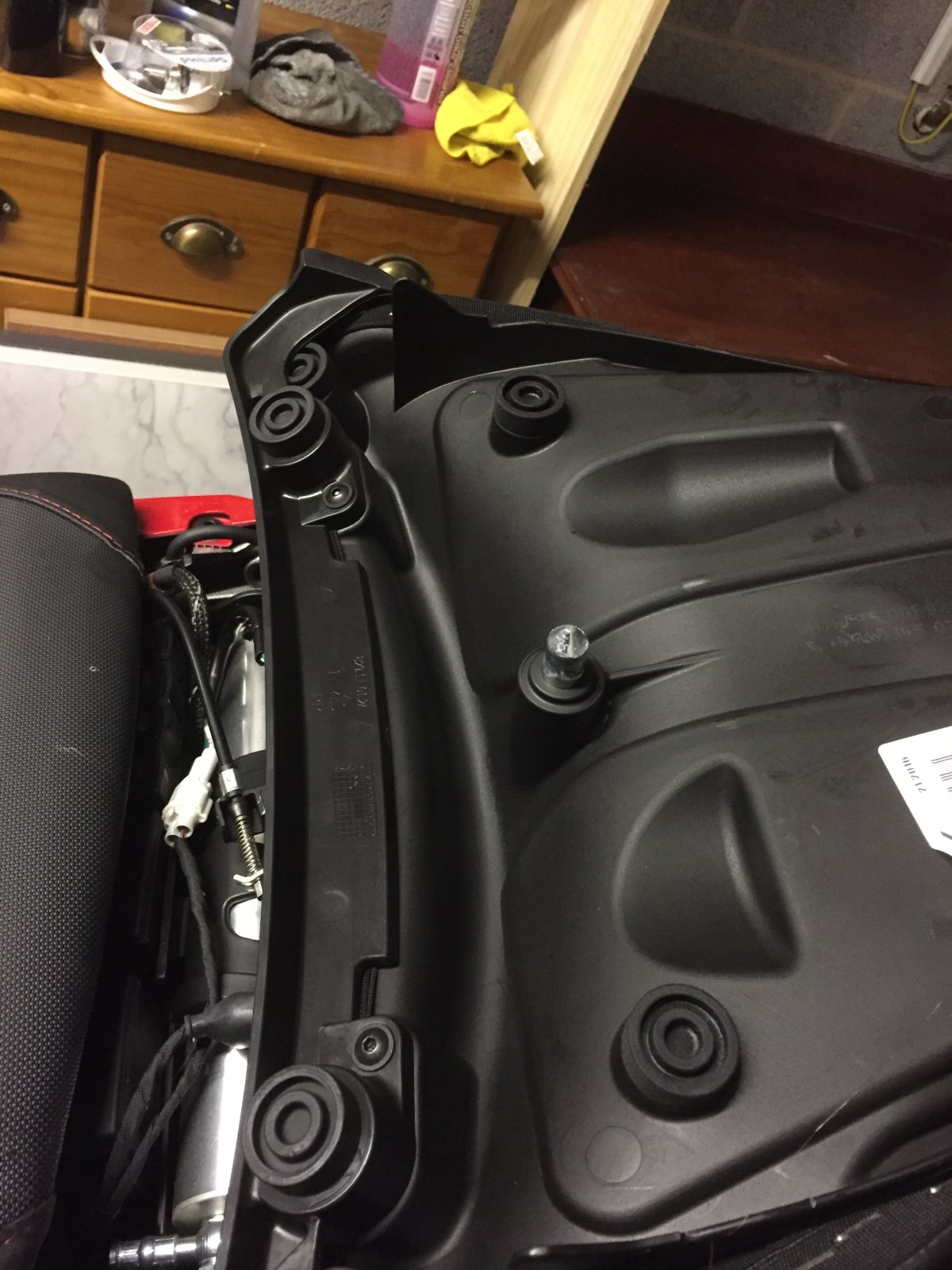

  16. Here's mine on the low setting: IMG_0914.JPG IMG_0913.JPG IMG_0912.JPG IMG_0911.JPG IMG_0910.JPG IMG_0909.JPG

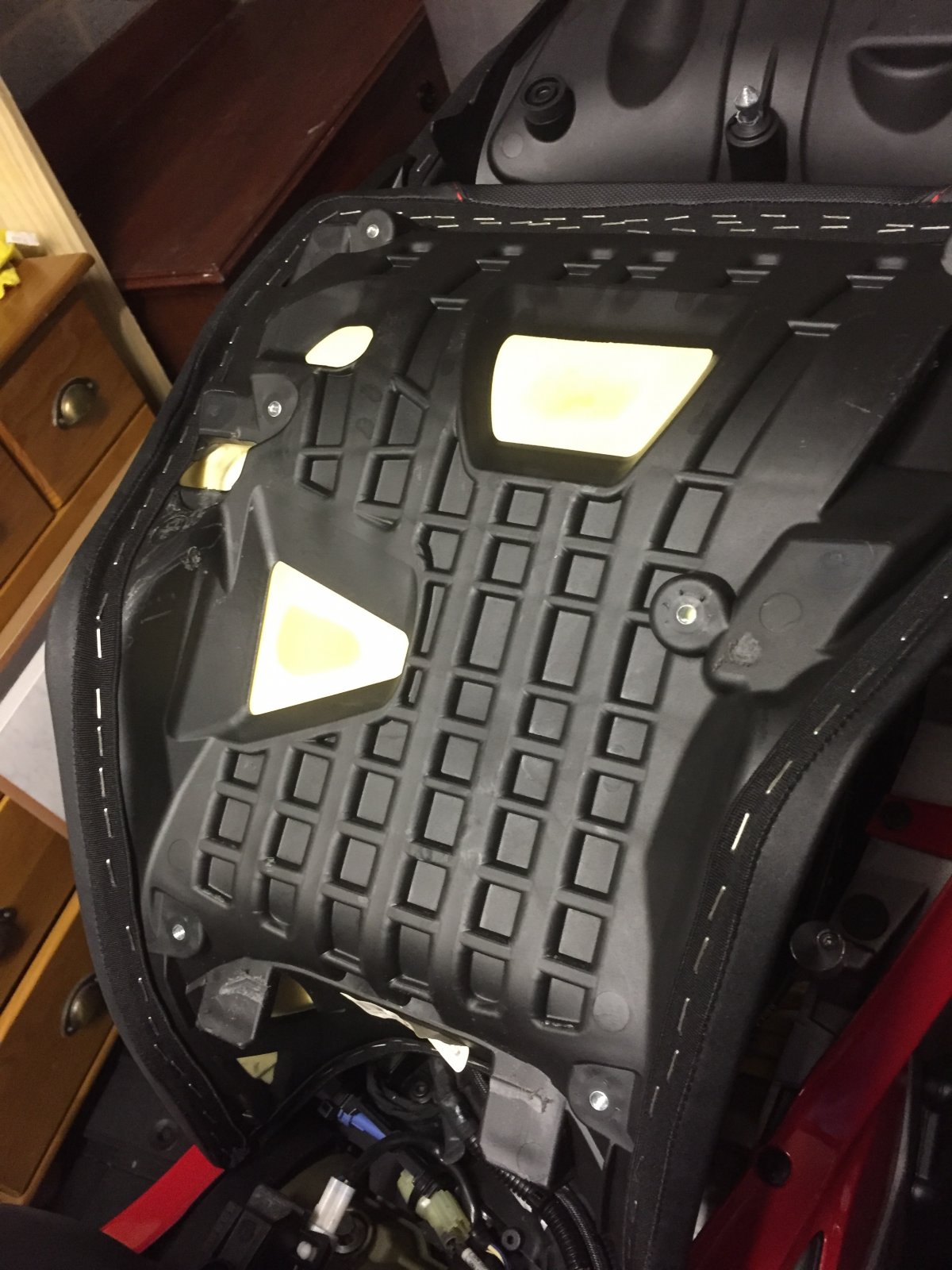

  17. You've not uploaded a shot of the underside of the driver's seat. Having looked at mine, can I ask, taking off the driver's seat and turning it over - do you now have six vacant screw holes? If not, you should have.
  18. Funnily enough I thought the same thing and so after taking the photo I tucked the wiring down so it was lower than the standard bits an pieces but it made no difference. Thanks for your input though, I'm really grateful.
  19. Yes, I have the six vacant screw holes from where I removed the front and side plastic bearers. Thanks for your reply, any and all suggestions are gratefully received.
