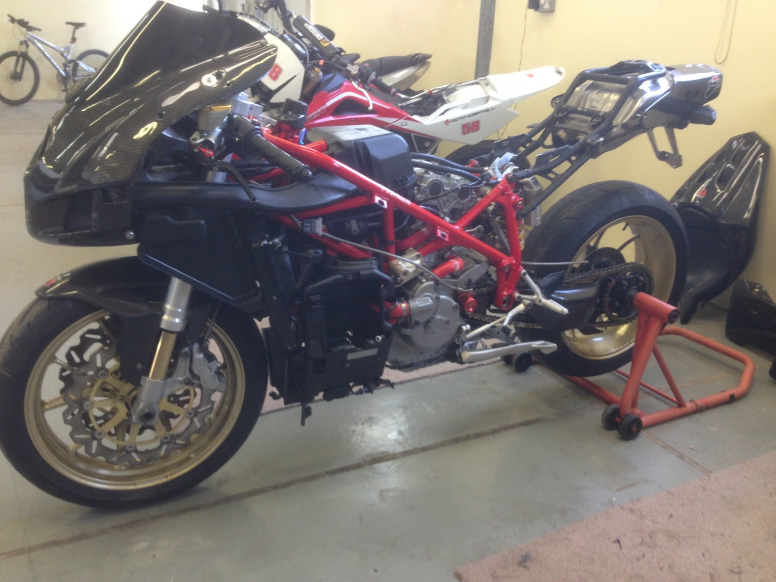

  1. Hi guys. I've bought a uncareded for 749 whilst I'm here in Cyprus with work. The bikes seem to get a pretty hard life here and it taken some work to get it presentable again. The swing arm is I think from a 748/916 but I'll happily be corrected. My question is to do with the shock. It's past it best although not leaking sonlooking to change it. I think it's a 749 oem. What can I change it with? I think 748 and 749 are the same length with a stiffer spring for the '49

  4. Here you go. Had a few issues with connections. It's not so stable out here.

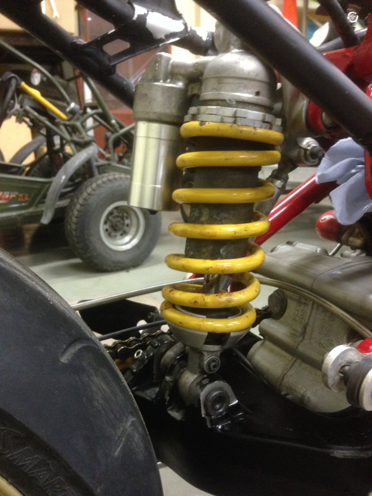

  5. Shock is 295mm eye to eye so looking for a shock to fit. I think the 796 may fit. Brought my road 749 shock and it was too long. Bugger. eBay here we come. ( unless you guys have a better plan!)
  6. What was fitted Simon? I know quite a lot of ohlins and nitro ones can be length adjusted
  7. I thought it was an oem 749 Sachs but it measures at 295mm eye to eye so not sure. I wanted to try my old 749 road shock that came off my race bike ( Grey to black swing arm) but that's too long at around 310mm ( I need to measure that again to be sure )
    I know that the 796 has a 295mm shock but rather save money than spend!
