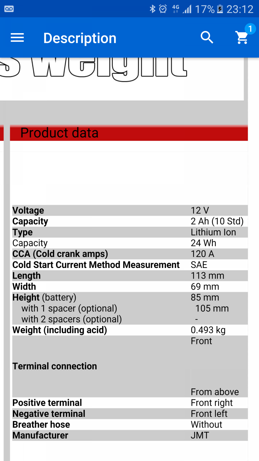

  3. Hi Andy I can only use a battery of this size- Screenshot_20170211-231256.png
  4. Mmmm, that's why you're struggling, 2Ah isn't enough. Shido do a very similar battery but I don't know how it would compare to the one you already have. My 1098R isn't that happy with a 4Ah battery even with ExactStart cables which have made it a lot better than it was. Andy
  5. Ah is not a measure of capability of turning an engine, CCA is.
  6. But it is an indication of how long it will crank for and how long it will take to recharge.
  7. The YTZ5S has half the CCA of the LTX-14 BS, 120 v 240. So the answer is still the same, the OP's battery isn't man enough for an 1199, especially in cold weather. Andy

    What is the spec of a original 1199 battery?
    I have found one that will fit and has 215cca???

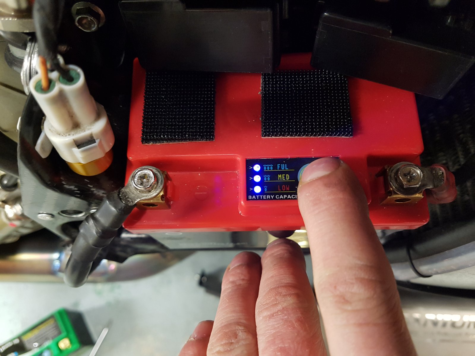

  14. I also have a Magneti Marelli on my 848. I have never seen the charge indicators as the battery is well hidden. It weighs about 600 grams. Never had any problem starting at any time of the year, but the 848 switches its headlight on as soon as the ignition is on so "wakes" the battery before the bike is started.
  15. No gain from corse battery tray Andy,just a lighter wallet.it was more a case of it had to have it because I was building as close to a sbk as I could(well I still am)
    The two batteries I have been using also have the 3 LED indicators, this is what's telling me the battery drains when I turn ignition.
    I may try the temperature angle first
    And get multimeter on it to see what power it's taking from the battery when turned on.
    Then I may try a larger CCA battery but as stated space is extremely tight
  16. Other battery showing full until key is turned then it's just clicking.
