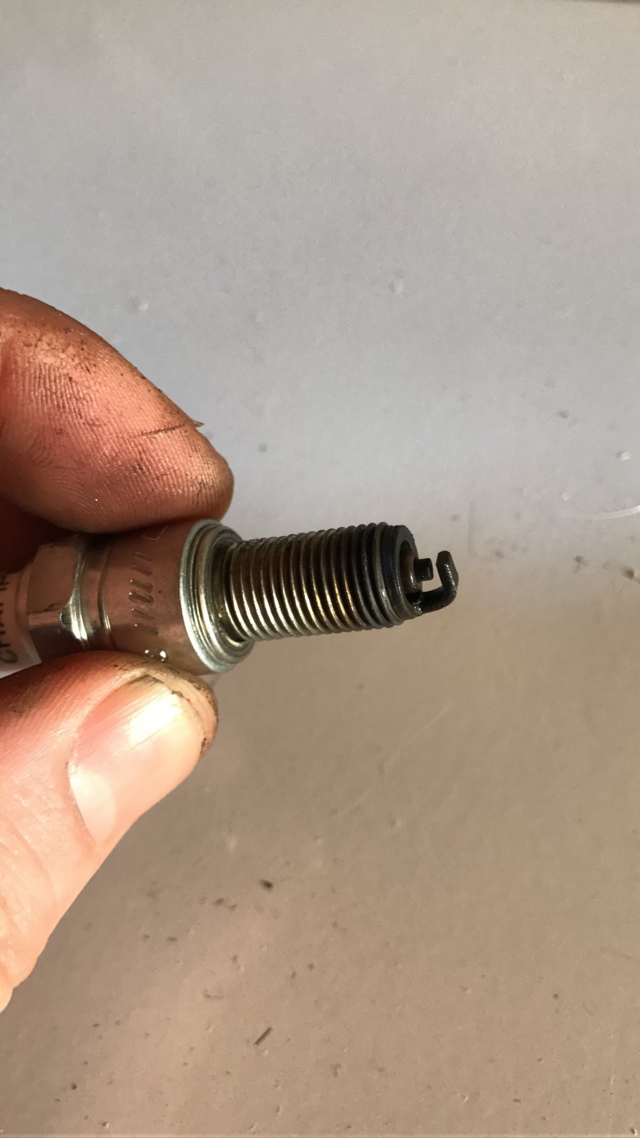

  8. So I got it out and it was black at the end so iv cleaned it off, going to test it once my boy is up from his nap, if there is water in there what would that mean? It's funny because on the service sheet it says they put in 2 ngk plugs however it's a bloody champion that's in it, so now I'm going to have to check the filters aswell, safe to say I'm not happy, what are the air filters like to access?
  10. Bit of a pain but not to bad.
    Sides off - nose off - take off the air tubes. Not a big job. Should be 30 mins.......
    (should).
  11. You will need a long Allen key to get the air tubes off.
    Refitting the nose fairing is a fiddle due to having to get the indicator wires back in neatly.
    Otherwise not too bad.
    Water in there would be from riding in bad weather is all but could affect plug and coil performance
  12. Just make sure you don't over tighten the bolts holding the air tubes to the air box .... because the captive nut can break free, and then the bolts just spin and will not tighten or loosen.
