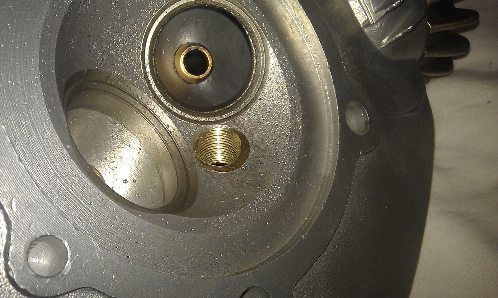

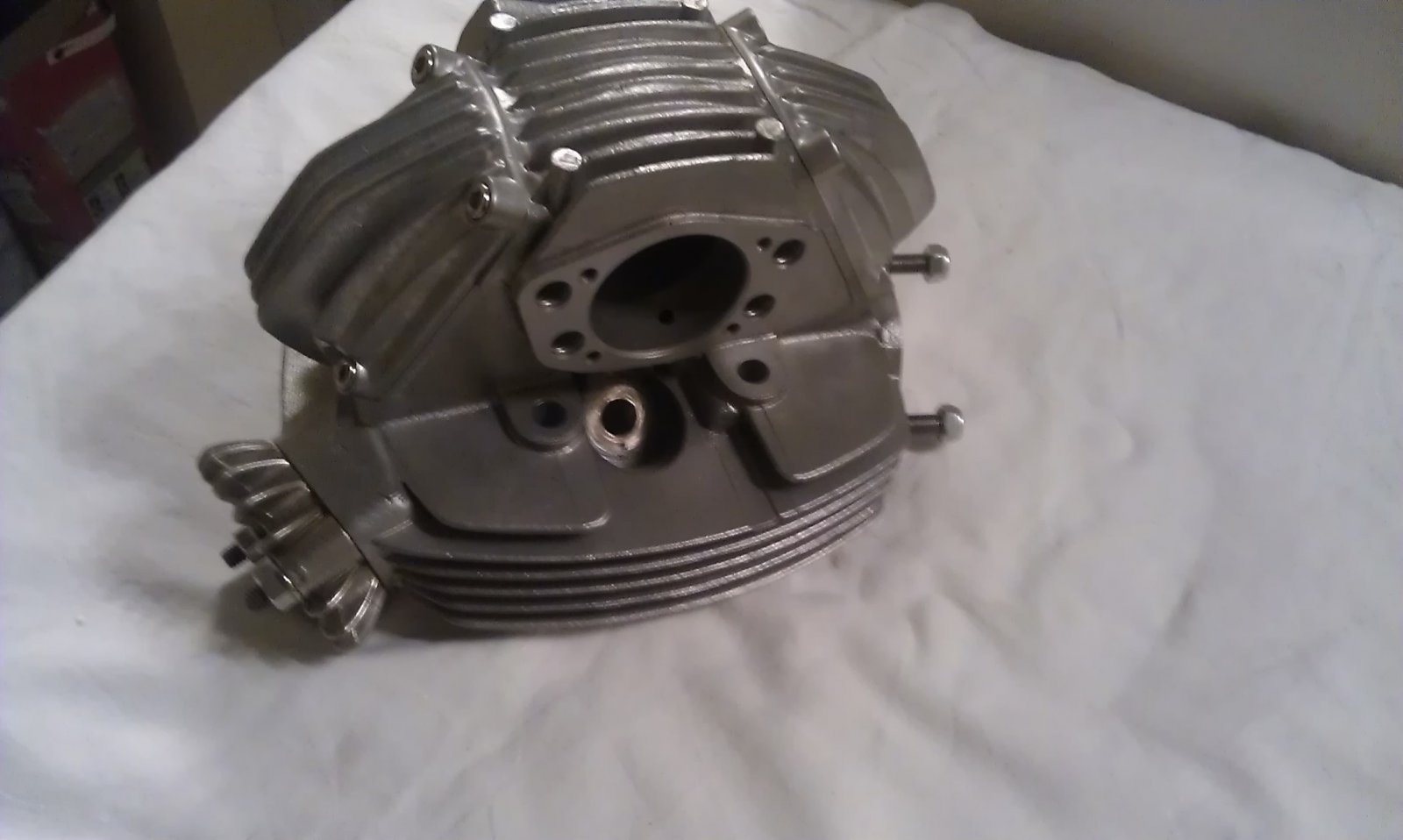

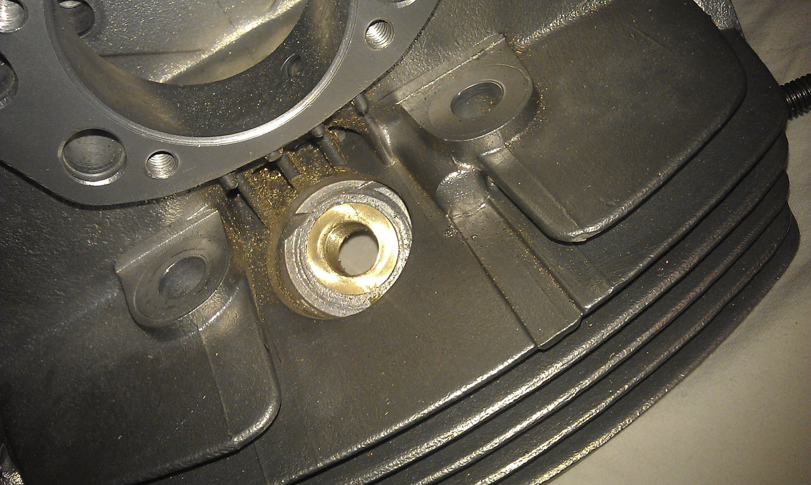

    Collected that rear cylinder head today, with the sparking plug thread fixed. BLR managed to get the bronze insert in without fouling the valve seats.
    Now I have left with BLR my collection of footrests and brake/gear levers (all steel on a Pantah) some of which need straightening and/or welding to get them right before I have them chromed.

  8. Incidentally the standard plug thread is 14mm diameter and 12.7mm long (i.e. 1/2 inch short thread). I have arranged for the new thread to be 19mm long (i.e. 3/4 inch long thread). So with NGK plugs, it will now take a BP7ES instead of a BP7HS.
  9. was it supposed be off center? not being a smart arse, just interested.

  11. I would guess the insert is located off centre to miss the valve seats, then the thread put in the original position :upyeah:.

  13. No, the insert is not off centre. What BLR have done is bore the hole centrally but carefully, stopping short of full depth so the bore-hole does not quite go as far down as the valve seats - it is in effect a "blind" hole. The alloy of the combustion chamber is left undisturbed on that side. The bronze insert is screwed into the full depth of the hole, and also pinned in place with a small axial pin. Then the plug thread is tapped centrally in the bronze insert and in exactly the same position as originally, but now 3/4 inch long instead of 1/2 inch long. The new thread must be at least twice as strong as the original was when new.
  14. Ah yip, i see that now, deffo no worries regarding strength.
