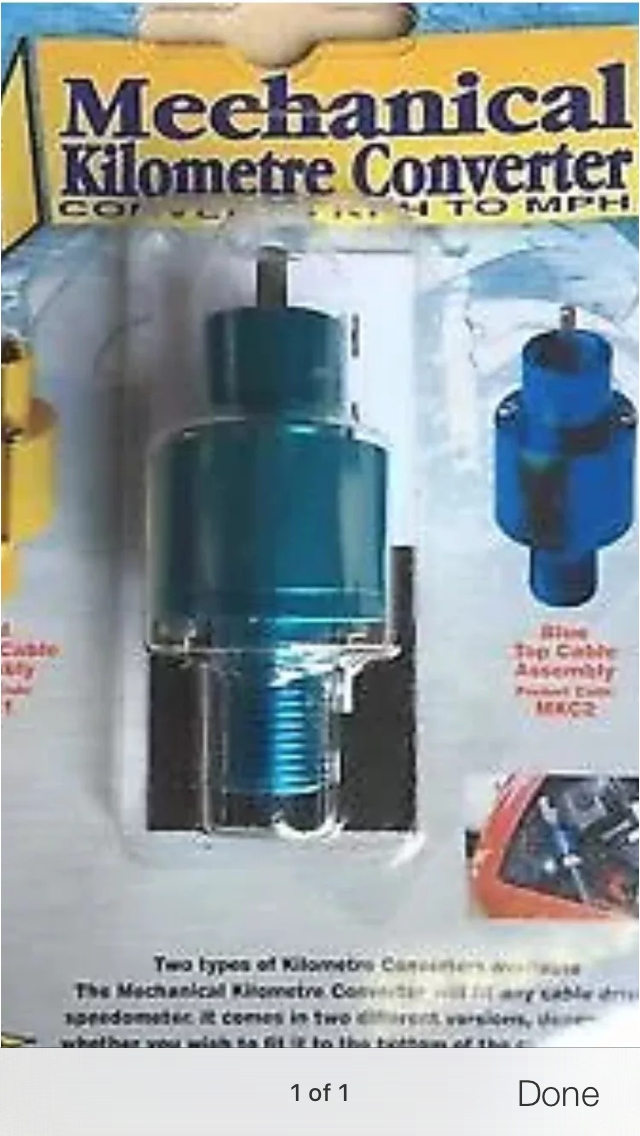

  6. These go between cable and speedo. I have one on my 907. Works well. I use the gold type that goes on the bottom of cable. I have blue type(top) spare if you want to try one. image.png

  8. For an MOT, you probably don't need to do anything. They don't ride the bike or even test the speedo and so wouldn't actually know if it reads in kmh or mph despite what the writing says, as how would they know if it had a 'healer' fitted in the cable?

  12. But if you were to use a 'speedo healer' that slows the cable drive by the relevant percentage (as above) then the same kmh speedo would effectively be recalibrated to display the true speed in mph, how would they know?

  15. My recently acquired ST2 has Kph clock displaying speeds in Mph. Does anyone know where the healer is usually located as I need to remove it?
