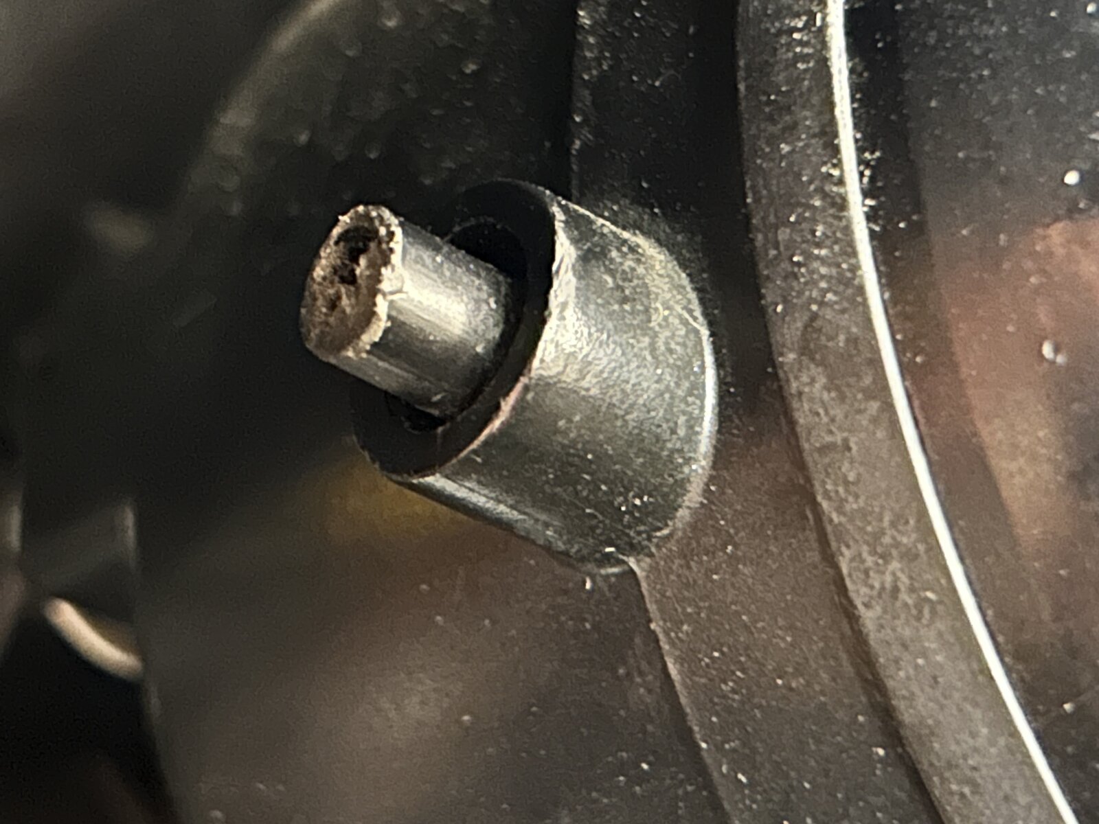

  6. dredging up this for a related question. my knob just fell off while pushing the bike along.apparently, it seems to have broken at the brass shaft. while out, I unscrewed the knob from the brass shaft. Does anyone have any ideas on how to fix this? I'm assuming that I have to take the speedo apart but from the research I've done, it doesn't appear to be an easy task.

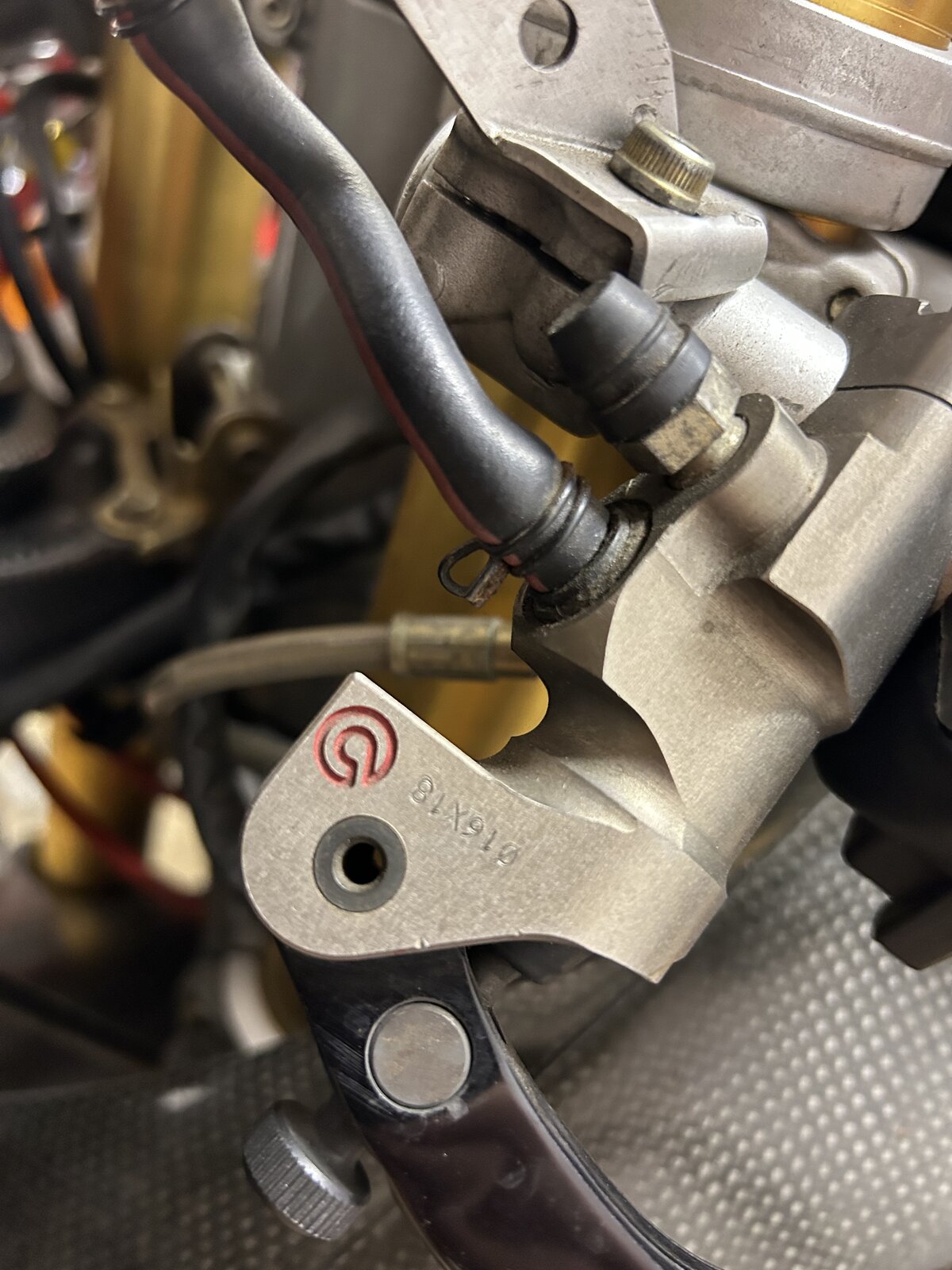

  7. My shaft doesn’t have a knurled knob on it either. I can just about get enough purchase on it to zero the mileage, but it isn’t exactly easy.
    I will check to see if anything is interfering as my 996 SPS has a few non-OEM parts fitted.
  8. So looks like I have an upgraded clutch MC that fouls the instrument pod, so the knurled knob has been removed.
    It still works, just takes a bit more effort.
    I believe there might be an MOT issue for lack of steering clearance.
