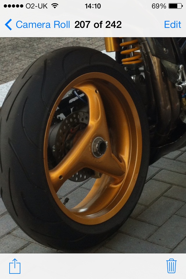

  13. I rattled canned some 999 wheels with Simoniz Satin black. Worked a treat and hardly chipped
  14. That's the stuff, 2 cans are enough.
  15. Both wheels?
  16. Yes
  17. I spray my own wheels. I have a compressor and guns but prefer to just use rattle cans. Strip off old paint with paint stripper from car paint place, etch prime, then two cans of paint for the pair. Then clear coat. The paint i use is vht engine paint, even without baking gives a really good resiliance to chips. It's all about the prep, next pair to paint will be in anodise effect on the Monster. image.jpg
