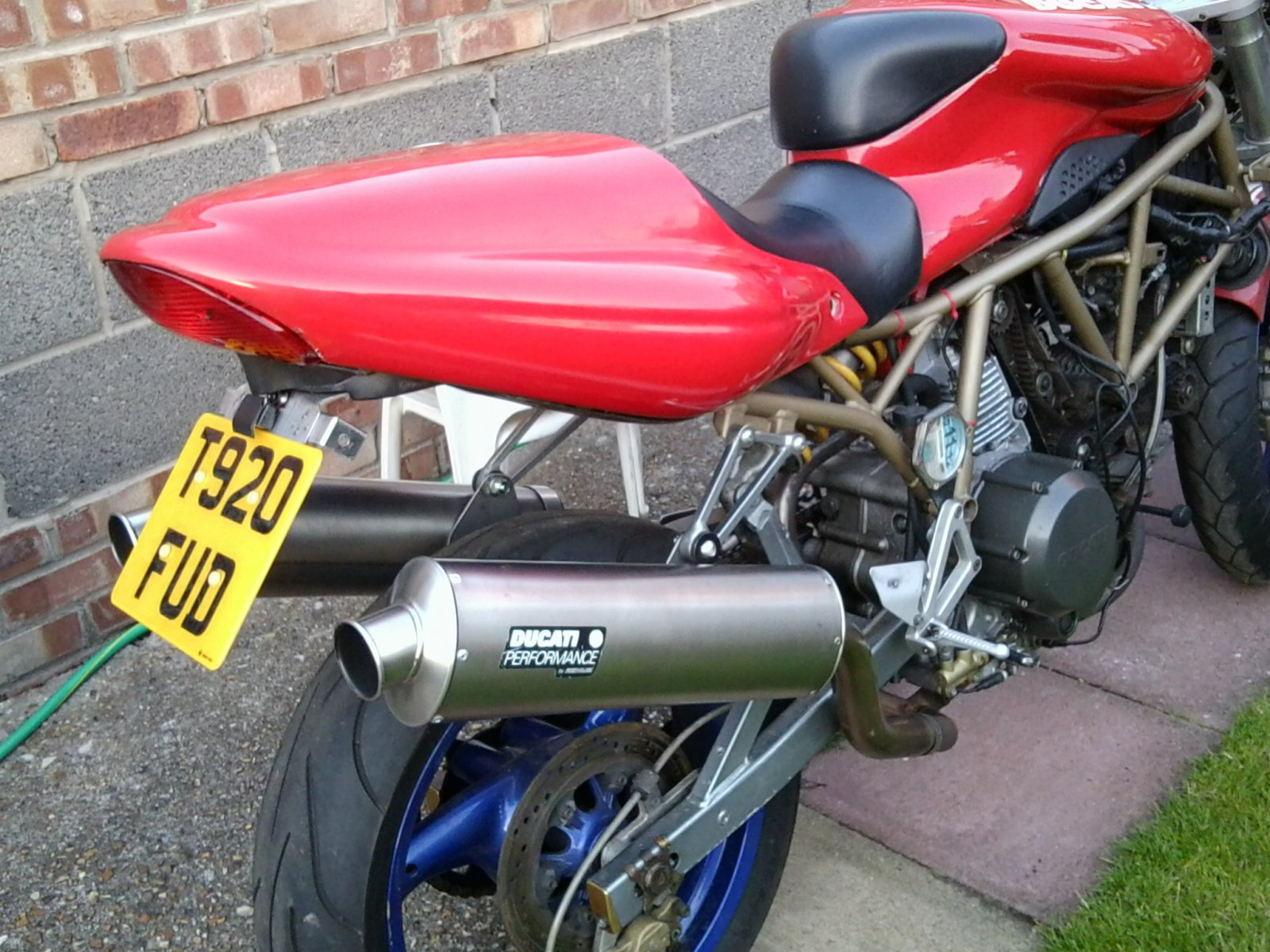

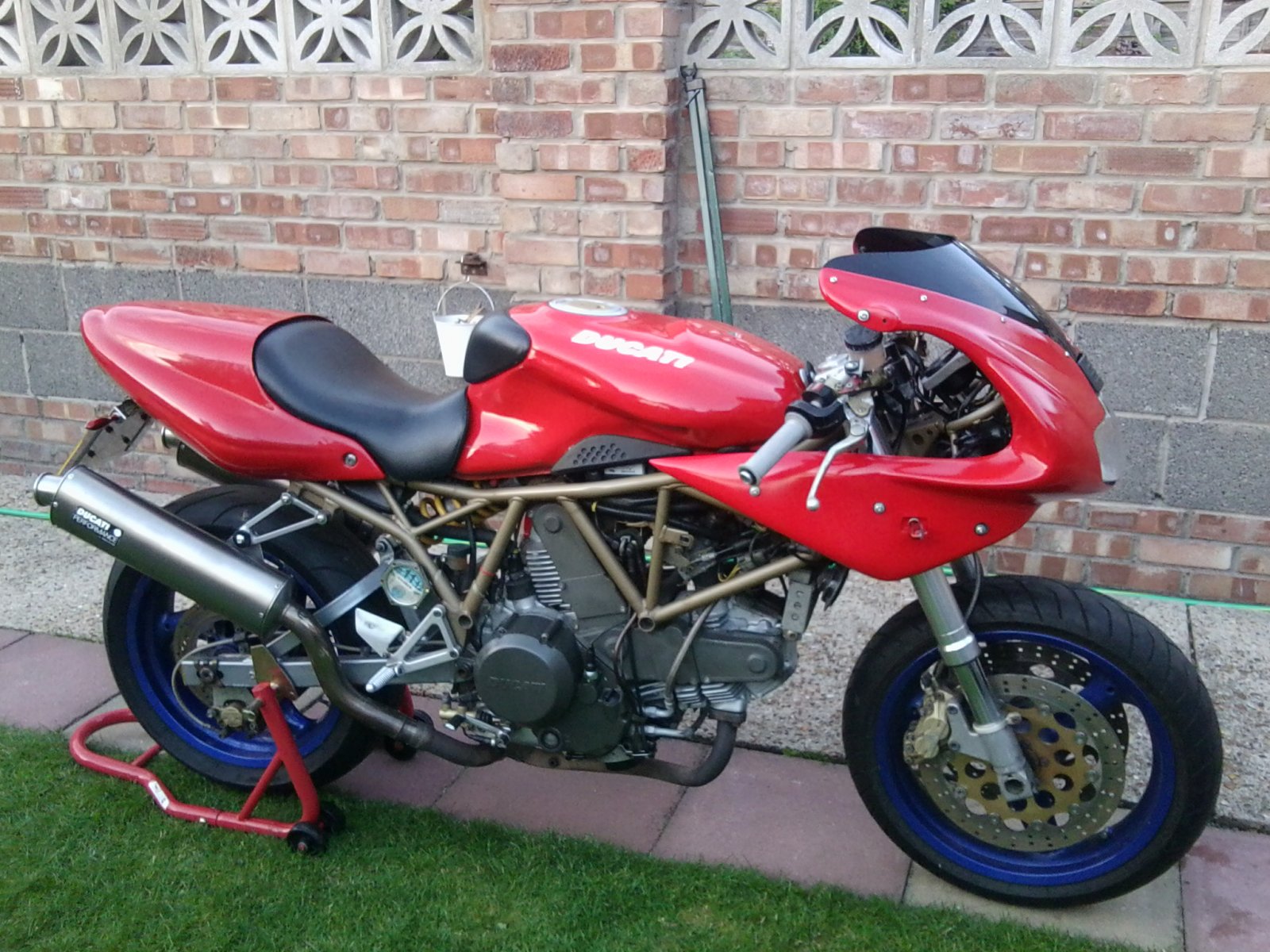

  2. have you any pictures of it you can post up?
    the one fitted on mine has two bolt holes one on each side
    which line up with the mounting bolt holes for the side panels
    has cut out for the rear light but have found it does rub on the lens a bit and you need a modified grab rail mount
    ie cut off the grab rail

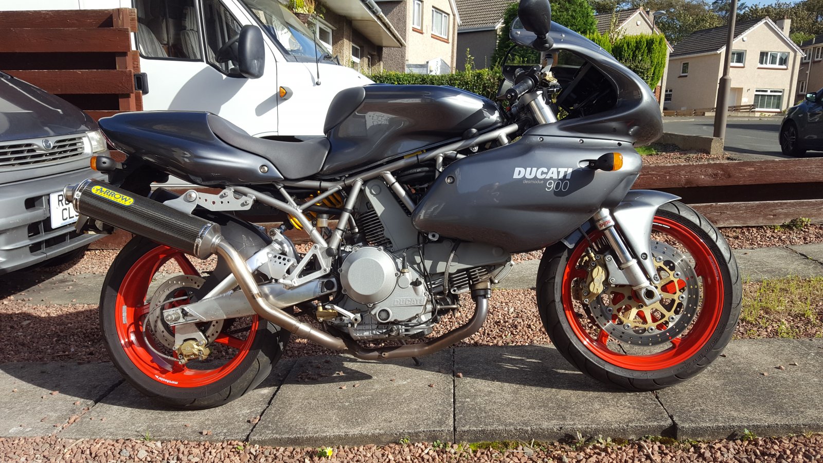

    It just rests on the seat

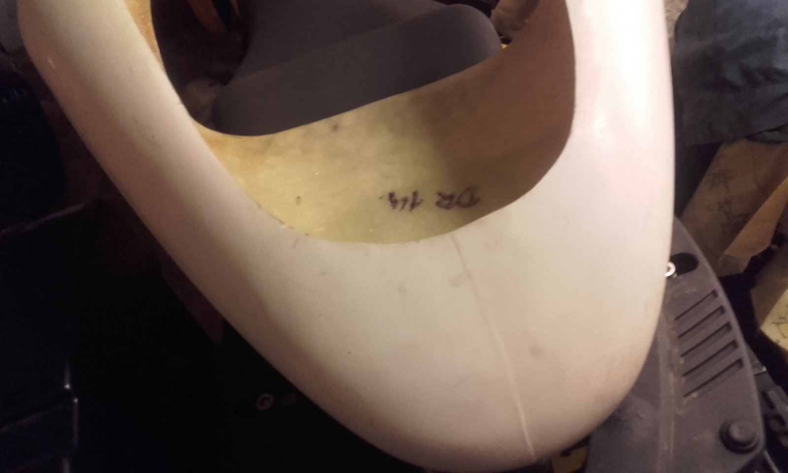

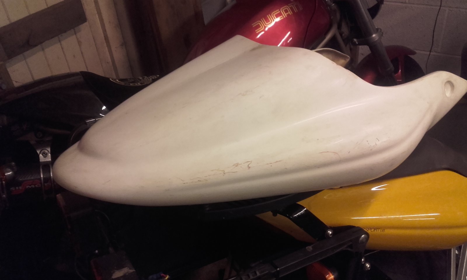

  5. pics of what I have
  6. Bit of work to do there
  7. think I have seen a seat unit like that before on the net
    I would say that is more for changing to a race set up ie no lights etc
    the back end stays down as the unit has to be slid on from the rear and curves round underneath at the sides preventing it from lifting
    guess you could trim what you have to fit like the item I have but a bit of work
    mine has some foam strip stuck on the underside at the front edge to help it seat in place aswell
    think ricambi Weiss site have them on aswell don't know if any good pics for referance
