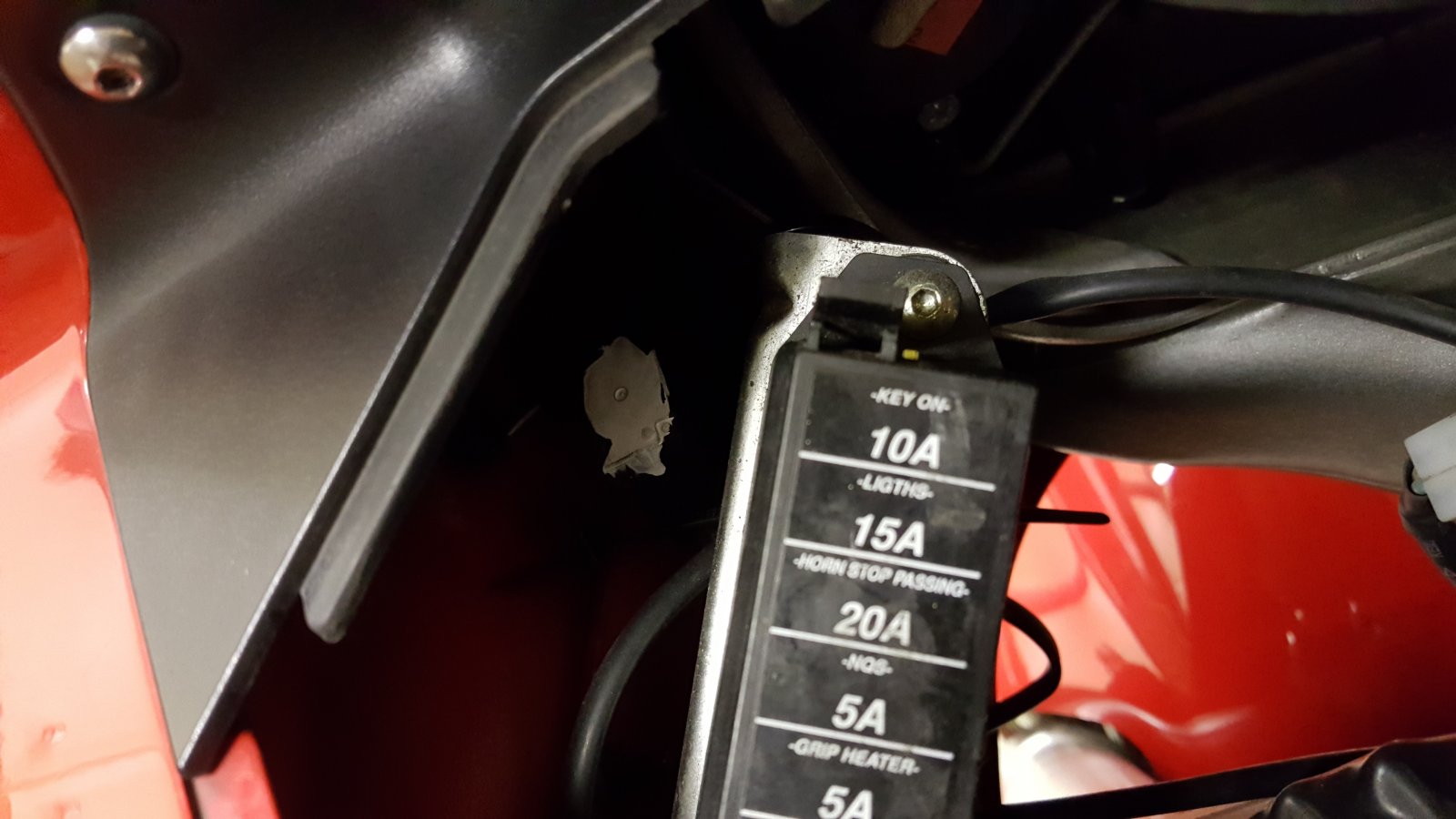

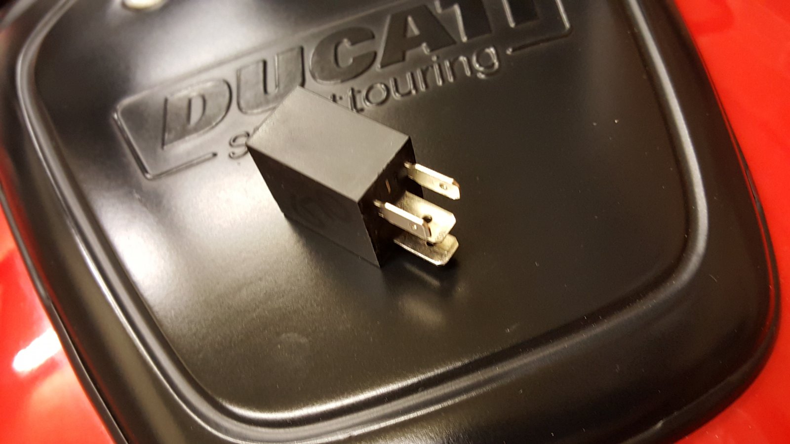

  7. Hi the relay has the white paint on.
    it's kept here or there abouts.
    Sample of one on my tank,so you know what you're looking for.
