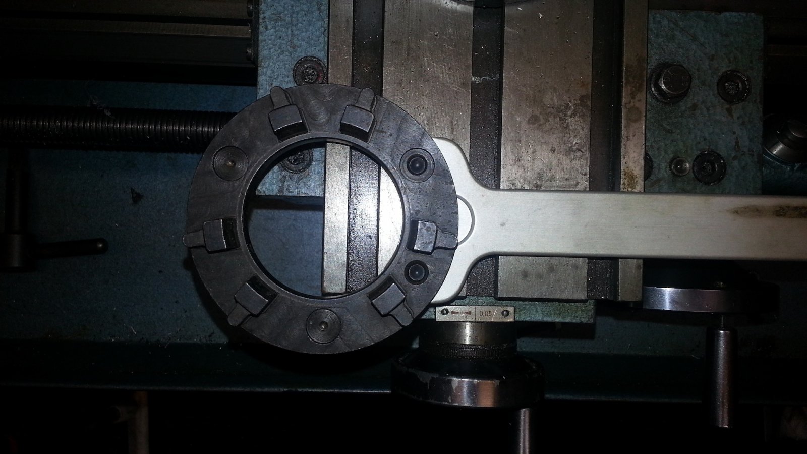

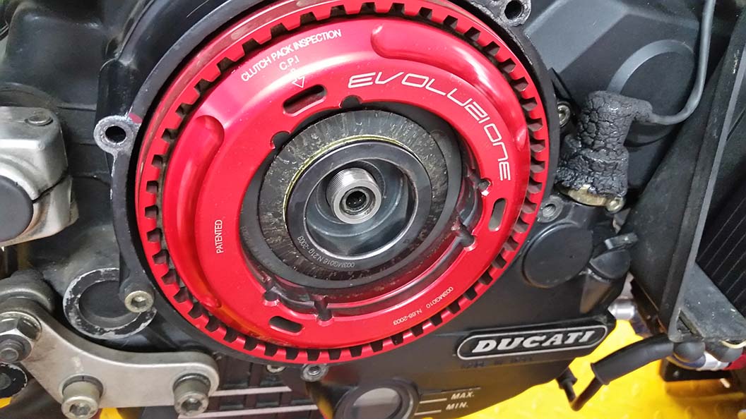

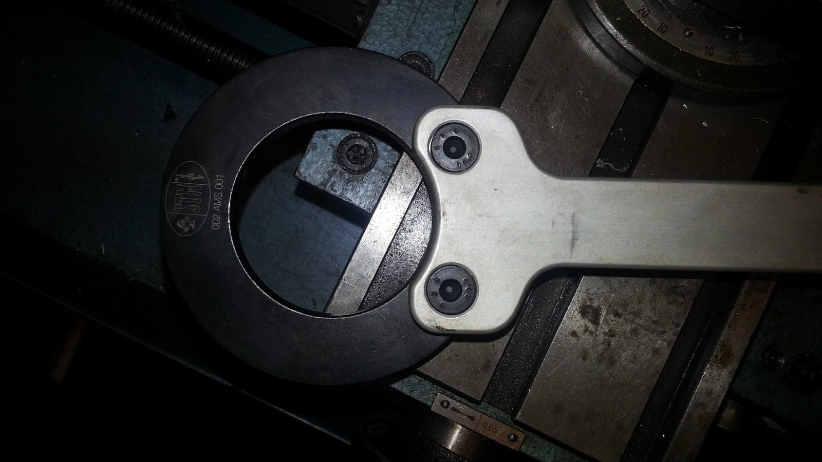

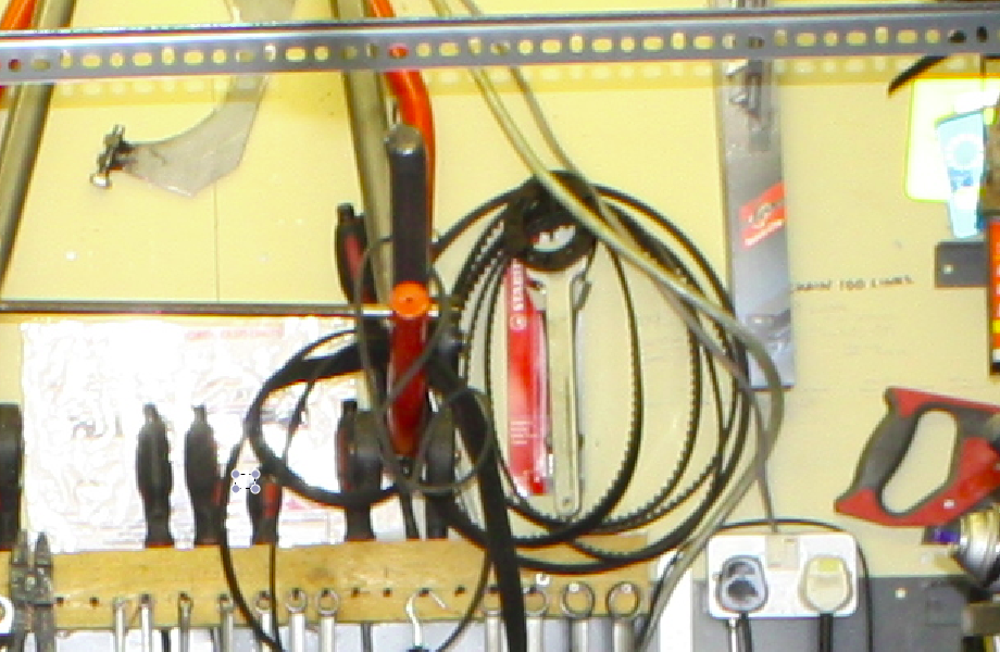

  2. I use this clutch and yes I had to buy the expensive tool. Couldn't see any other way to do it without one . I can get some close up pictures of it if you think you can reproduce it . There it is hanging up at the back of my garage.

  3. Cheers.
    May have to buy one of the buggers! Either that or it's the rattle gun and thread lock!

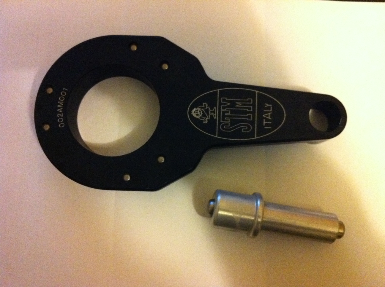

  9. This is the one I have. I actually had two but only one original locking pin (in first pic), so I made another pin and sold the original set ;)

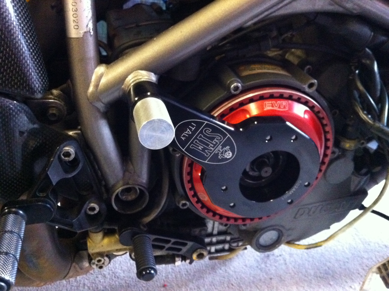

  11. This is mine,

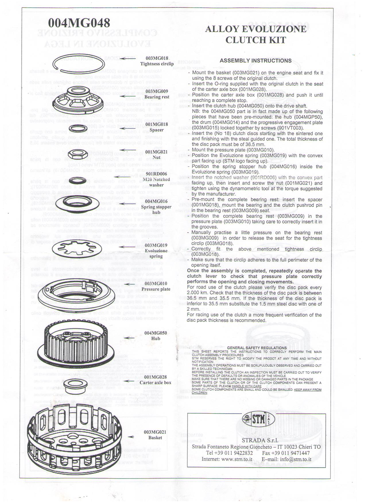

    Parts diagram here:
