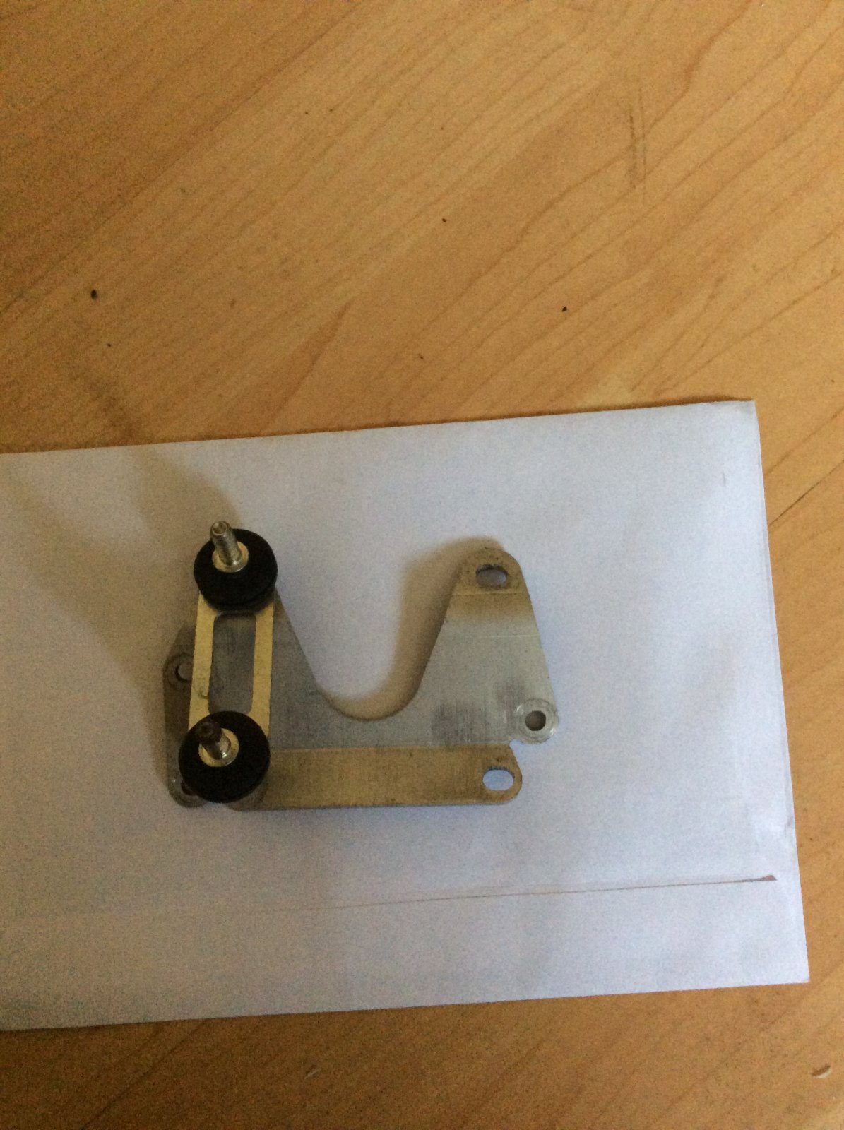

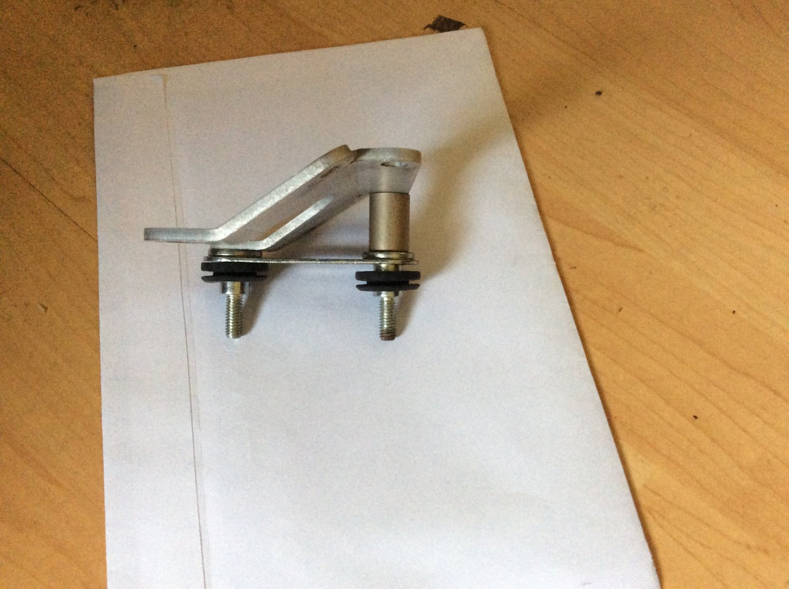

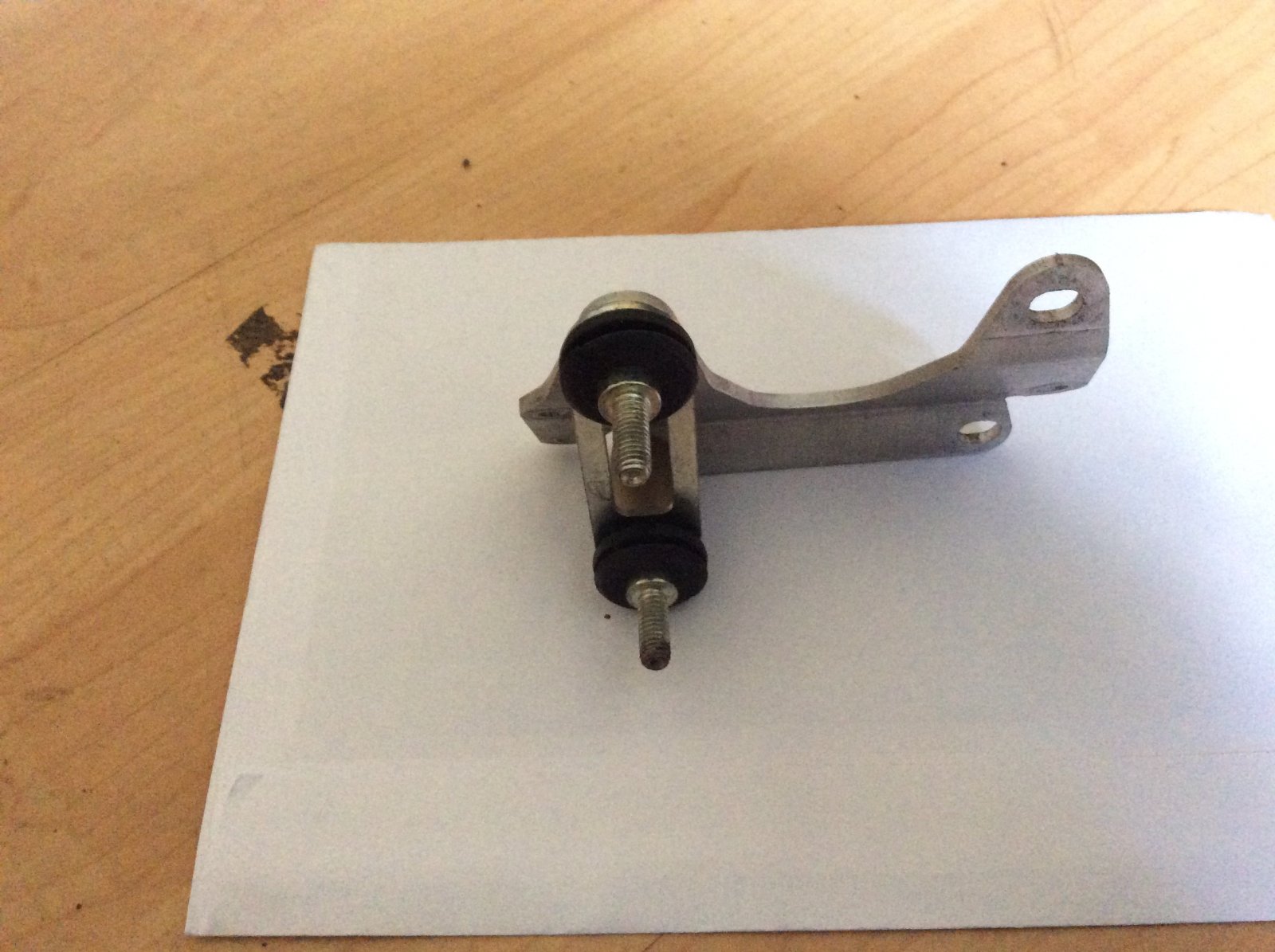

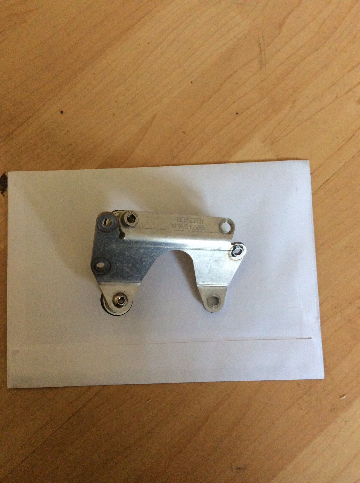

    Another question, does anyone have a picture of how/where the traction control box mounts?
  3. I have a Ducati traction control mounting bracket somewhere which I'll try and find in amongst all the other bike related treasure trove and take a picture. My understanding is that the level is key to its performance. The parts diagram isn't great but should give you some idea. Andy

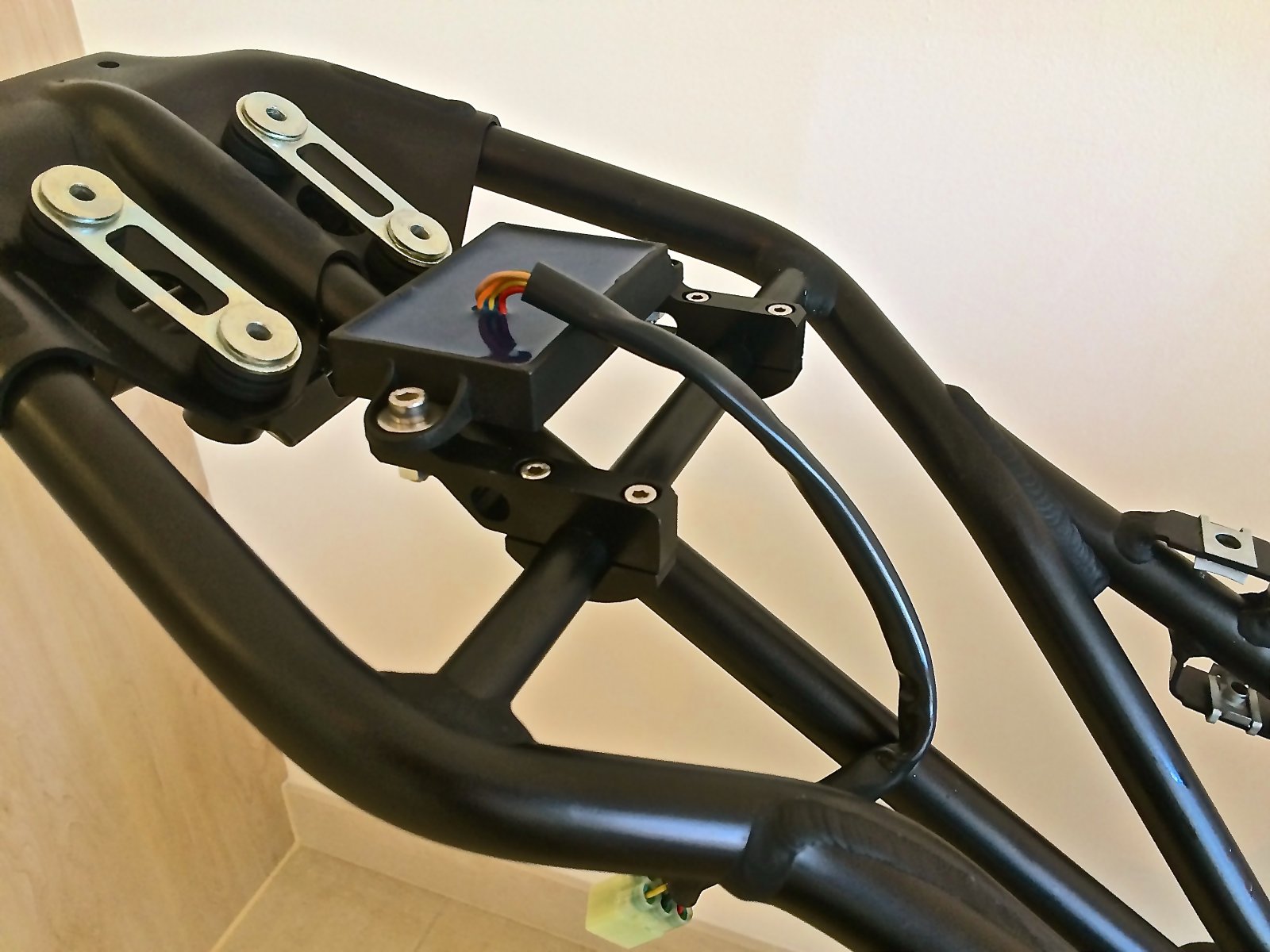

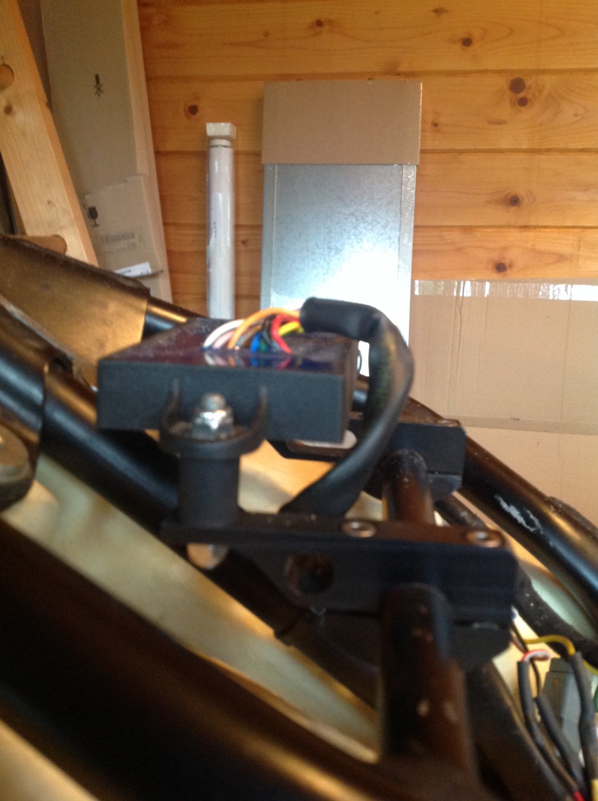

    I have a 1098R subframe and a DTC bracket from BSD - Bike Sport Developments. Works perfectly. Take the time to fit it using a spirit-level. There is a laser-gyro inside it and does require to be level for it to work.
    Ducati DTC and Nemesis TCS mounting bracket
    This is the bracket on my bike:
    My advice to you would be to order the Pierobon frame and ask them to make it without the bracket (probably made to order anyways) and fit the bracket from BSD.

  6. I have one of the BSD brackets.
    The DTC is rubber mounted on mine.
  7. Hmm, never thought about those rubber bits. I just figured they were to bridge the gap through the plastic. Might have to look at that again.

  8. Macca, my apologies. If I actually used half my brain, I'd be dangerous. Photos as promised - finally. Andy
