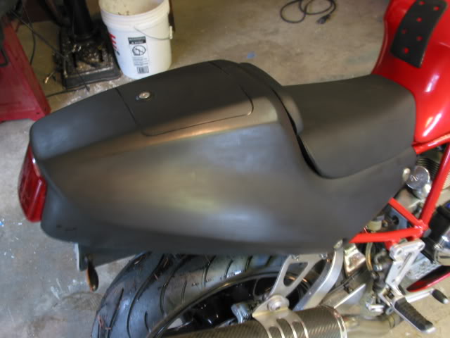

Superlight Single seat unit showing all the brackets etc in place.

  9. So basically the seat unit sits on the frame at the front brackets position and the rear brackets hook under the frame tubes.........
    ........then it is a case of four allen bolts into wellnuts in the normal frame lugs and that's what holds this big lump of GRP in place?
    But even though four allen bolts and rubbery wellnuts are a bit flimsy IMO; you can't get the d*mn thing off quickly enough if you need to.
    So 1) Anyone tried DZUS to hold it on and; 2) Anyone formed a removable panel so access can be gained to the plastic tray underneath??
  10. The front and rear brackets rest on the frame and the four bolts hold it all in place it takes about 2 minutes to unbolt it so as long as you have an allen key its very quick
  11. Anyone formed a removable panel so access can be gained to the plastic tray underneath??
    Don't quote me but was it the 851/888 that had a removable seat back to get in the "hump"
    I am sure it wouldn't be too difficult to cut and add a hinge, and think of the amount of crap you could put in it!
    i might be on to something here?
  12. T'woz wot I woz finkin'.......It could be done so the bum-stop foam pad acts as a seal of of sorts.
  13. It has been done, with the bum stop opening downwards on hinges. I think it was on ducati MS
  14. Found this -Italo Shop Neuss- site. They have a Superlight seat unit with toolbox/tail access. Also have some nice bling for SS bikes.

  17. photo.jpg Superlight seat, woo hoo cheers Paul, my new rear brackets will be superfluous as will my new seat pads, (too deep) will get these recovered, Tank has been stripped out and has been welded previously and POR treated which is now coming away in clumps, need new seals etc until such time that RCV4 supplies a tank :).
  18. Nice looking seat.
    I agree with the comment about the seat pads, it sits you too high, another plus is by using foam you can trim the front of the fibreglass and lift the tank without the trauma of removing said seat..
    how did you attatch the rearmost brackets?
