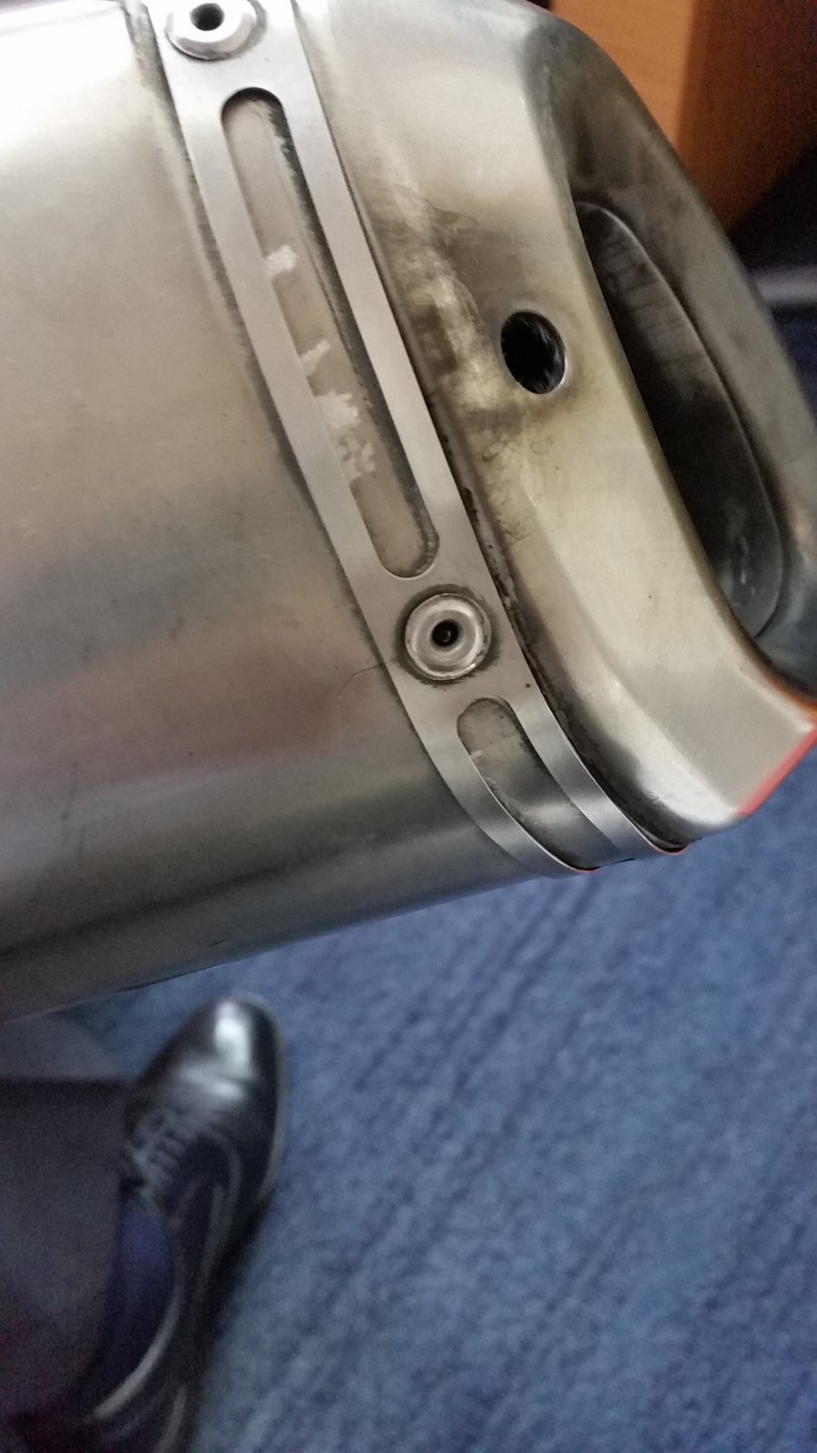

  1. Hello all,
    I think my full termi exhaust - the silencer - needs re-packing, I can hear that its a bit louder and can see a little carbon around the rivet ends.
    can anyone recommend a good place to send it to - I don't fancy doing it myself as it would involve drilling the rivets I think.

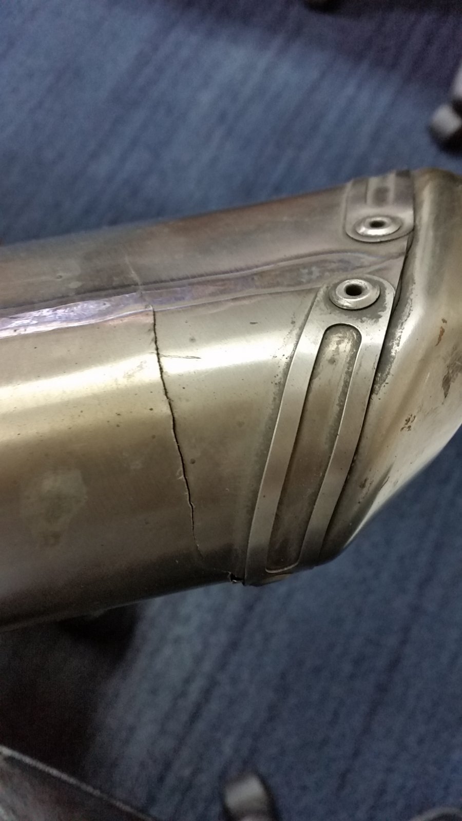

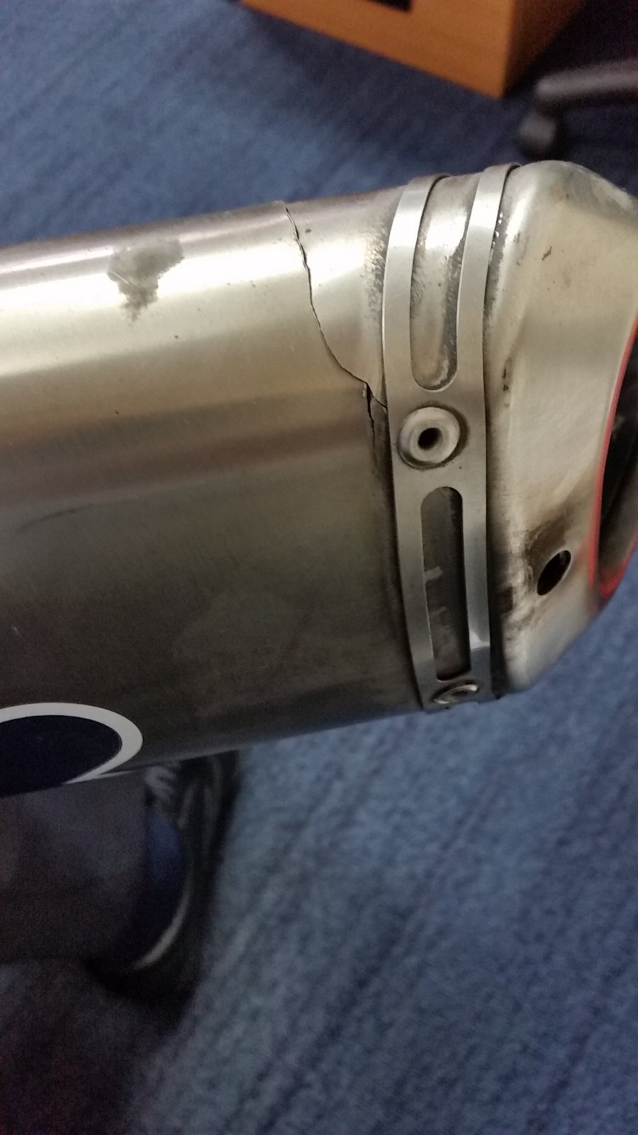

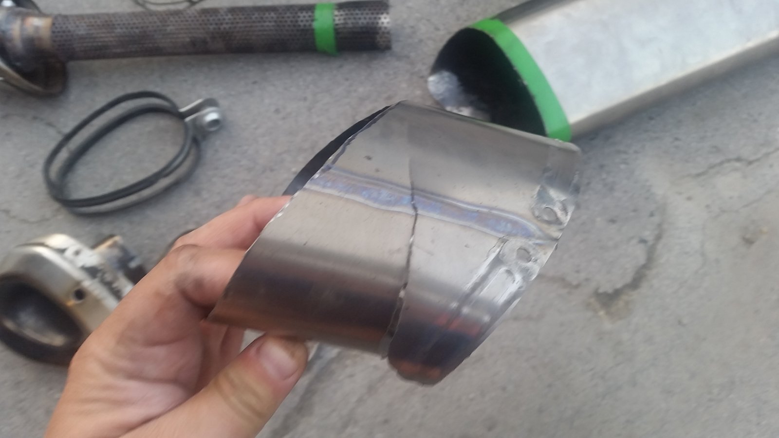

  2. Okkk...so its not the packing, its an hairline crack, a couple actually.
  3. one crack that is creeping and another just started - this is at the out end.
  4. am going to try and open it up, and either weld it or try to shorten it as per others...

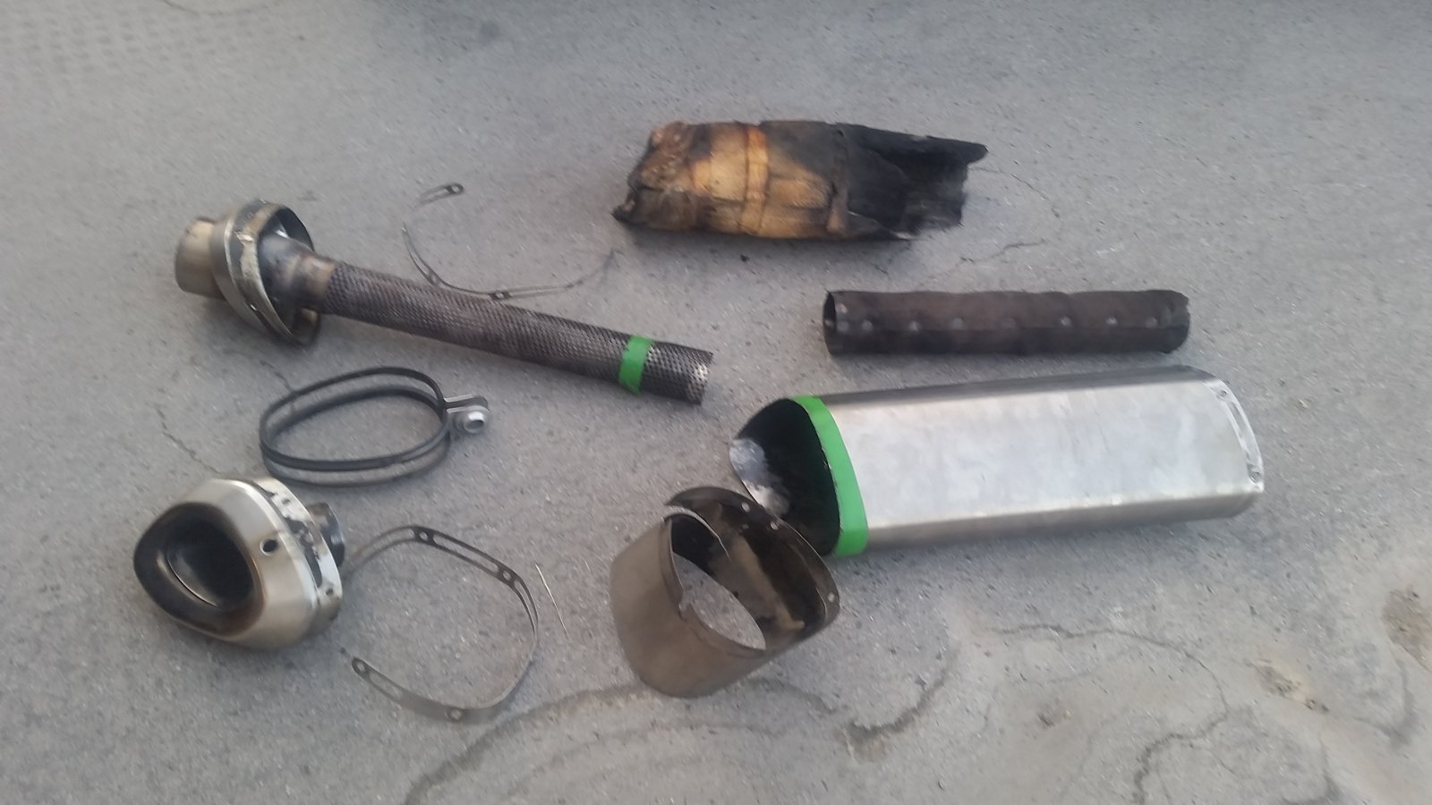

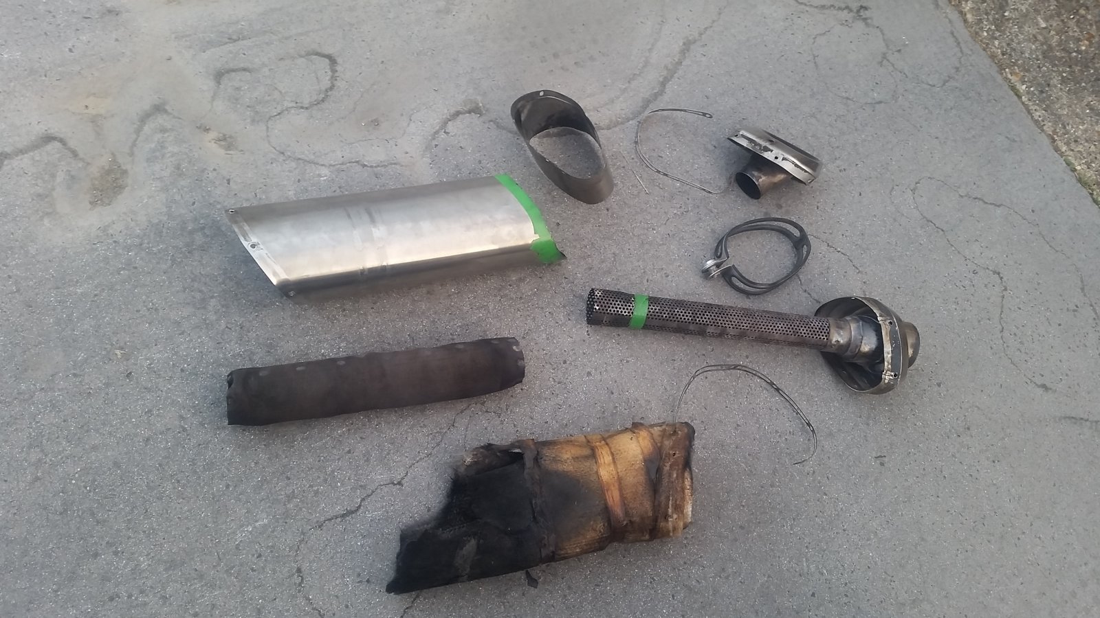

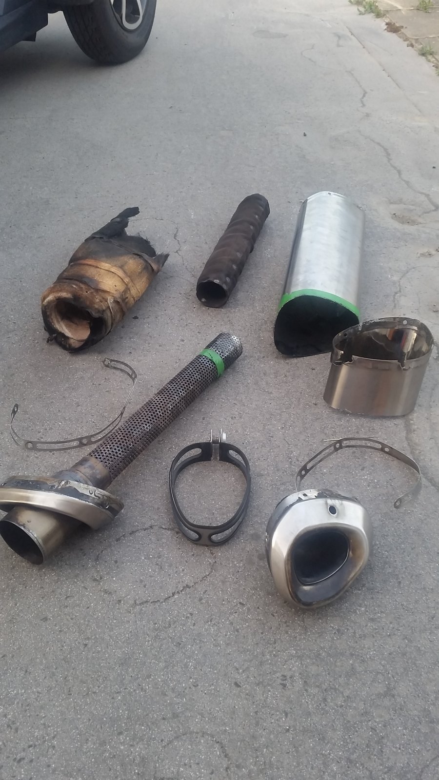

  11. ok after a few go's here are pics of the exhaust parts for anyone who is interested
  12. The packing was in shocking condition as you can see.

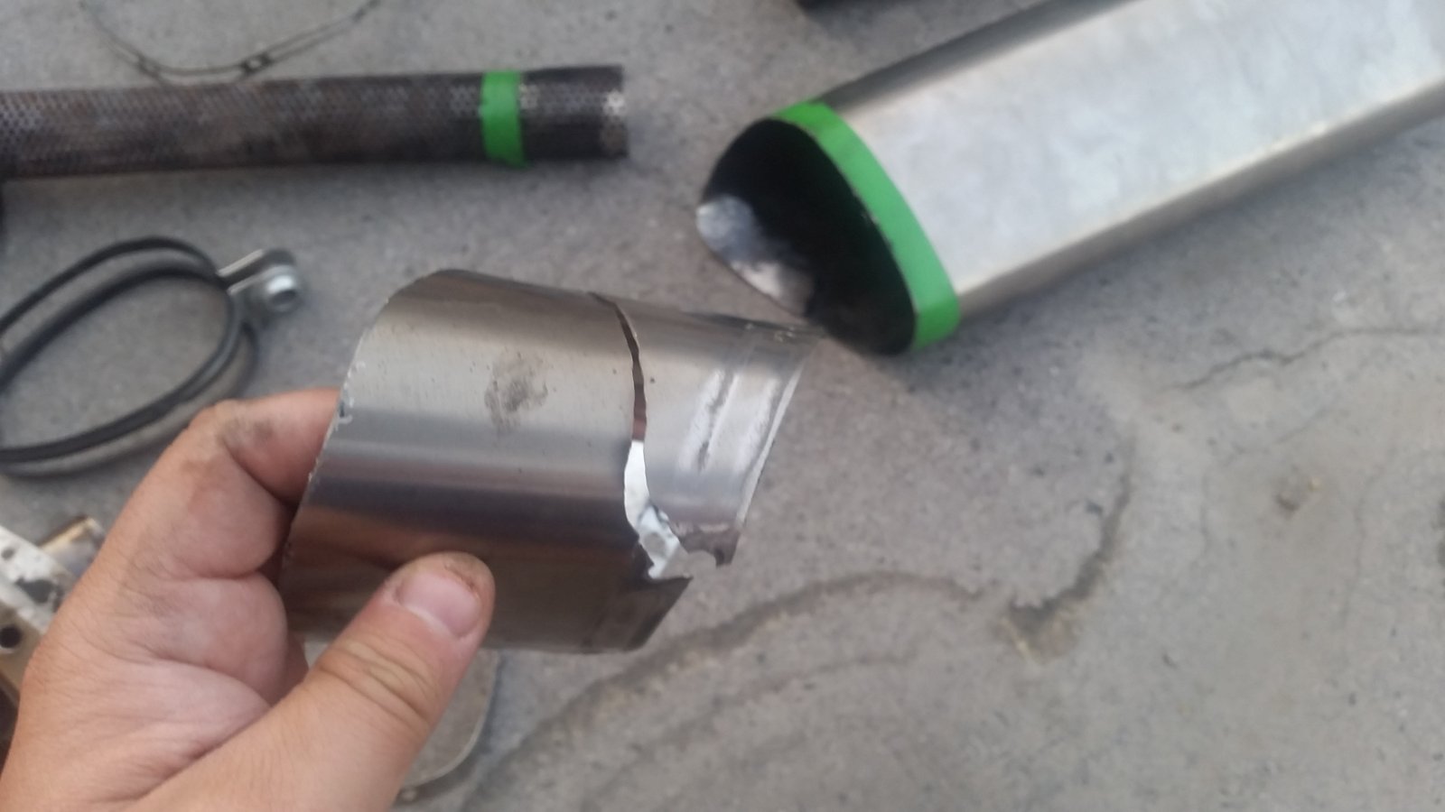

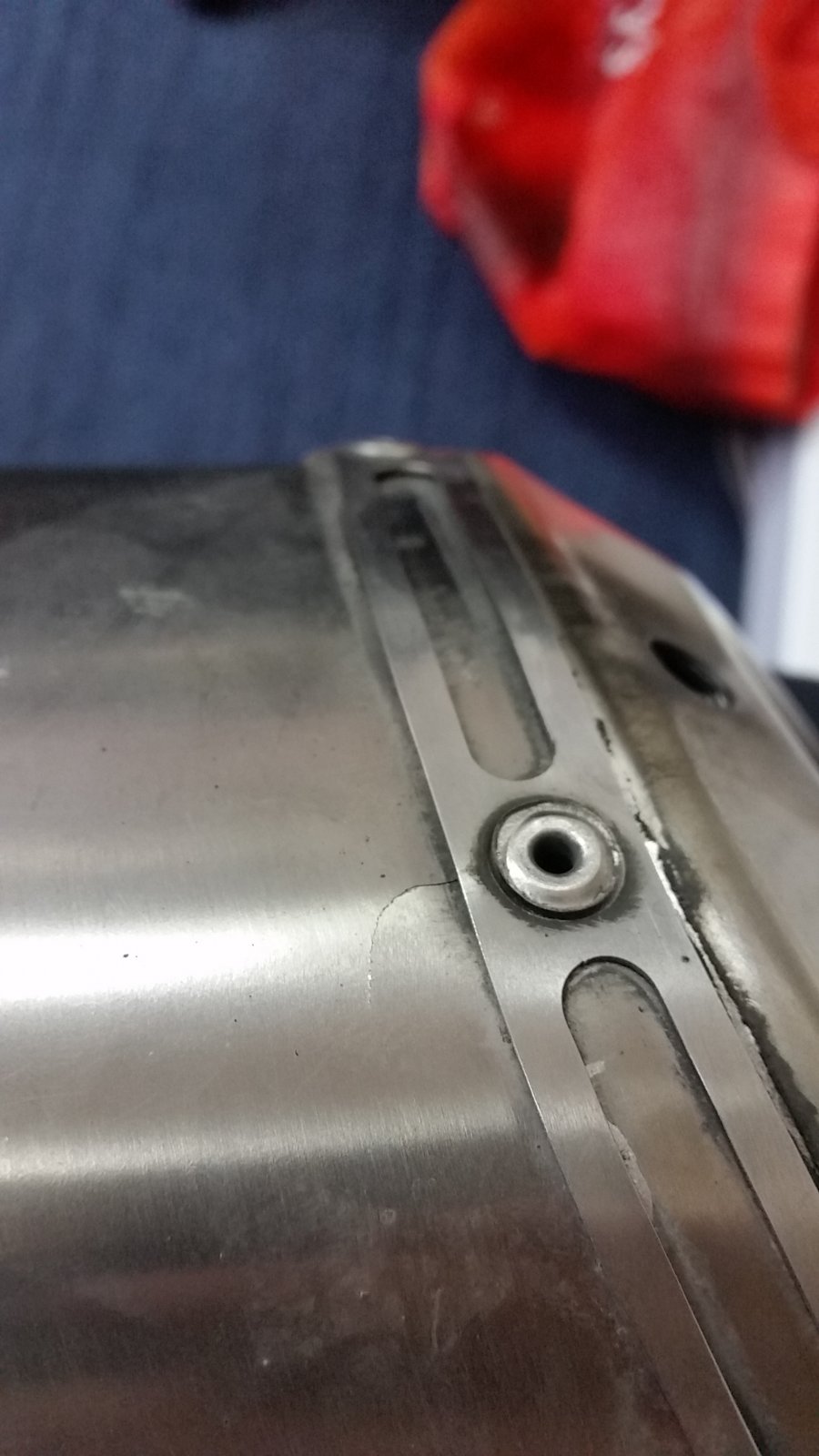

  13. The procedure for taking it apart is :
    1. Drill the rivets out from both ends ( this is the most difficult bit, they are stainless and if the exhaust is over 2 years old it will take a long time and some hard drill bits - take it easy standard speed, push a little but not much - or take it to a local engineering company to do it for you) - the rivets go all the way through so don't worry about drilling all the way through.
    2. To remove both ends - they are held with exhaust gasket and not welded - input end (the one that the bike is connected to) has the baffled welded inside. first start with removing the outer bit - that's the exit bit first. Then grab the baffle and wiggle the other end free from outside of the exhaust.
    Ok now cutting and repacking it and putting it back together...

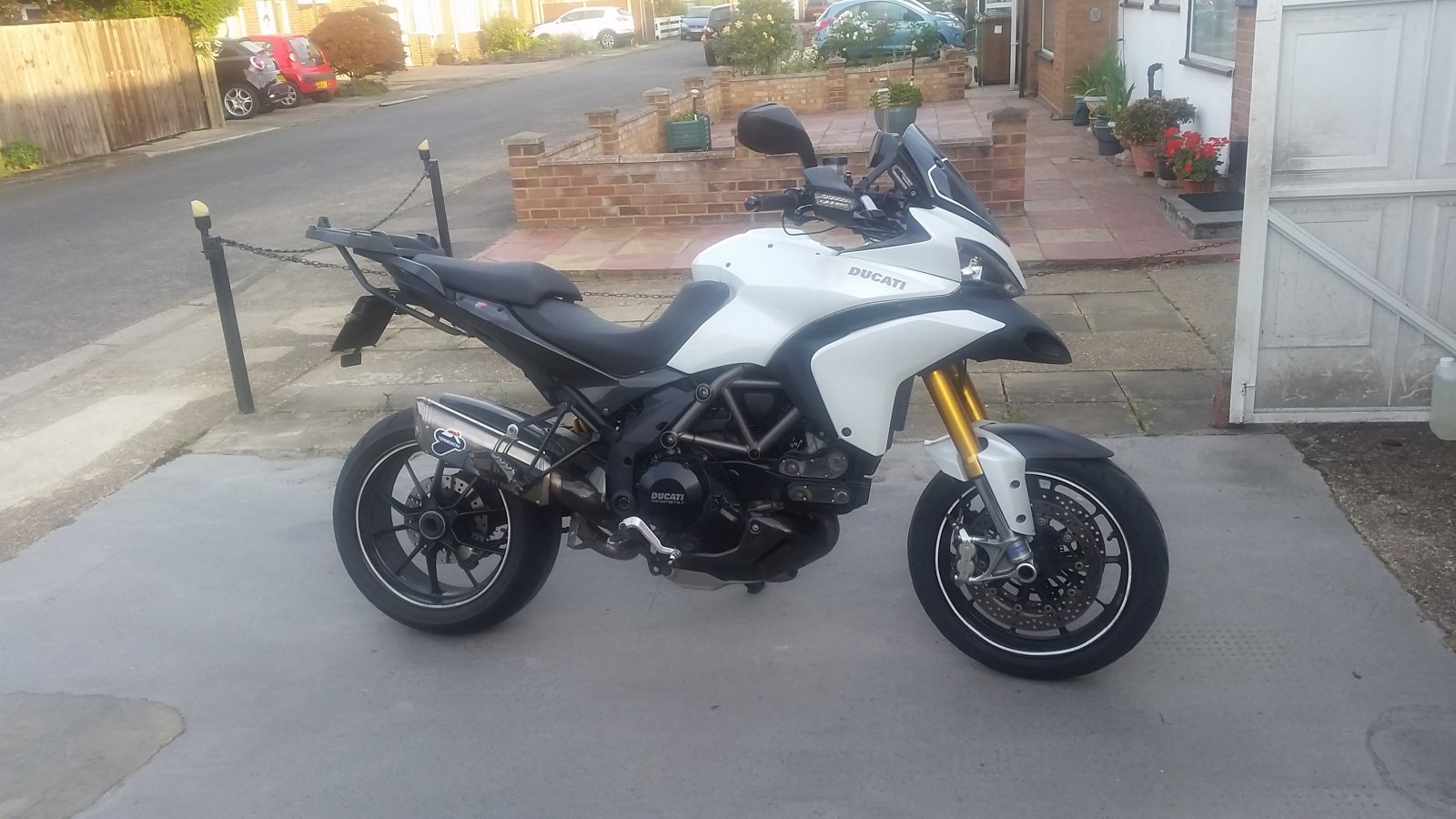

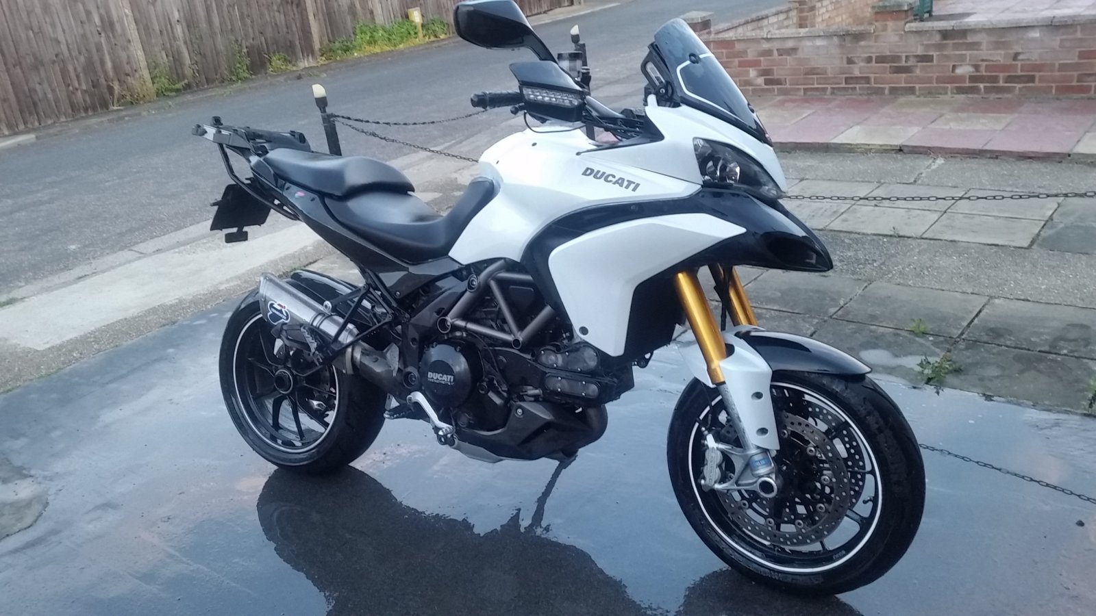

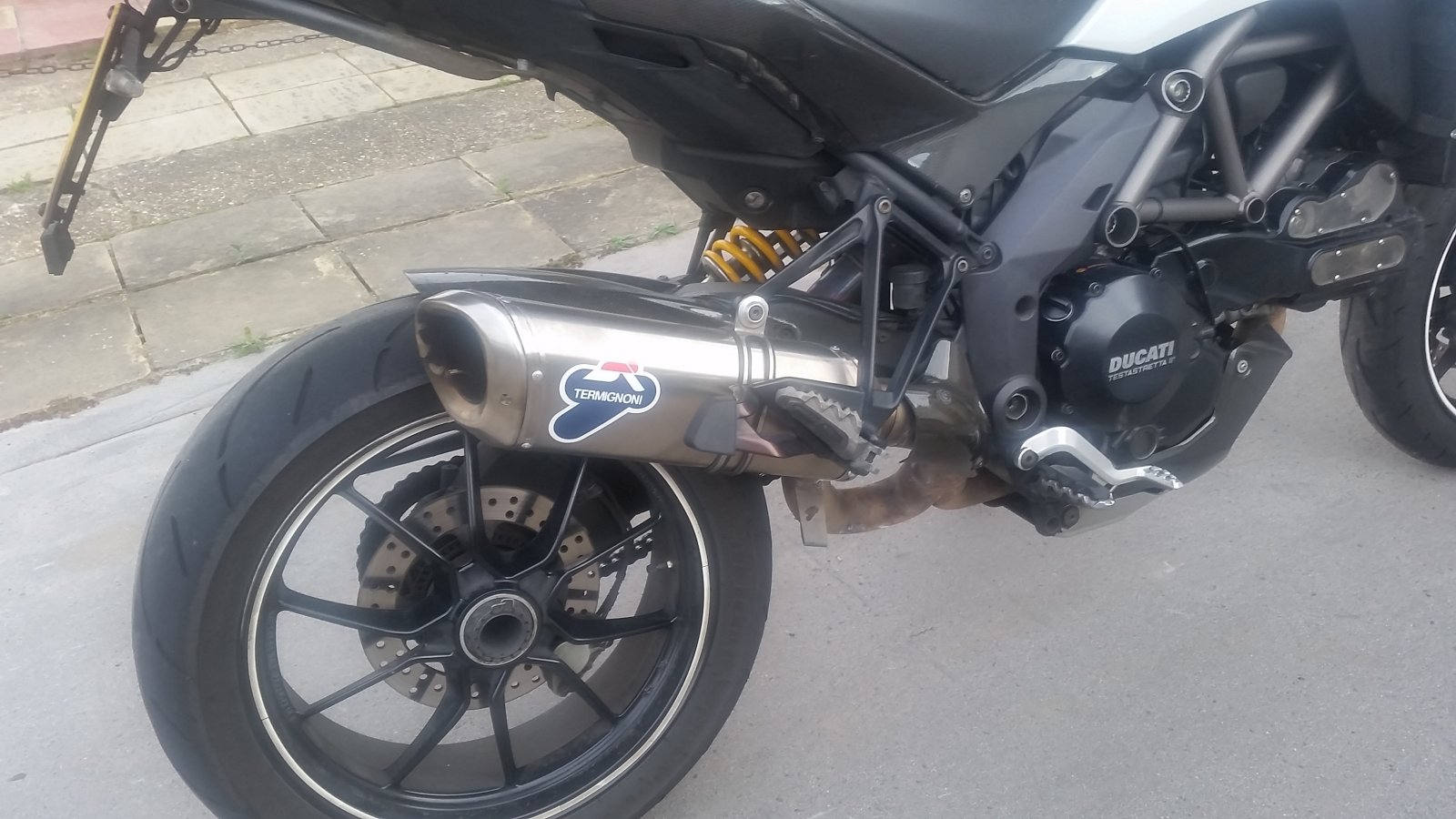

  14. all done!
  15. Looks way better, I've always thought they were to long.
  16. You sound like my wife ;)
