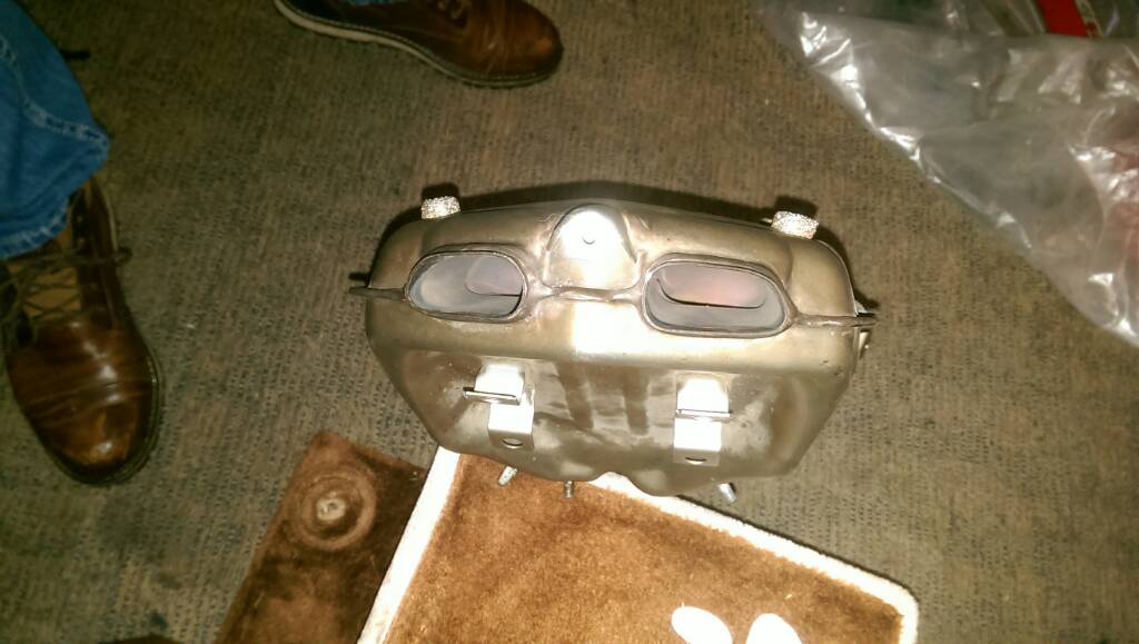

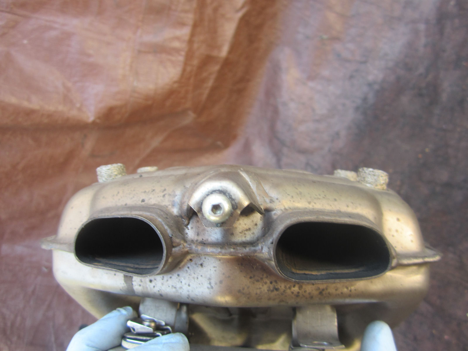

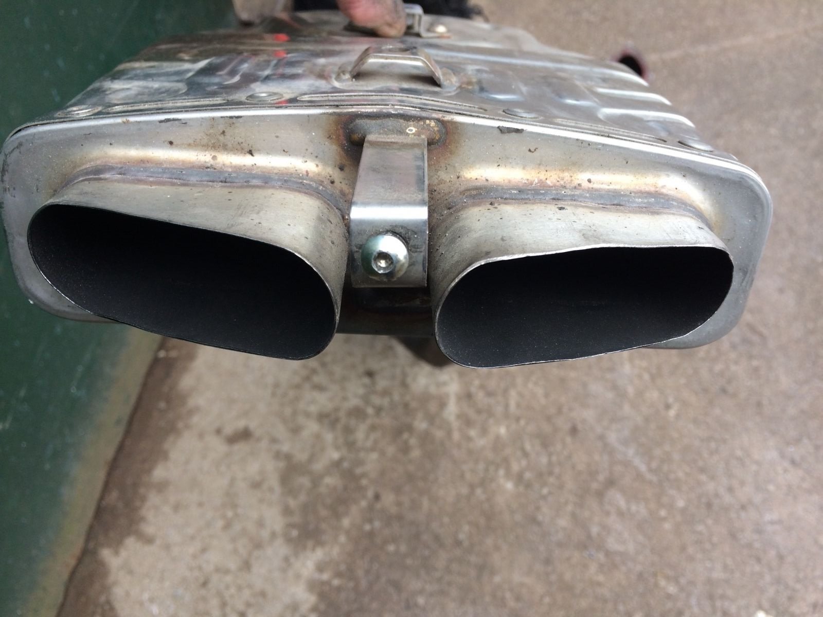

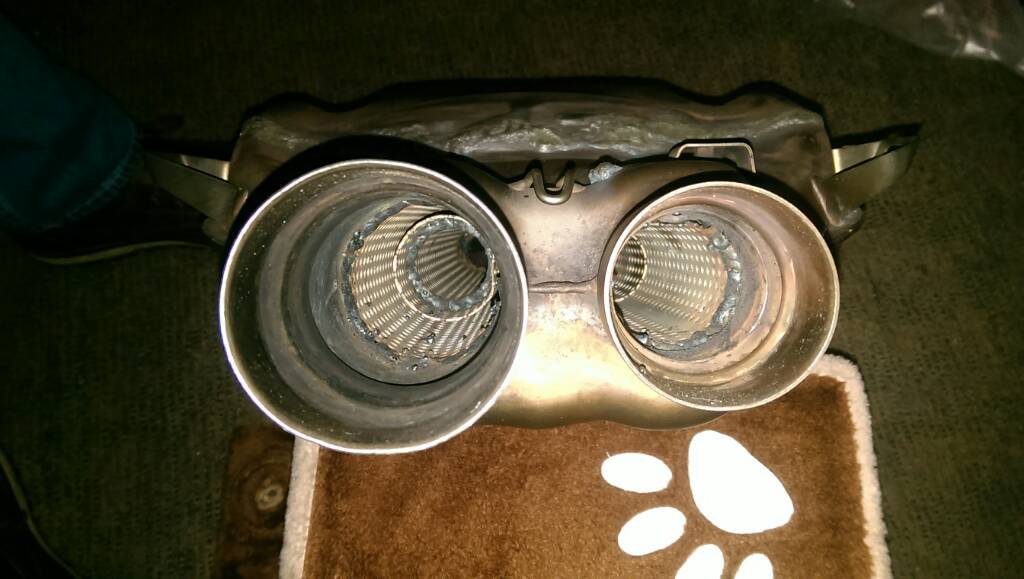

  3. As stated check for the stamped FOR RACE USE ONLY on the lower rear of the box. Also compare the two pictures, small exhaust outlet is oem, 2nd picture shows a 57mm termi-much bigger outlets s-l1600[4].jpg

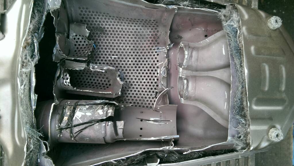

    @dorsetdesmo and a couple of others have done it too. Everyone seems to take a slightly different approach.

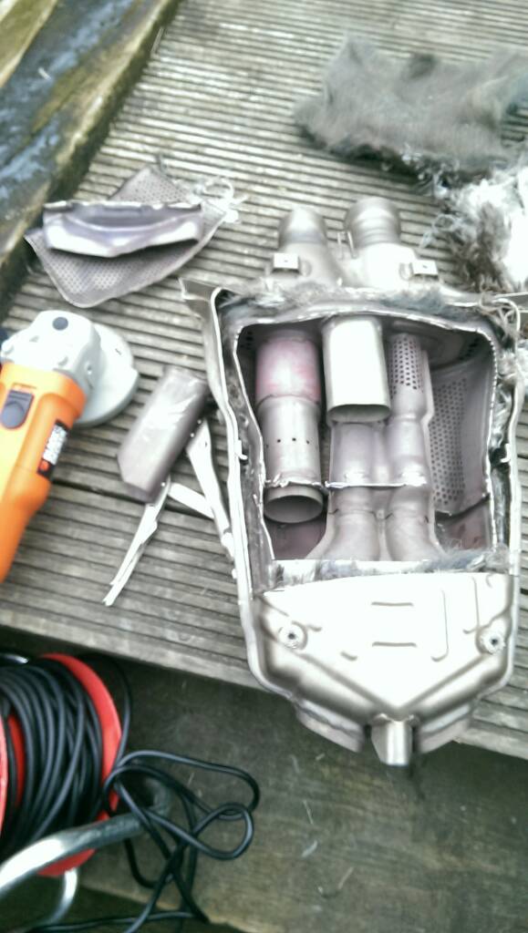

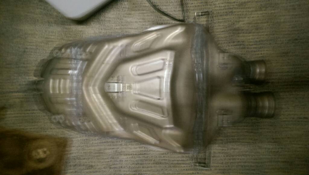

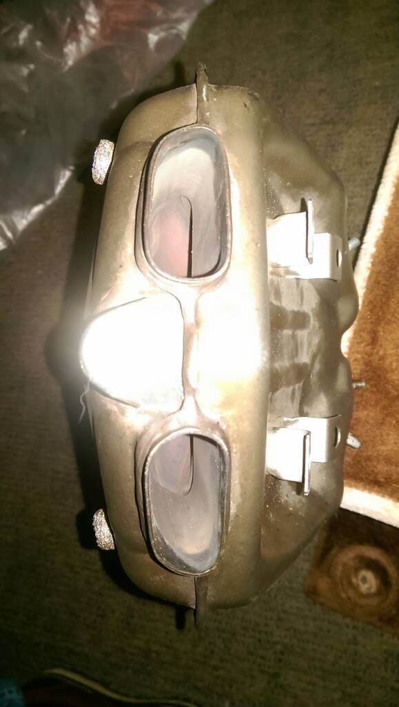

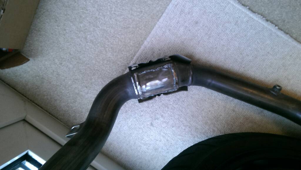

    Mine cost £100 to welder and about £50 in bits + the end can. I did mine so from the outside it looks completely OEM. Should keep the noise track friendly.
    I also got mid section decat.
    Do some googling and you should find some threads.
    [​IMG][​IMG][​IMG][​IMG][​IMG][​IMG][​IMG]
  8. So I take it u just take everything out and weld back up so basics it's a shell that's left?
  9. No. I bought 3x500mm lengths of perforated tubing in decreasing diameters. 65mm, 55mm 45mm or there abouts. This was welded together to make 2 tubes that went straight from the wide intakes to the smaller outlets. They were both wrapped in wading and then packed with more exhaust packing. Then the top welded back on.
    My way means the final exhaust part is the same as standard. Others have cut the End part out too and made larger ports.
    If you weld it back up empty it will make a right noise, certainly above 102db so not track friendly.
