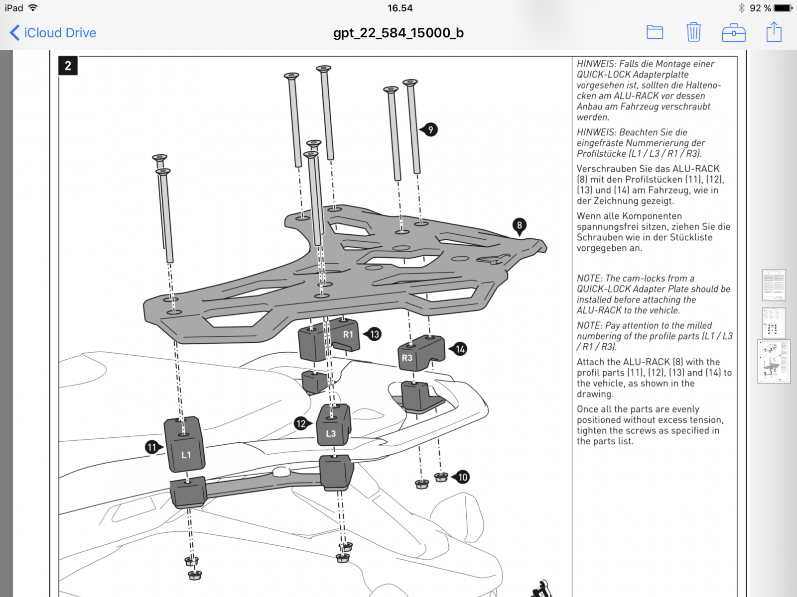

  1. White I am waiting the delevery om my 2015 MS, I am surfing the web for add-on parts. I need the possibility to (oceasionly) ride with a 58 L Givi topbox. The easy solution it to choose the original Ducaty toprack from the Urban kit, but I am concidering the solution from SW Motec, where it is possibel to change the top from Givi Monokey to standard base plate within a few seconds. I recieved these mounting instruktions from Louis in Germany, but would like to see a Real picture of the mount, does anyone here use this?
  2. Anyone got advice?
  3. A top-box rack on a Multistrada needs the pair of metal tubular struts underneath to support it. Any set up which includes the struts is good; any set up which does not have the struts (such as the arrangement in the diagram) will not be strong enough.
  4. Thank you Pete. You have a point :)

  8. I can understand that the (ugly) rails are there as "belt and braces", but having done many thousand miles at sometimes unfeasably fast speeds with a SW Motech alu rack and both monokey and monolock boxes I can report no problems. At times there has been a fair weight in them and there has been no deflection or subframe problems. Plus you can remove the rack in about five seconds, using a coin if you have forgotten your stubby flat head screwdriver!

  15. I have the Givi Trekker 2 helmet top-box on the SW plate, without the under spars and it has held up ok for 15k plus miles, although the plate did bend ever so slightly from wind pressure and speed?
