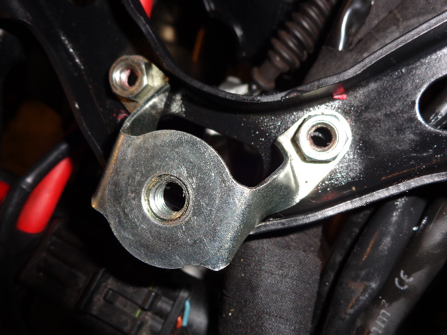

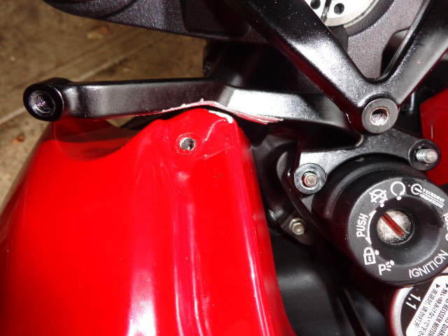

  1. Replaced the fuel filter today and I'm having real trouble getting the tank back on. When I took it off the steering damper arm had been fouling on the front of the tank and worn a flat spot as had the back if the ignition switch bracket.
    On refitting, even when pushed as far forward as possible, the main bolt at the back of the tank under the seat doesn't line up with the hole in the bracket. Its about half the hole out. There's no way I can force it. I loosened the ignition switch bracket and adjusted its position slightly which bought a bit of space and now the tank is so far forward that the steering damper arm won't fit on at all yet still its impossible to get the bolt to line up at the back of the tank.
    Is this the dreaded tank swelling issue? I thought that was only a problem in the States where they have a high ethanol content in petrol. There is no deformation of the tank. The fuel pump/filter unit went back in perfectly, the filler cap fits perfectly and there are no leaks or difficulties with the fuel lines. Though I did notice the other day that the left hand handlebar switch block now touches the tank on full lock which it never used to..
    Otherwise I'm beginning to wonder if the bracket on the subframe which the bolt screws into is the wrong one. It doesn't look like the one on the fiche:
    If it is the right bracket the only solution I can think of is to chisel/grind off the captive 8 mm nut and elongate the hole.

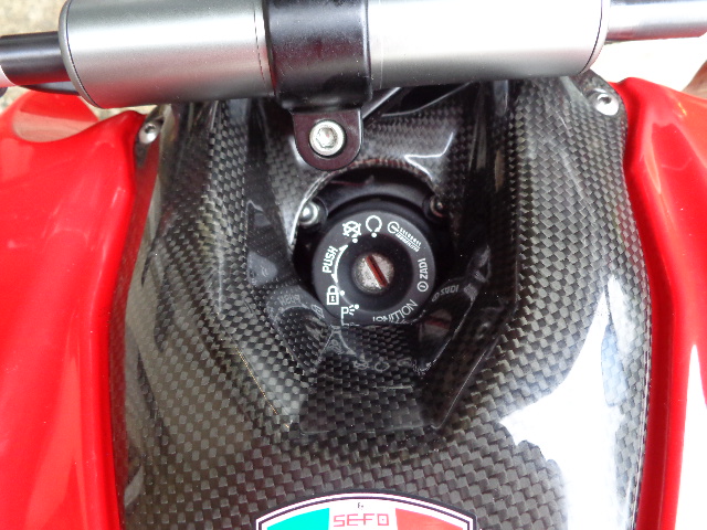

  7. The tank is definitely swollen - well lengthened anyway. Its not distended but its grown grown in length by about 5 mm. I got it back on but I had to grind down the steering damper bracket arm, adjust the position of the radiator filler cap and drill out and elongate the bolt holes in the carbon key surround. You can see how it doesn't line up with the key barrel any more.
    I'm going to chisel the captive nut off the back of the rear bolt frame bracket and elongate the hole then reattach the nut, but then the seat will be rubbing on the tank and taking the paint off. I'm having the seat recovered anyway because its so slippery against my track leathers, so 5 mm can be trimmed off the foam. The tank is now marked so as I'm keeping the bike as an occasional sunny day scratcher and hopefully an investment eventually, I think its a case of buy a replacement tank - new or unswollen used - and keep it dry on the shelf in case I want to sell.
    Be warned SF owners: these tanks will swell. Use only high octane fuel and keep your fingers crossed. If the front edge of the seat is rubbing off the tank paint, that's your early warning sign.

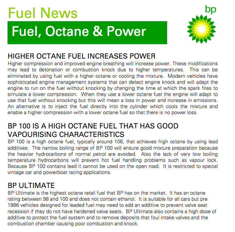

  10. For reference, most of the high octane fuels (Shell V Power, Total Exellium) contain ethanol. BP Ultimate is ethanol free, so that's what I use. If I'm out and about, I'll put anything in if I know I'm going to go through the tank, but if I know I'm going to leave the bike for a period of time, it's BP only.
    3rd paragraph.

    Useful article here from the TR Triumph car owners club. TR Register Feckin EU again responsible for this....
    They say BP Ultimate is ethanol free except in the south west of England.....:Rage:
    Checked out the Total list and it looks like there's one filling station about 15 miles from me. Maybe I should stock up on Jerry cans..
    Its not easy to drain the tank on the SF either. On the KTMs you just pull the lines off and open the taps. With the Ducati, as usual, its not that simple unless I'm missing something..
  12. Well, BP state the Ultime is ethanol free. I don't see why the SW of England would be any different.
