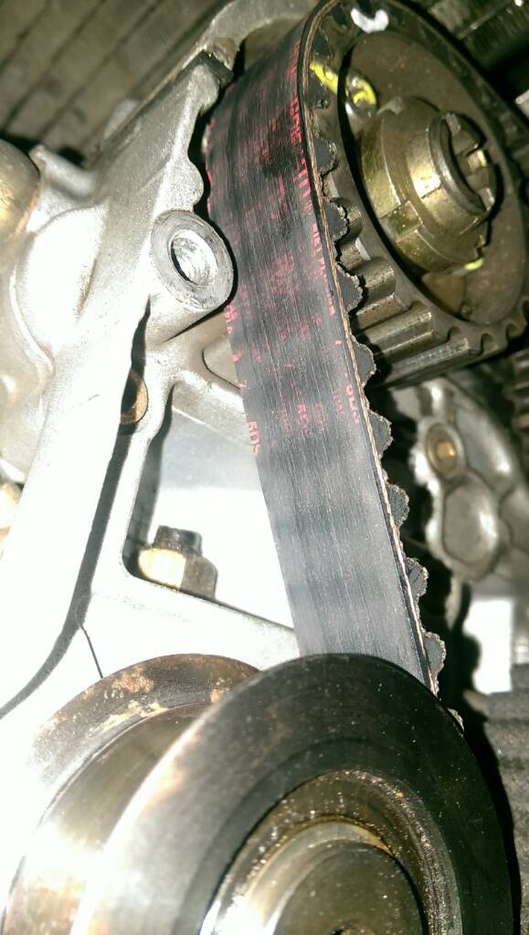

  6. Belts are different, they don't have the pen marks on I used when I changed.

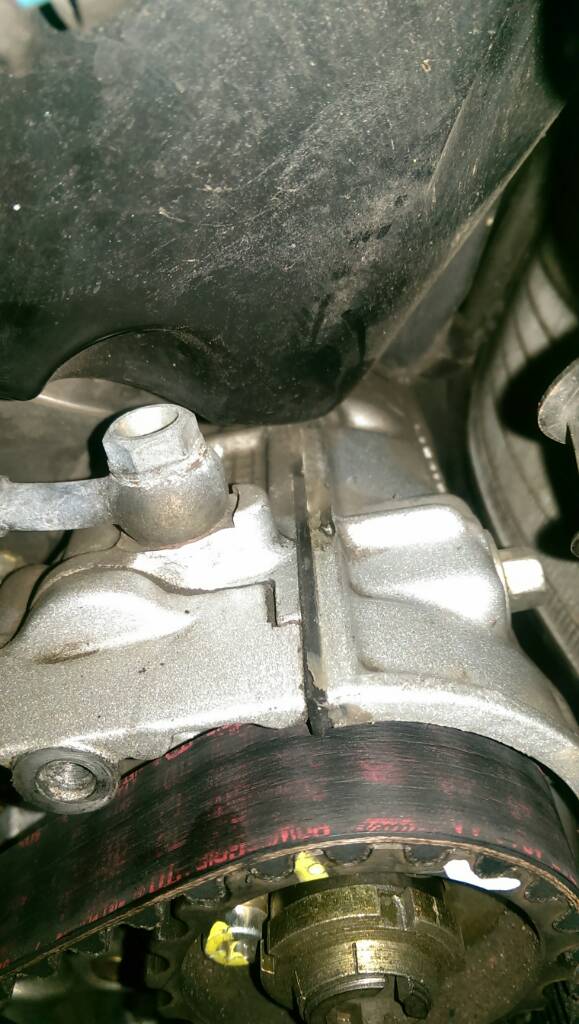

    I can't make out the righting, should it have IMAG0844.jpg rubbed off after 100mls? Do they look like Ducati belts?
    Does this horizontal head look like it's been off?
  7. Called bike shop, they swear belts are brand new from local Ducati shop.
    Say mix up in shop floor and they did the service then the office said it needed valves so valves were done after.
    Promise that valves were checked/adjusted.
    It's me, Geoff @Baines or @nelly from now on!
  8. I've got old stock new belts that were manufactured in 2001 that have done 600 track miles that still look new with all the writing intact. They did stuff you didn't ask for because of a mix up in the office ? I'm a pessimistic cynic on a good day so you can guess that I'd have no confidence in what I'd been told. Andy
  9. The rubber feels new(ish) not dry or brittle. Maybe i'm just paranoid.
    All they needed to do was what I asked in the first place and give me a valve sheet and I'd be happy.
  10. I've got a set of used 916 belts with 2 years & 5-6k miles of use on them hanging in my workshop that have more writing on than those...
  11. Perhaps double check the idler bearings are free, that is the only thing I can think if they are indeed new?
  12. Yep, bearings rotate by hand.

    To attempt to answer the question about belt tension affecting starting, I presume if the belts were slack enough, it could affect valve timing but they'd have to be dangerously slack. It is perfectly possible to rotate the adjustable pulley the wrong way, which would prevent the belts from ever being tensioned enough. It would also put the belt runs dangerously close.
    What makes you suspect slack belts CR?
  16. Those belts look worryingly scuffed to me. How close are the opposing belt runs where they go round the adjuster/tensioning pulleys?? Pic ??
  17. Belts seemed loose looking at then yesterday but english was not at TDC, so maybe that needs checking.
    Just trying to figure out what the hell my garage has done.
