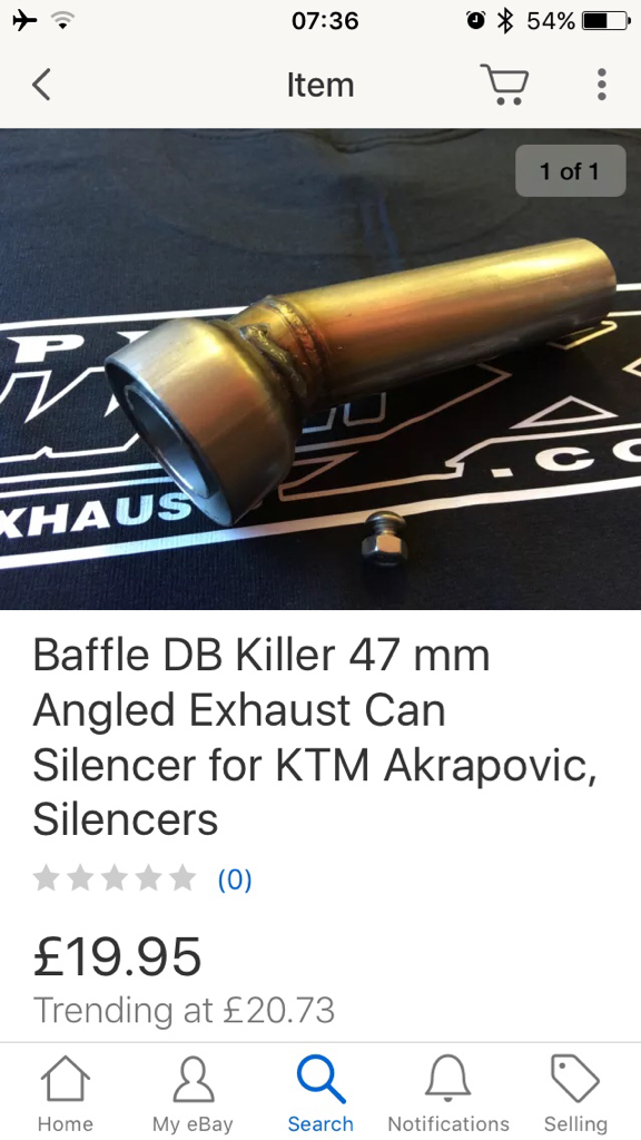

    Check out eBay there are some for sale for other bikes but could fit if same diameter
  3. i geuss the exit at the end is about 1.5inches?
    35-40mm
    and erm, slash cut? not sure in all honesty,
    acropovic seem to only do 1exhaust for the 848evo
  4. Measure the actual pipe back from the end can that will give you the diameter
    My bike here albeit termis have slash cut ends in the picture below which means if you have the same style you will need a slightly angled baffle
  5. angled? no the pipe is straight, but the exit is cut at an angle [emoji23][emoji23][emoji23][emoji23]
    guess theyre straight/standard
    ill take a look, bit nervous to just order parts for a different bike to fit

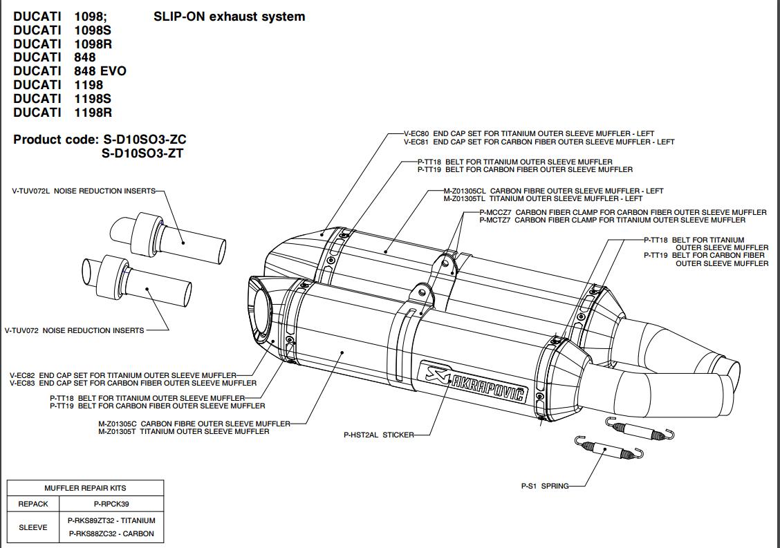

  10. Not that many options or models with Akras, expect they are these
  11. that would be them yes.
