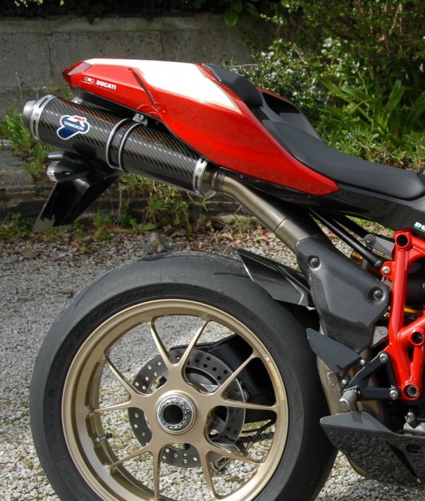

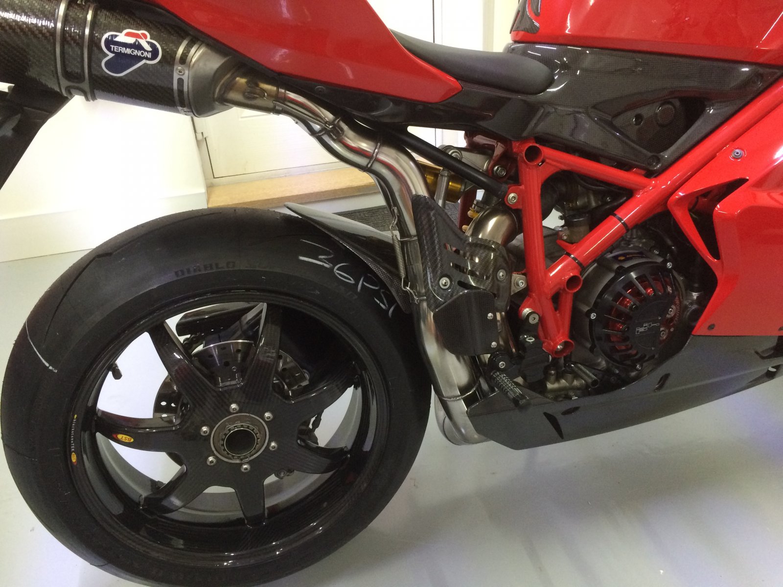

  3. The easiest way to tell is that the full 72mm system has a kink just before the end cans. The slip ons have a straight section. This is how I've always quickly judged them. Pics below to explain.
    Full system
    Slip On
