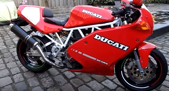

  1. My bike's getting in a right state. Surface corrosion on the frame, tatty engine, bolloxed fork exterior where the cable has rubbed. Fairings with bits of filler. Signs of corrosion on the wheels. Rev counter that's never worked due to worm issues. Rattling and jerking all over the shop. But I can't part with it.
    How much would it cost to turn it into this?
  2. Give me a couple of months and £750 for parts and materials.

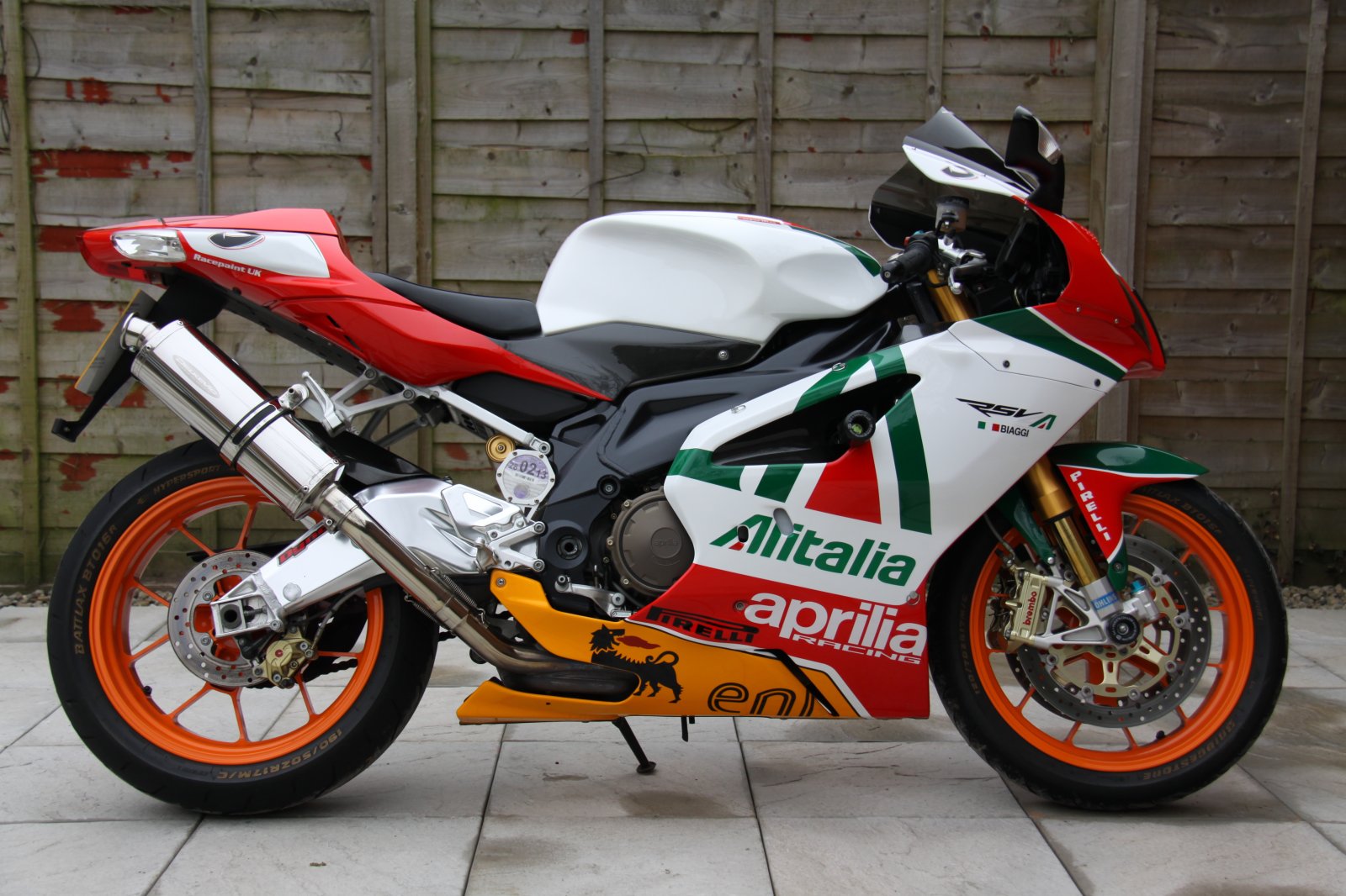

  8. i'm going Aprilia this year, I'm afraid. A late RSV with Ohlins front and rear, no more engine paint flaking off.
  9. How much for a couple of months labour?
