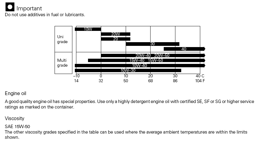

  5. I used an alternative oil brand and weight. When my engine got assessed (blew up), they deemed my oil was still within spec (as per the temperature ratings in the Ducati handbook) and fully paid out (not Ducati or dealer but finance company). Oil was not deemed the cause and it had been changed recently (by me with receipts as proof). Basically goes to show you can use any brand so long as the weight fits the user guide section and the temps you are riding in.
  6. For clarification...
